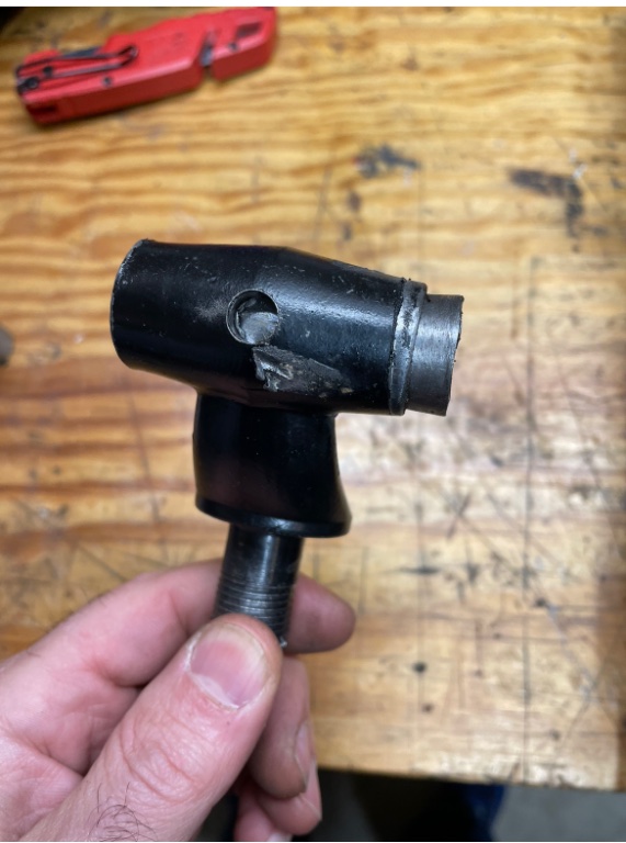

I’m refurbishing the rear axle. All going well until I tried to remove the rear spring perch bushing. They wouldn’t budge. I wound up buying new perches but the new bushings won’t go in. Wound up mushrooming about 3/4 of the way in and now that one is jammed in the new perch. Any advice?

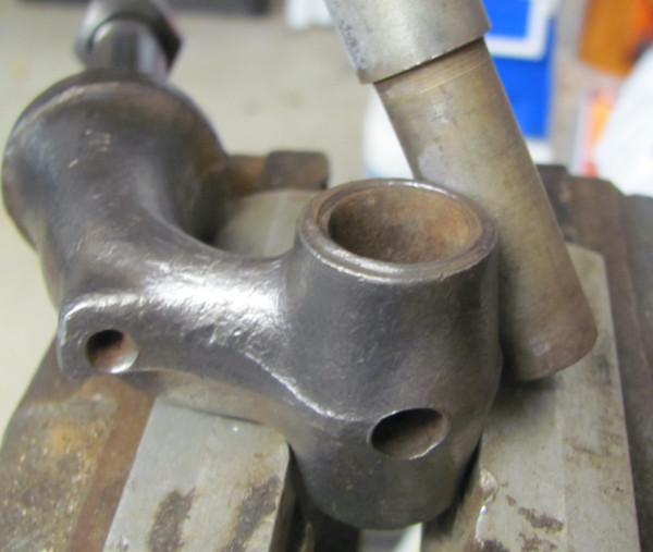

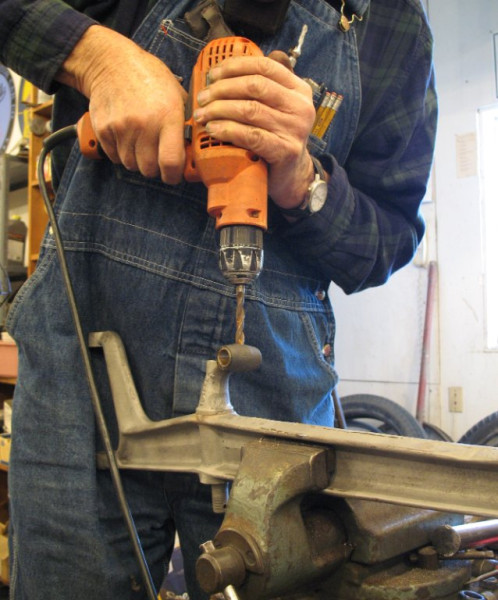

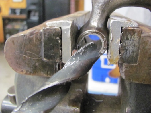

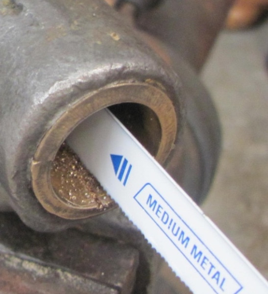

As others posted, take a hacksaw blade and insert it into the busted bushing, cut a groove and it will press out, a proper bushing driver helps. Once out, clean the bore of the perch.
Then radius one end slightly, add some oil for lube, and use the bushing driver, or if you have a big vise, with soft jaws, push the new bushing in.
Then use a reamer or drill to correct size to fit the shackle for a smooth slip fit.

Thanks all! Really odd sizes in new parts. Bushings are too big for the new perch. Will need to hone before trying again. I’d rather do it myself but I’m tempted to find a machine shop. I’ll try and get one out with a hacksaw and hone the inside of the perch before trying again. I have the bushing tool from Lang’s but no luck with it.

Dan's photo with the hacksaw blade shows a non standard bronze bushing. These are so much better than the rolled steel bushings the vendors sell. In Australia they are available at good bearing shops. Being machined, they are of a much more consistent size, and they are easily reamed to suit the shackle once fitted.
Hope this helps.

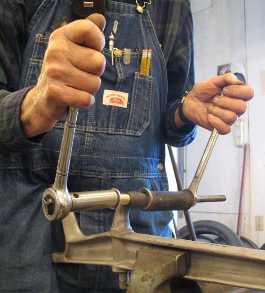

Another way to squeeze in bushings is with a piece of all thread.

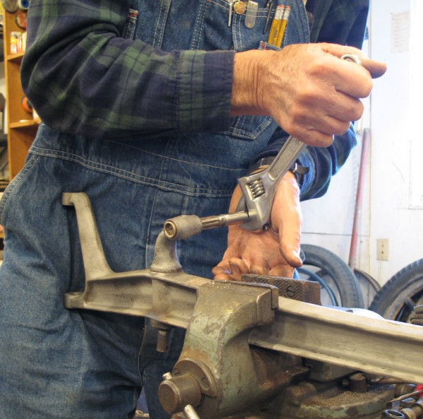

I don't remember if all of them needed to be reamed, but this one did.

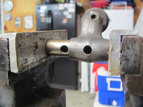

For a later car with flip top oilers, don't forget to drill the oil hole.
