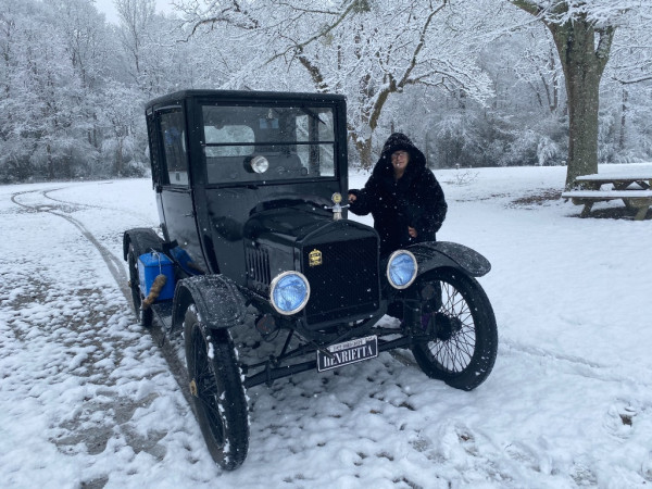

I confess up front, I can’t stand be cold…. That’s what is good about Mississippi. However, last winter we had three ice/snow storms that lasted for a week and shut everything down. On the first day, I did take the coupe out to put tracks in the snow. It was in the teens temp wise when the photo was made. The coupe has a sheet metal heater shroud on the exh manifold and it was comfortable! I know, all you poor guys way up North are not impressed!
