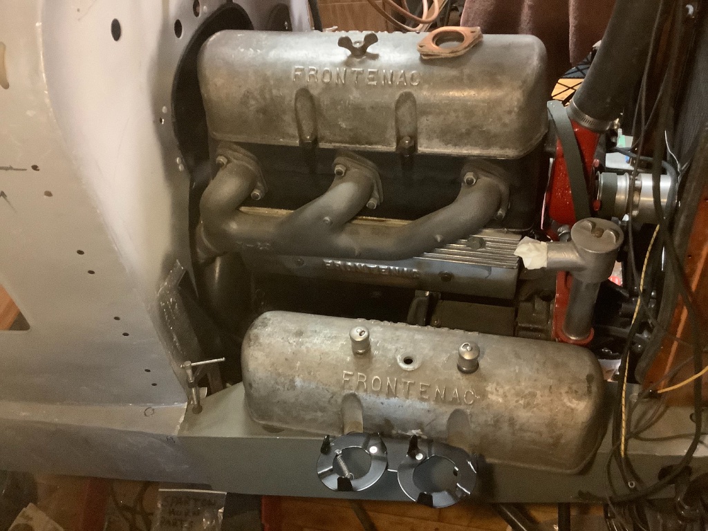

I have a Frontenac overhead valve conversion on a 26/227 T engine which will go into my speedster project. I noticed in a period ad illustration for the RAJO overhead valve conversion that the oiling pad is secured to the top of the valve cover and there are 2 oiling ports with cups drilled into the top of the cover to lubricate the pad.
My Frontenac valve cover has the oiling pad just sitting on top of the rocker assembly and there are no holes drilled in the valve cover for lubrication purposes. Is this correct, or should it be modified to resemble the RAJO style?
Thanks for any info, Gene

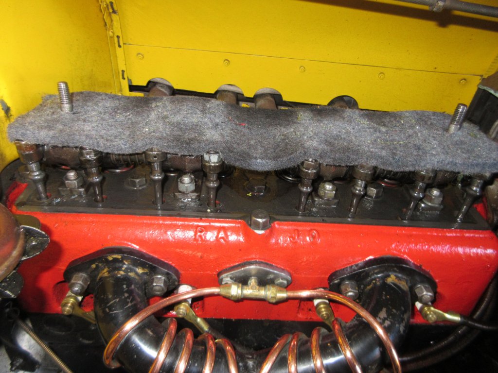

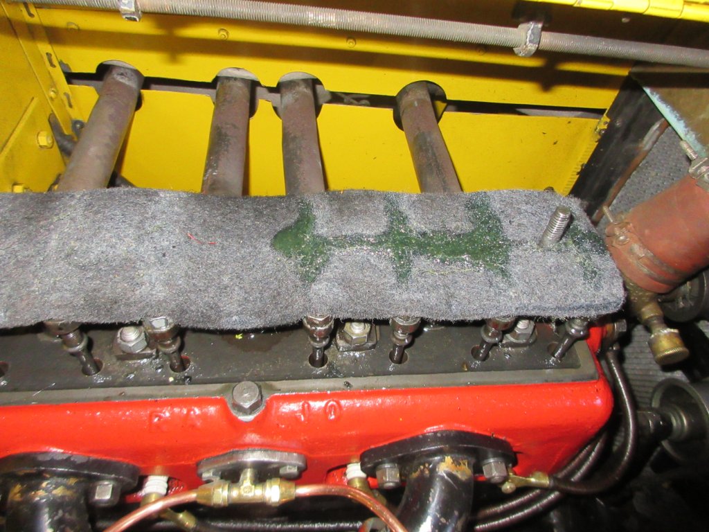

Maybe this will help a little although it's not a Fronty but it's basically the same. I'll add a couple of pictures. In the last picture you can see the oil stream on the front set of rockers. Been running this car for 53 years with almost no rocker problems (had to repair the rear rocker 30 or so years ago as it was loose on the shaft). The felt pad just lay's on top of the rocker assy. I oil the pad and rockers daily before I begin a drive, short or long distance. According to the old timers (when I got started in the hobby there was plenty of them around to give advice) they oiled them once a week or so! But......they could go to the supply source and get new parts. We can't! So I remove the cover, lift the pad and oil both ends of each rocker arm and the center where it rides on the shaft. Then I lay the pad back down and do the same thing to the top of the pad. I'm good for the day. Morning ritual on a long distance trip......il the rockers.

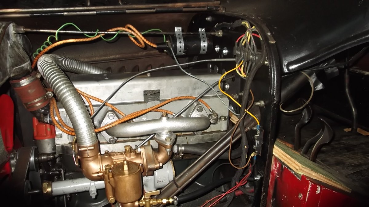

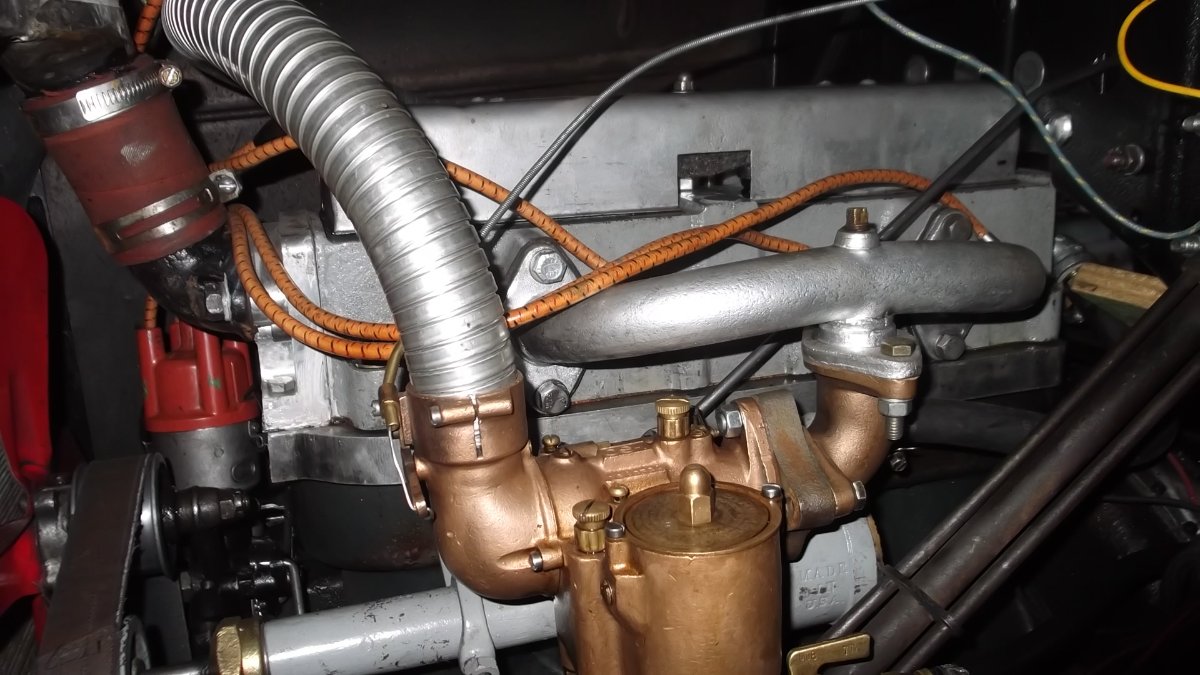

Quite the "unique" heated manifold system Ed !

Does the job Steve. Had ice on that manifold on a 104 degree summer day. Ice no more!

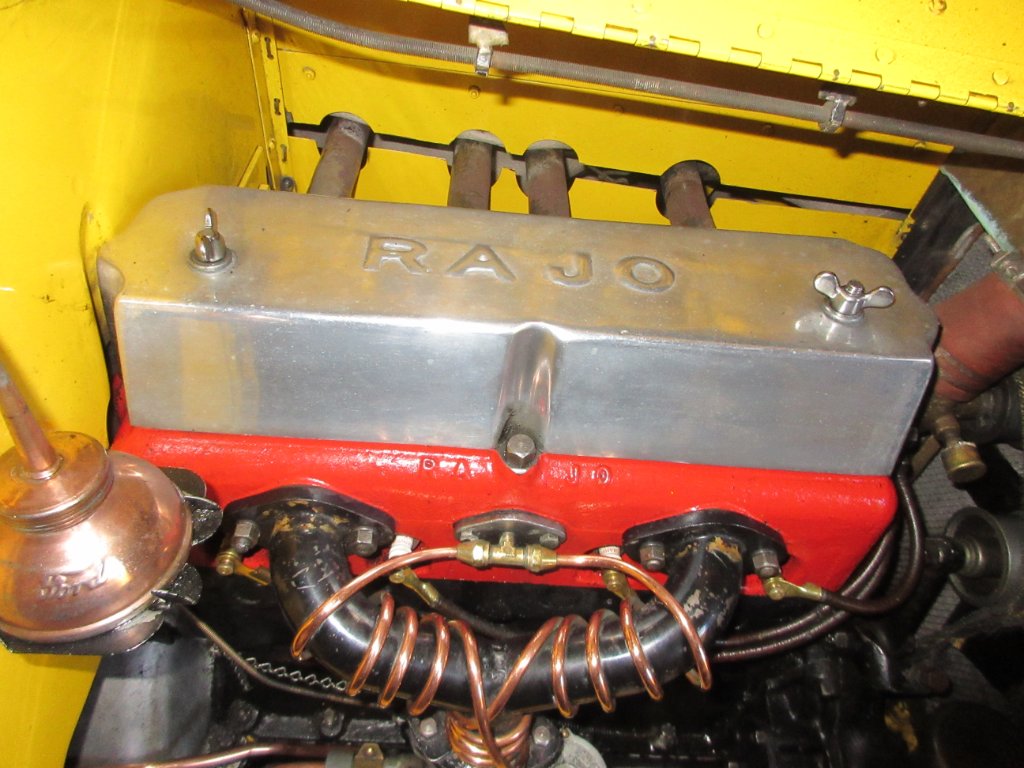

My apologies for the thread drift but after seeing Ed's intake air heat, I wanted to show mine. Winfields up here in the Pacific NW don't appreciate the moist air !

A bit late with this as I just now read this thread in detail. Probably "over-thinking" this, but it would seem like Ed Archers method of intake manifold heating would provide a sort of dual function as "heat transfer" works both ways; while the obvious intended function is to heat the intake manifold, it would seem like the cold manifold would also have a cooling effect on the coolant within the copper tubing! ....?....harold
