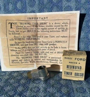

I have seen two instances on the Internet of a aftermarket timer brush similar to the New Day being used in a Roller Timer cover. Has anyone ever tried one of these successfully?
