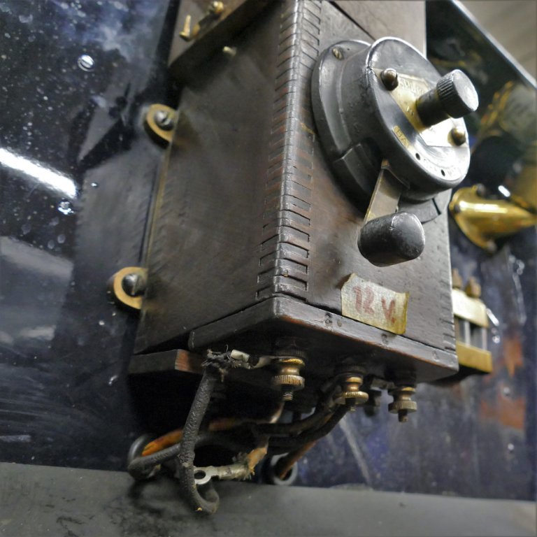

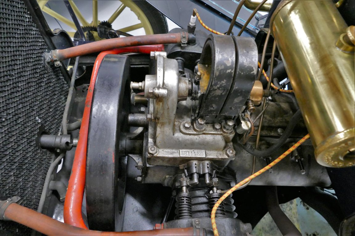

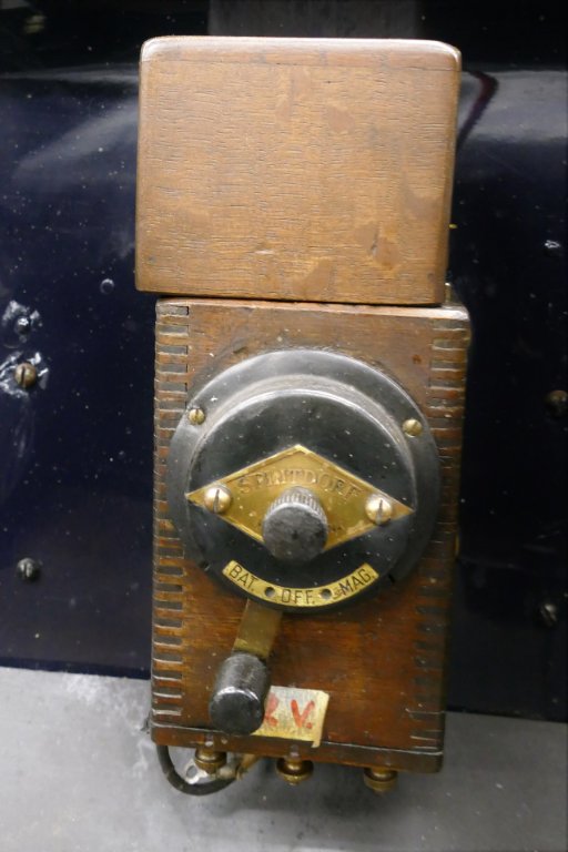

I am looking for photos, plans and an explication of the working and the set up of the ignition for a 1910 two cylinders Maxwell car.

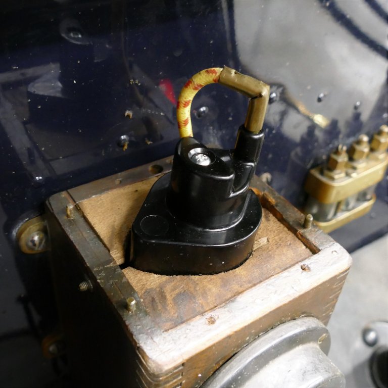

The owner bought the car with a Citroën 2CV coil in the coilbox. He like to get it original again but we don't know how it can be done.
Andre

The Maxwell ignition is a "wasted spark" system, the coil fires both plugs every engine revolution, but only one of the two cylinders is on its firing stroke at a time.

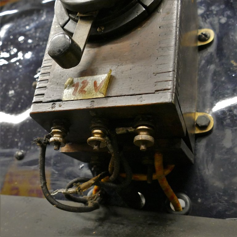

From the pictures, it looks like you have the correct Splitdorf Model G low tension magneto and its associated coil box to return the ignition system to original. The car would have had four large dry cells for starting, then the user switched over to the magneto for running.
If the coil box is bad, or you just want it refurbished to work and look like new, R.V. Anderson does great work. I see that the box has some tape on it marked "12V", so perhaps someone has already fitted it with a modern 12V coil and condenser. The original system would have been 6V.
Yes, the Snyder's page that you found does show new parts for refurbishing the coil box.

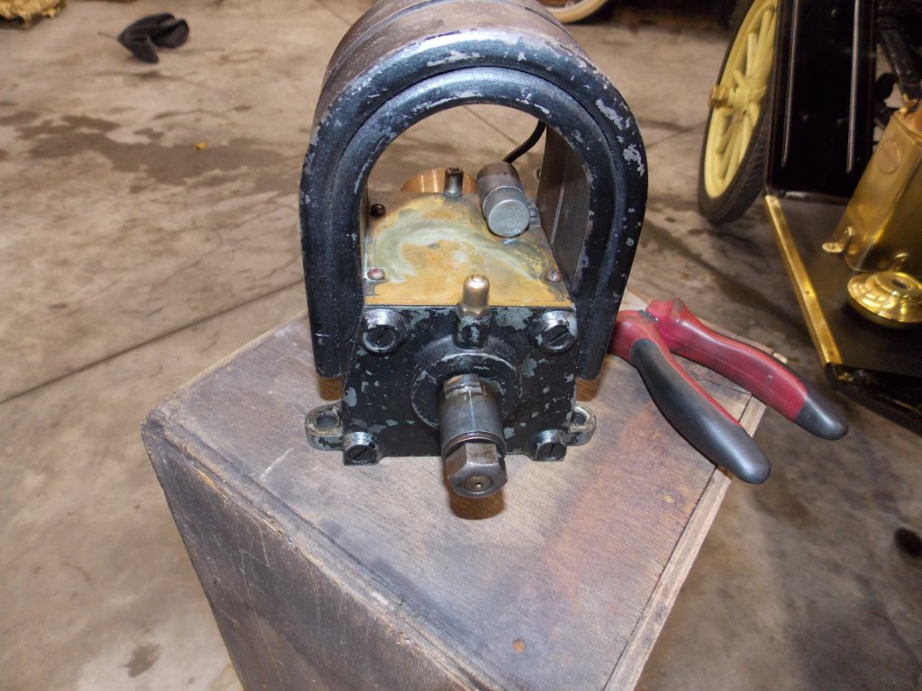

Merle Simonsma the Maxwell guru told me a Splitdorf Model H magneto is correct for my ‘10 AA. So I had 2 rebuilt. 1 installed and 1 for sale.

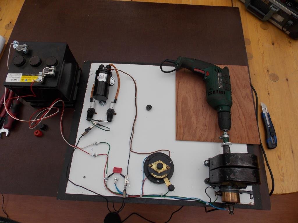

Thank you all,

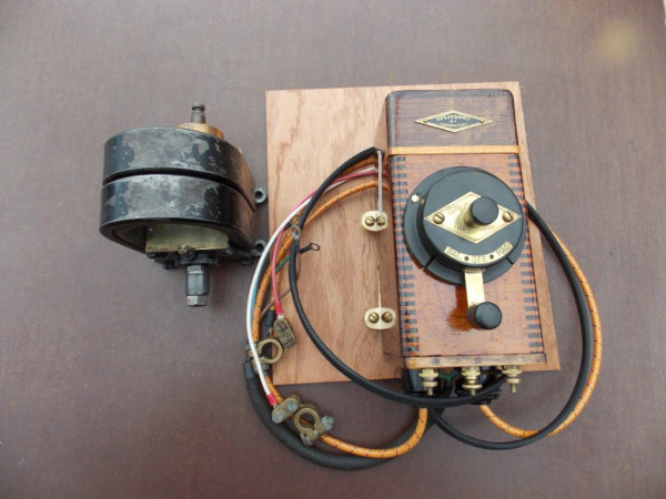

Specialy for Frank and David from down under Australia.
They walk me through the ignition with help and advice.

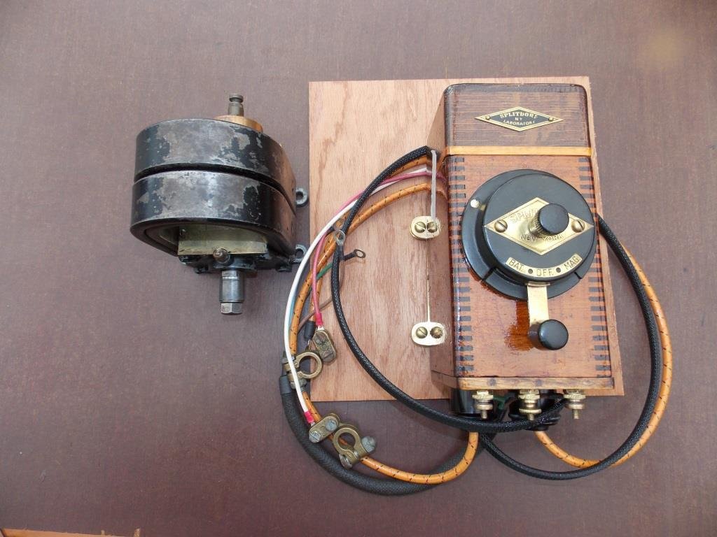

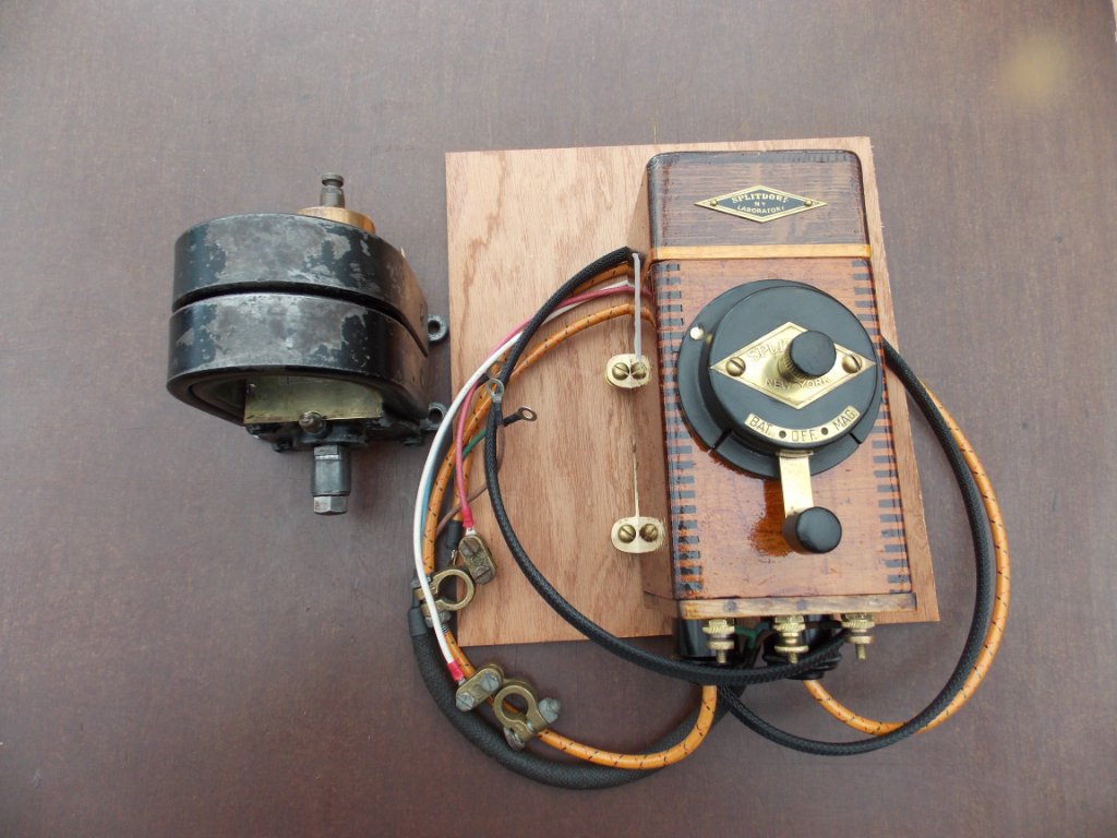

I had the magneto rebuild and rebuild the coil box and wiring myself.
Ignition is sparking again, on the battery and magneto switch position, on the test stand I made for it.
Next step will be: Make the engine running again.
Here is what I had and what I made out of it.
Andre
Belgium

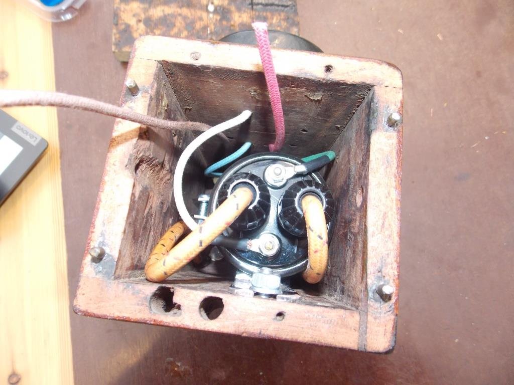

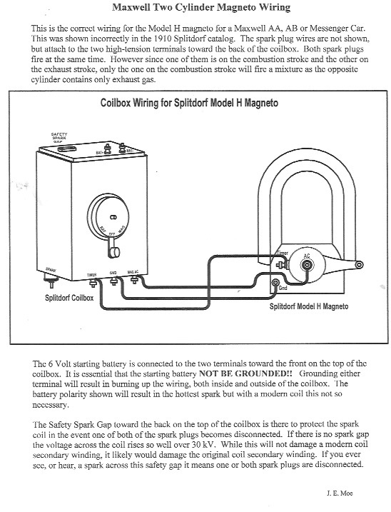

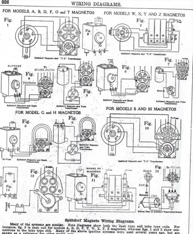

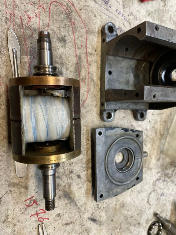

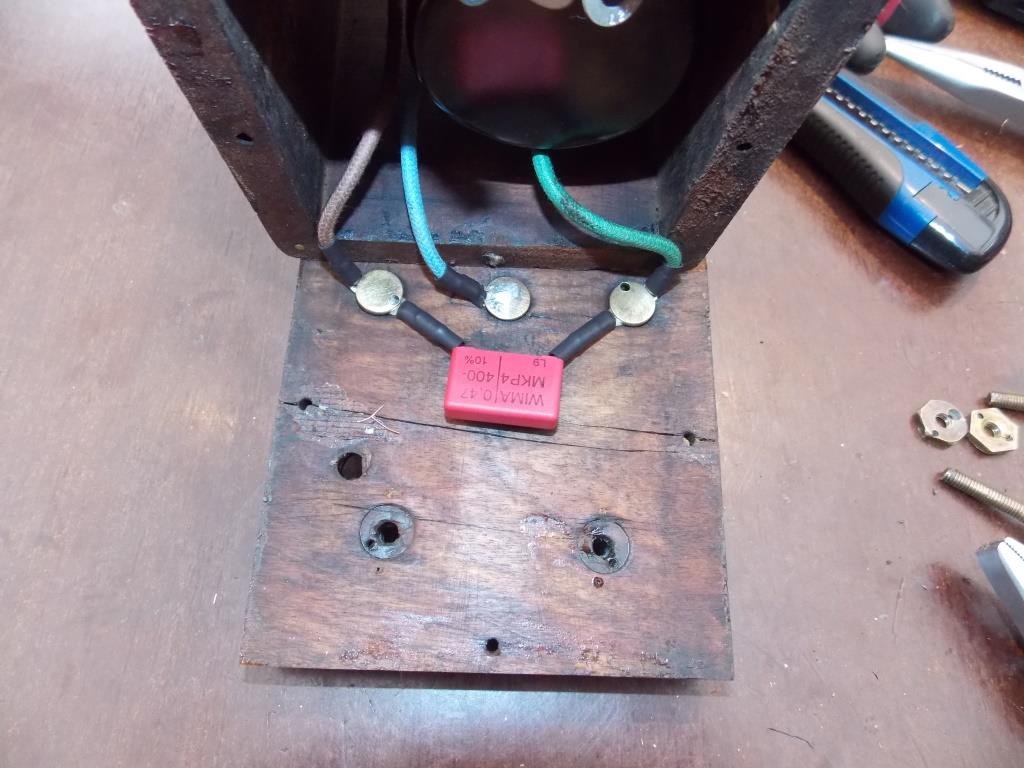

Here a few more photos,
In the drawing it is the G and H magneto model.
On the magneto there was the armature rewind, the magnet charged and a good clean out.
The coilbox have a new 6V Harley-Davidson double coil, a model T condensor, a new cover and totaly new wiring inside.
The outside wiring was done with old looking wire, red, white, brown, blue, and green.
Andre
Belgium
