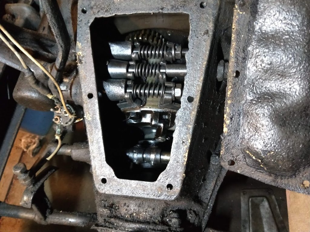

Thanks for the suggestions. Here is a pic of the tranny. I haven't taken anything apart. Does anything look suspicious, like drums are NG or linings are worn out completely (I suspect)? The car drives and stops. I don't know what to do first. I only got the T to move under its own power last week. Thanks,
John
John

At a minimum, time for new bands.
While the hog's head is off, very likely will find that the pedal supports could use repairing or replacing as well as "tweeking" the pedals as necessary to bring them into alignment where they belong (after pedal supports are replaced). Along with replacing the supports, you may need to build up the pedal ramps to minimize lost motion...noting that neutral pedal DOES have a short travel forward without sideways movement, to disengage high clutch prior to band engagement.
- Posts: 4694
Re: Pedals bent forward
From what I can see in your picture, it appears to be ready to reline the bands, especially the low band. I can only see a bit of the brake and low drum, and they look OK, what I can see. Hard to check anything else from just looking at a picture.
