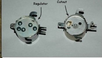

Fun Projects Voltage Regulator vs typical cutout
- Attachments
- vr id.jpg (12.55 KiB) Viewed 10528 times

The information Frank Brandi provided will help you to determine what you actually have: a reverse currewnt cutout OR Voltage Regulator.

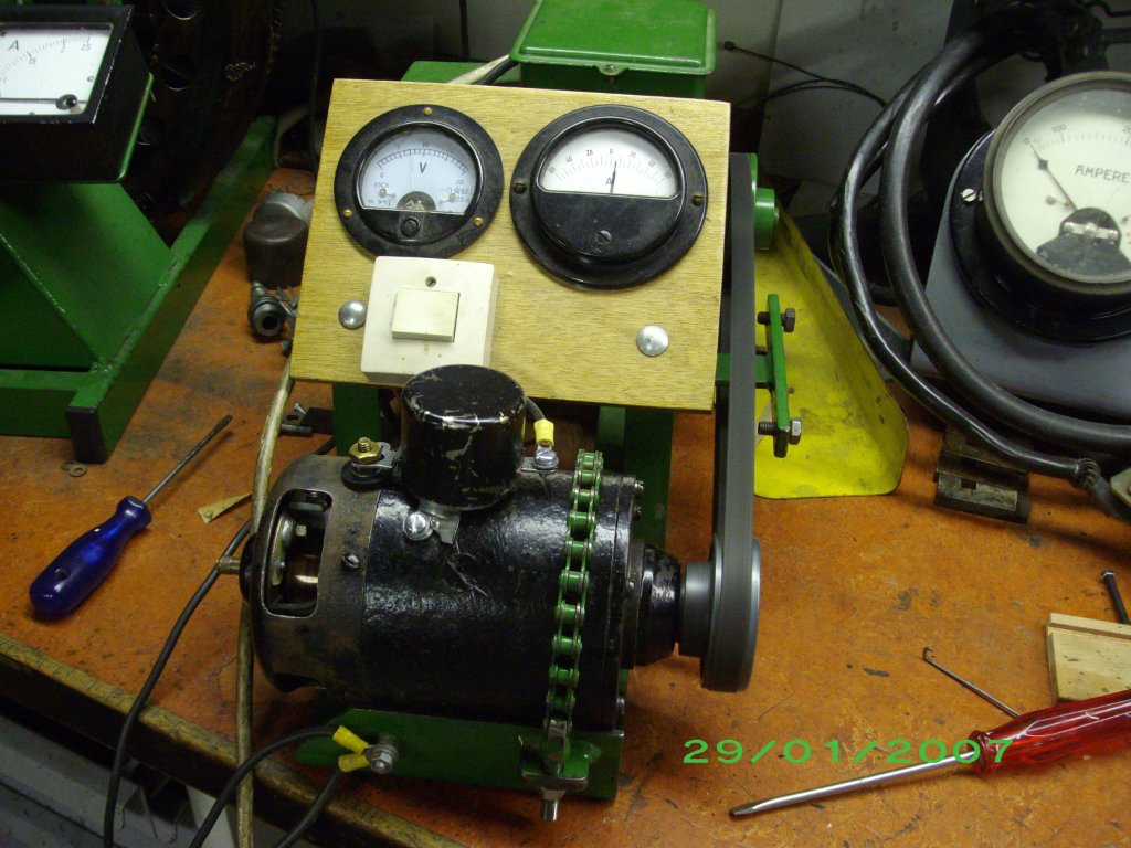

Thats why I love my alternator! Its a "daily driver" albeit a show quality restoration, but I got sick of fighting with the generator,
most of which can't even keep the headlights bright at idle. Not a problem with the alternator. Purism be damned this time!!
- Posts: 3743
- Last Name: Wrenn
Re: Generator not charging on 1925 T
I forgot to mention FWIW this is on my '25/26 "overlap" Fordor.

To tests Generators I use this .
Toon
Toon

My last and final comment, what is the difference between turning the generator on a bench device with an electric motor and turning the generator on the motor?
- Posts: 5267
A correctly made test stand. None. Both ways should have a battery that matches the final voltage to the car as part of the test station.
- Posts: 4478
No difference at all. That's how I test mine, on a bench device. The issue was with running the generator with no load applied. Doing that, either on a car, or on a test stand, can/will injure the generator.
FWIW, I had an alligator clip jump off the generator terminal while running on a test stand, (i.e. no load applied). The load on the test stand motor was so great that it nearly stalled the unit. Goes to show the energy being generated internal to the generator that it should stall out a 1/4hp motor.
