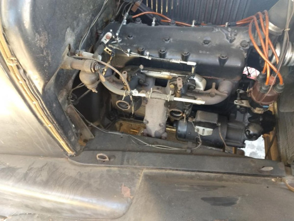

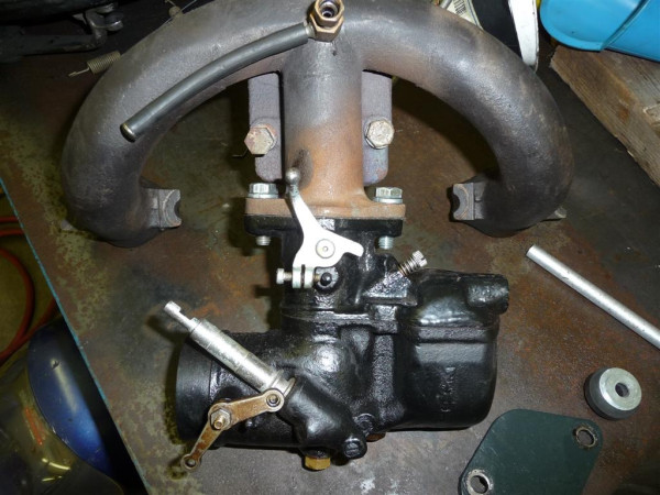

So Iam wondering if anyone that has tried a model A carb and manifold set up? I was thinking about this option and wanted to see if there was any draw backs to it. Iam not worried about being a purist so I’d appreciate positive feedback 😁
This is the set up for carb and intake I was considering. Reading a little bit the T and A are interchangeable??.

Re: Carburetor/manifolds
Post by speedytinc » Wed Nov 24, 2021 2:56 pm
Bryant wrote:
Wed Nov 24, 2021 2:32 pm
This is the set up for carb and intake I was considering. Reading a little bit the T and A are interchangeable??.7239C0A7-D79F-4AF6-9E18-E299B3DA4B19.jpeg
Ideally you add an extension to lower carb to not need a fuel pump. Make it at least 1" lower than a stock carb. (n/a 26-7)
Use an A exh manifold. Can use a C manifold, but A gets the pipe away from everything. No need for header plate. Outer stud holes need to be widened. Its a bolt on. Works very well.

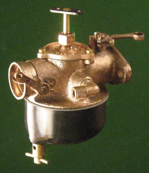

There are plenty of period/accessory carbs which will make a stock T run MUCH better than the standard carbs which came with the car.
The best benefit from that setup will be if you have done some mods to compression/head, cam, valves or some combination thereof.

I really like the brass stromberg carbs. I was attracted to the zenith because of all the classic tractors I’ve played with. Kinda reminds me of there set up. I guess the rest is price/availability.
I have a fresh rebuilt block that Iam considering using a z head on. I like to ponder options well in advanced so if you had to choose a carb that was parts available/reasonably priced/measurable performance and period what would it be?

regarding accessory carbs, there are none available with off the shelf parts availability, but there are folks who can manufacture parts as-needed. There are plenty out there that are restored and have been put on the shelf due to the owner seeking "better". "Better" is subjective...as in more power? more speed? more economy? more reliability?
  • Miller Master and Winfield are considered the "ultimate" performance carb, but not easy to keep in tune and hard on fuel. Expensive and Rare.
    U&J is considered "nearly ultimate" with benefit of being pretty much trouble-free but not particularly easy on fuel. Uncommon and a little rare, not terribly expensive but not cheap either.
    Rayfield UF (uncommon but not rare), and Zenith S4BF are considered a hot carb with OK fuel mileage
    Stromberg OF gives more power, more speed, more economy than stock carbs and maintains its adjustment. Lots of Stan Howe and other's rebuilds available. Considered best all-round carb by many.
there are lots of others (some say over 200 others!) but many require custom manifold setups such as Stromberg OS-1 and others
Any of these carbs look great on the car, perform far in excess of any stock carb and are correct for the era...
Since I have neither owned nor run every one of the above carbs, opinions above are partially my experience and other's opinions in whom I trust.

I like the period looking ones. The brass is great! I like the model A one. to me it looks fine. Just a little plain and simple. Seems very available. But when the hoods down it’s the model T I like. If you have any pictures of these carbs I would love to see them.

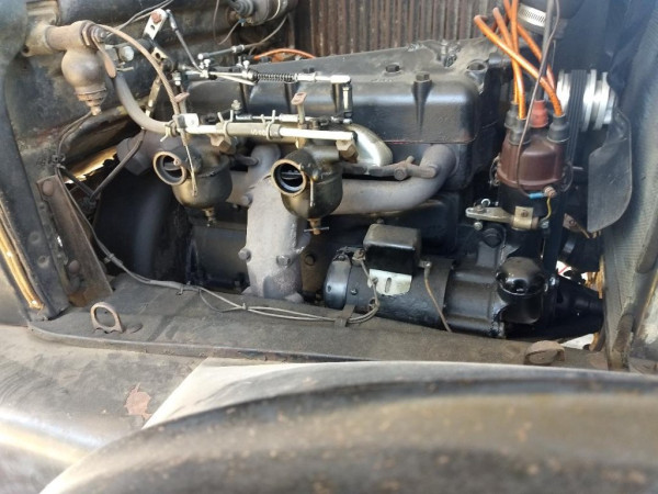

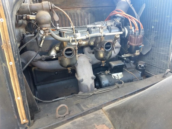

Bryant, many have done this conversion, the best setup I have seen was the B intake and exhaust manifold, the intake is larger for more air flow and the exhaust manifold kicks it out behind the engine like a T does. I would not go through all this unless you have went to larger valves, cam, head or hi comp pistons, the engine will run but to get the flow out you need these upgrades. Hope this helps?
Thanks! I have been looking at manifolds but am still not sure of the abc differences. what is what? The engine is fresh. Has the adjustable 350 Chevy valves. Will be getting the z-head. And now pondering a cam. With all that said I would also like to try a stomberg. Are we having fun yet? Iam at the beginnings of this journey and don’t mind trail and error situations 🥳

Bryant : The carb/manifold pictured in your original post is a B set-up, not Model A. One of the biggest mistake guys make in looking for a performance improvement is to over-carburate, (an old mechanic buddy of mine used to say "it's like puttin' a 650 CFM Holley on a lawnmower and expecting it to run perfect"). Those that have mentioned bigger valves and cam profiles are on the right track for a modification like this to a T motor, but don't forget that paper-clip crankshaft. As well, you mentioned a Z head but you might want to look close and compare a Prus head, in combustion chamber shape, head gasket surface area as well as machining tolerances. Good luck: Bruce
Agreed. Prus head. I didnt catch the B carb. An A works well.
A B/C carb. May be too much. Like I said. An A works on a T & a B/C works well on an A.
You might gain top speed but low end performance may suffer. That would be the over carburation Bruce is warning you of.
