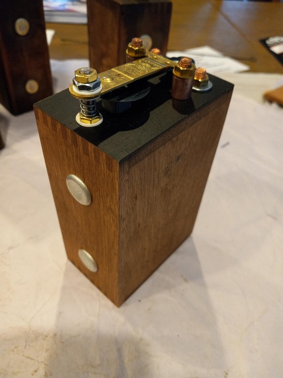

I purchased a single new coil recently and put it into the number one piston position in the box to help set the timing. I'm noticing as I set the timing at ATDC the points on the coil are sparking, as well as the typical buzzing of the points. Is there something wrong with the new coil to be arcing a spark at the coil points?

The new coil is from Snyder's...their new wood boxed version.

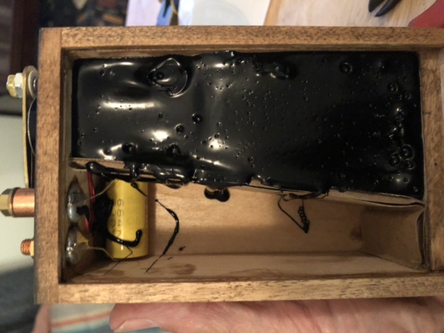

Just to see what was in the new wood box coil I purchased; I opened the case......it looks exactly like the photo MichaelPawelek posted. The same yellow capacitor with markings of 684K, 630V.
Forgive me if I don't understand how the markings correlate to actual capacitor performance....I just don't know, outside of the 630V is probably the maximum voltage the capacitor can stand. Is this the poor capacitor to use for a Model T coil?
Ron, when you say "Sounds to me like one of the newly made BXXXX Cp. coils made in Mexico. Many contain Metalized Mylar capacitors....." Is this what you're talking about?

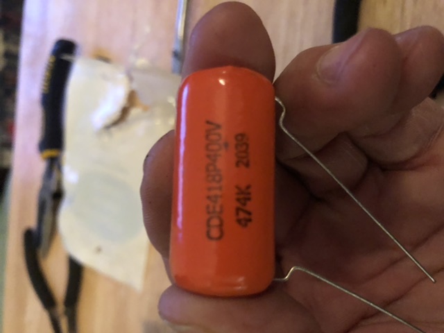

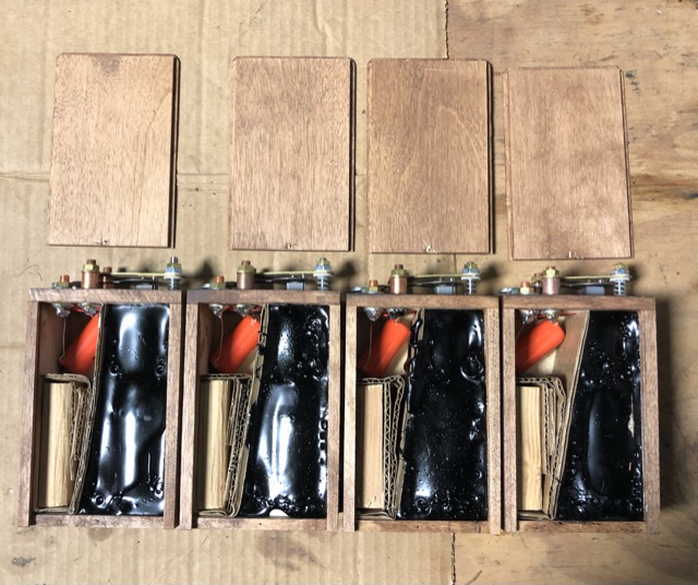

This morning I cut the yellow capacitors out of the 4 new coils that tested bad, soldered in the correct orange ones, then tested on my ECCT and they all registered “excellent”.
I find it really odd that Snyder’s sells these new coils with incorrect capacitors yet they sell the correct capacitors individually. Go figure…..
Almost ready for re-potting…

When you secure the new component I strongly advise you do not use expanding foam. I have seen this done and coils can swell and no longer fit in the coil box.
