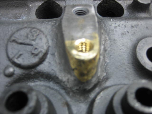

I hope that it's not his first welding job on cast iron?
Main thing is to preheat the area to be welded.
Kevin Pharis mentioned to tig weld with bronze.
This procedure works really well and doesn't work harden the iron.
This example is one we did on a 312 Ford.

You must be careful with the silicon bronze if you intend to machine afterward. I’m not sure if it’s carbides being formed or nickel getting pulled out of the iron... but I’ve found my share of impossibly hard spots imbedded in the bronze
