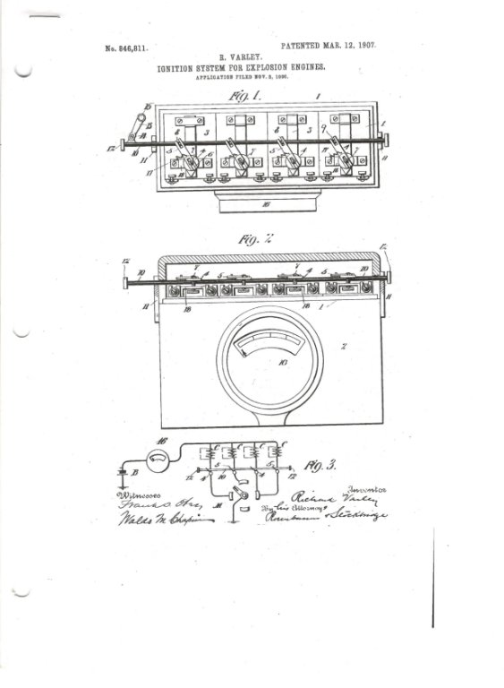

Been Here Before
- Posts: 654
- First Name: George John
- Last Name: Drobnock
Re: setting up coils on car?
Naive question. Once one goes through and adjust the coils individually, how can one be certain that in operation, the coils are properly adjusted for the vehicles electrical system? What assurance does one have and how does one monitor the performance of the coil once in the coil box? Especially where current draw is critical.
May be a revised coil box (Circa 1907) that includes a monitoring meter and a in car coil adjustment device.A way to adjust the coils in the car for even better performance?
According to the patent's opening statement, the device will economize the battery current, and even the magneto's current, allowing the coil to be more efficient.
