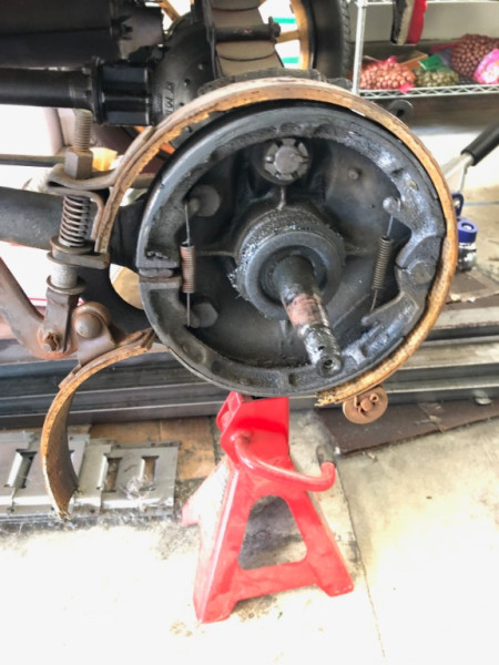

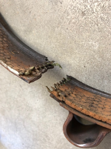

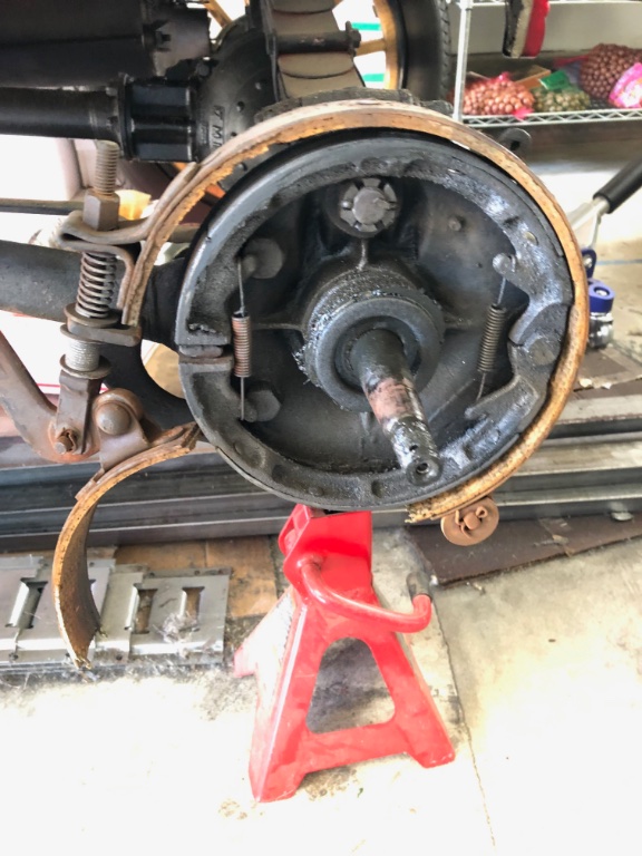

A week or so ago, our 1914 T touring made a funny noise while riding around town. I couldn't place the noise, so I didn't worry about it. Inspecting the rear wheel last evening, I see that the band on our accessory brakes (LOCKWOOD or LOCK GOOD brand) has snapped in two. These brakes have served us very well since 1969. When adjusted correctly we can lock up the rear wheels going forward or reverse when used with the stock transmission brake. I relined these in 2009 with the McMaster Carr green woven brake material mentioned in other posts. I have been stopping trouble free since then. Up until now. Inspection of the broken band shows wear down through most of the lining, but the band itself just snapped tearing the remaining lining apart. See photos, below.
The brackets on the band can be removed and reinstalled (welded and/or riveted) on a new band --- IF --- I can determine what sort of steel these bands should be made of. They have some springiness so I imagine there is something specific I need to be looking for. It does not look like any of the vendors have replacement bands of this sort available -- except as part of a set of new Rocky Mountain or similar accessory brakes. I note that this sort of exterior brake system was used on other cars of the period. One brand I am familiar with is Royal Equipment Duplex Brakes (later Raybestos) which are on our 1912 Michigan. Any ideas where to obtain springy band material? Or some other ideas? Thanks in advance - Craig in Carlsbad CA

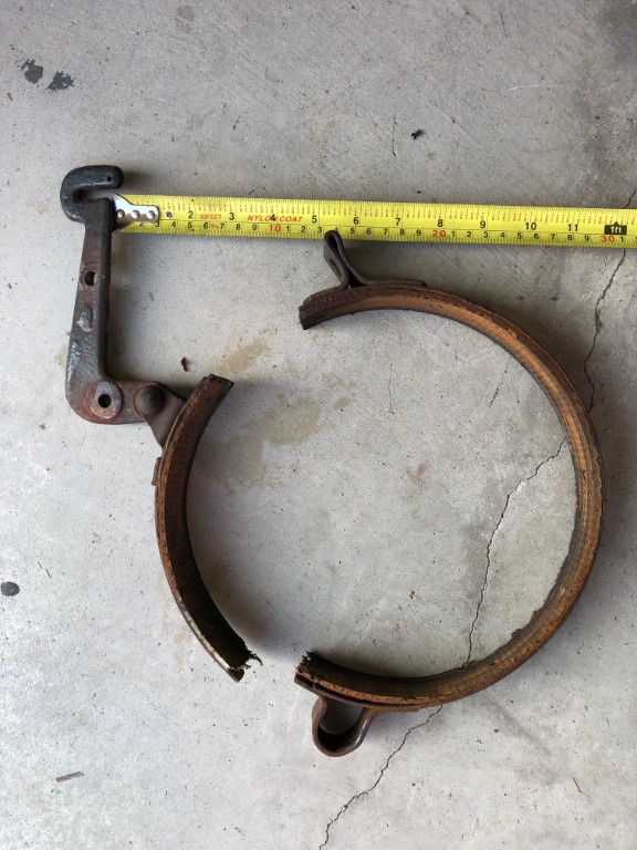

Transmission bands are a good idea -- but alas, they are 2" too short at only 24" in length. The brake band is 26". Also the thickness of the transmission band is .0747 (14 gauge steel). The broken brake band material looks to be about .0825 or nearly 13 gauge. I'm sure the thinner material would work, but I'm going to continue to see if I can find something closer. Worse comes to worse, I'll simply butt weld at the break and weld a patch over the outside for strength. Then re-line the old band. I'm going to continue to look. And dang it, the McMaster blue spring steel dimensions don't seem to come close enough. So that's the broke brake story so far.

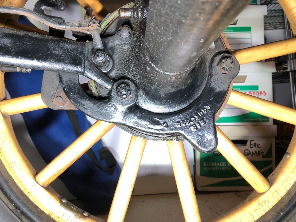

I would really be interested in seeing pictures of the mounting side of these accessory brakes and also how they are actuated if you don't mind posting some additional detail shots. Thanks!

Here is a photo of the mounting side of my LOCKWOOD or LOCK GOOD accessory brakes. The casting is sufficiently blurry that It is impossible to tell which of those brand names is correct. Maybe someone else has a set with a clear casting that shows if the letter is a "W" or a "G". I've welded the band and added a reinforced area on the outside covering the weld. If it pops, I'll just move up to building a new set with materials such as suggested by others. Now I'm waiting for rivets. The plan is to JB weld the green brake lining material on to the band and then rivet it in place. That is what I did back in 2009 and It worked flawlessly until the band broke - tearing the still remaining lining with it. (see original post) Thanks, Craig in Carlsbad CA
