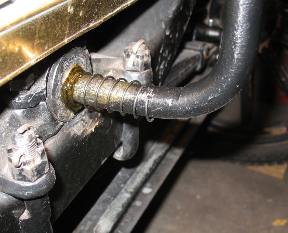

My speedster has the front axle mounted in front of the radiator. This necessitates a longer crank. I fabed one up, but have a couple of questions.
How far back from the ratchet end is the spring pin hole drilled?
Is there just a pin to hold the spring in place, or a pin and washer?
I can't seem to find any pictures.
Hand crank build.

Re: Hand crank build.
There is no pin or washer to hold the spring.
The outer end of the spring has a little bend that sticks into the tiny hole in the crank handle. The hole is 5½" out from the back end of the crank.
Al it has to do is pull the crank away from a moveing crankshaft.
Thank you for the pictures. This clear things up well.
