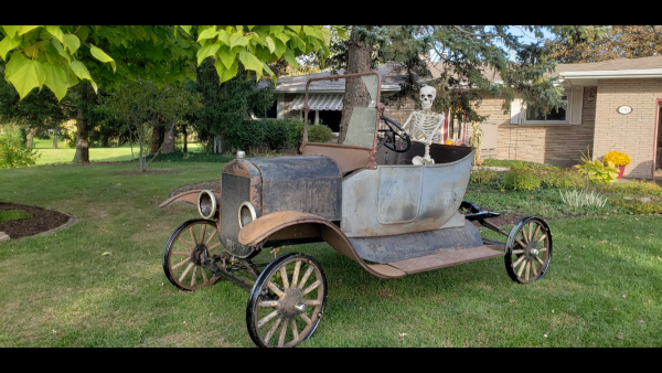

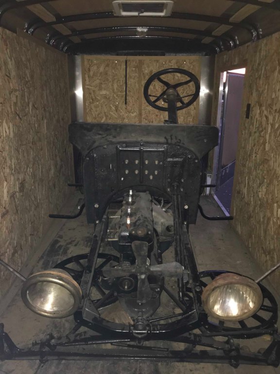

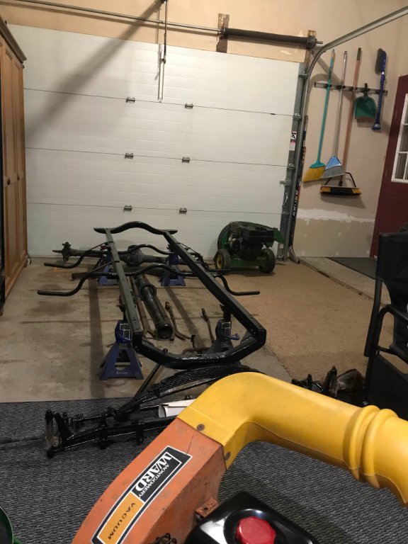

Thank you for the responses
We have a '23 Ford Model T I believe, but are looking to make it look like a '17 or '18 Canadian Model T. I was told that there is not much difference.
I have attached the pictures I have. Sorry I don't have a lot of close up ones.

You could say there are not major differences in body style between 17-18 and 1923. At the same time, a lot of parts are different. A 1923 block is a different style than 17-18, as is the hogshead (transmission cover), and firewall (steel vs wood). Several smaller parts are different too. Handy for sorting out the years and USA vs Canadian Fords is the MTFCI book of judging and restoration guidelines.
