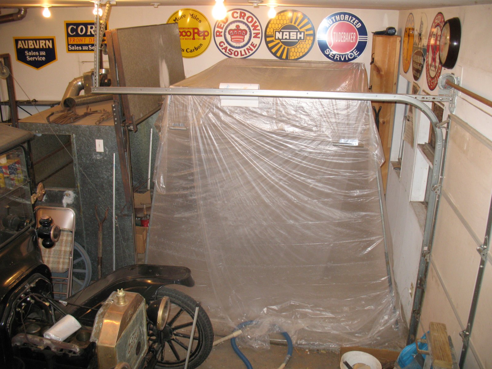

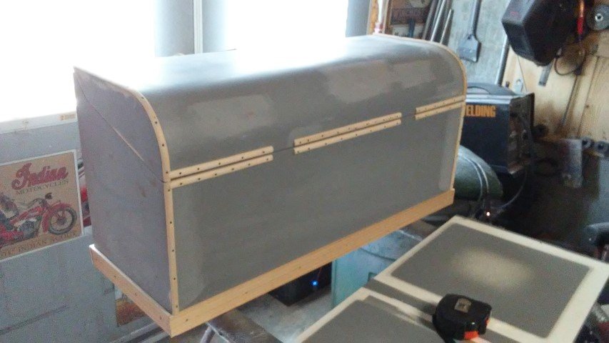

This is slightly OT but related. You can make a paint booth with some conduit and plastic drop cloth. Cheap, cheap, cheap.
Mine is for parts, but there's no reason you couldn't make one big enough for a car.

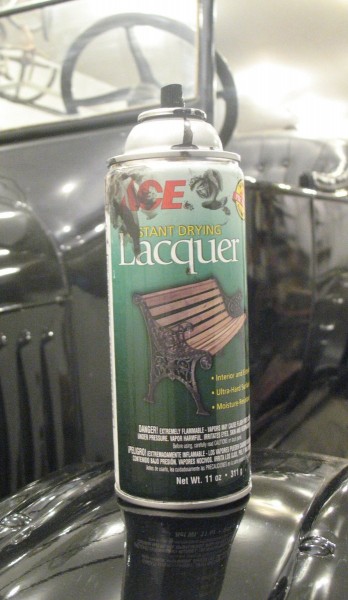

...unfortunately lacquer is close to unattainable

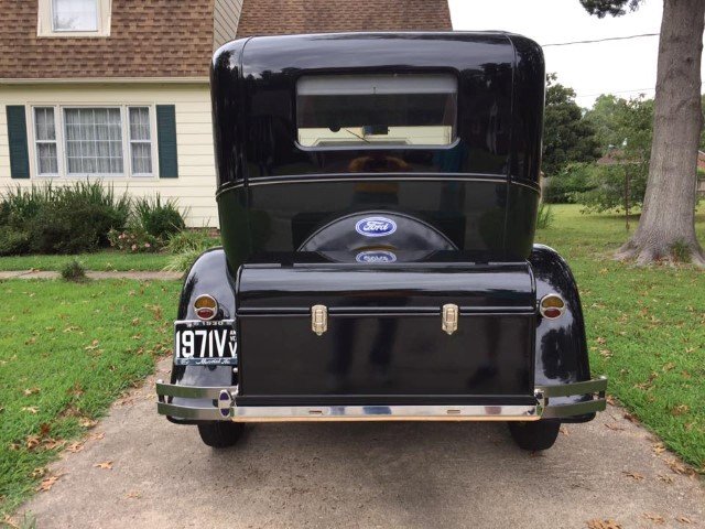

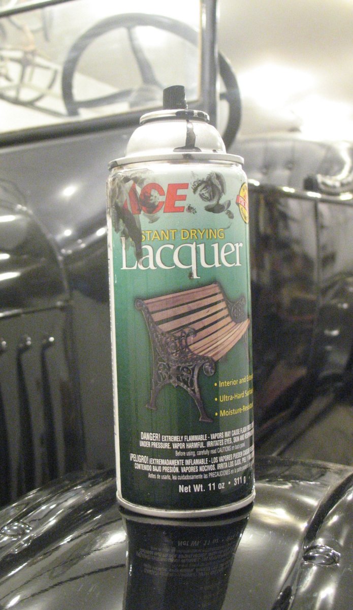

I bought this at the local hardware store.
Recently I replaced modern carriage bolts with correct ones and had to touch up the windshield stanchions. I'll see how the lacquer holds up.

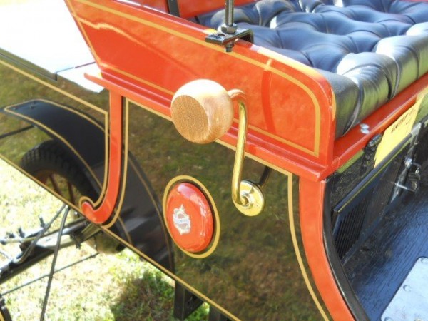

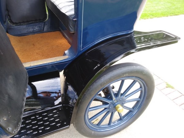

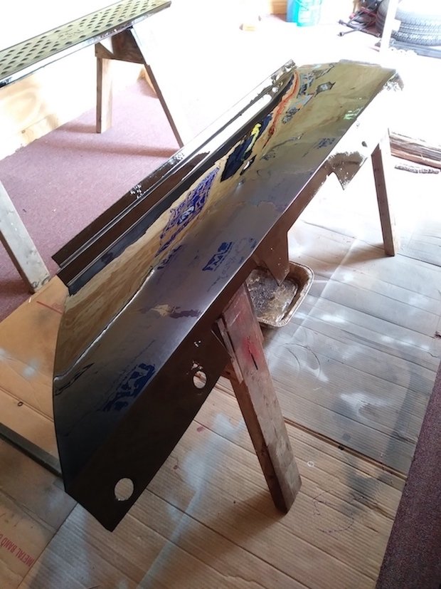

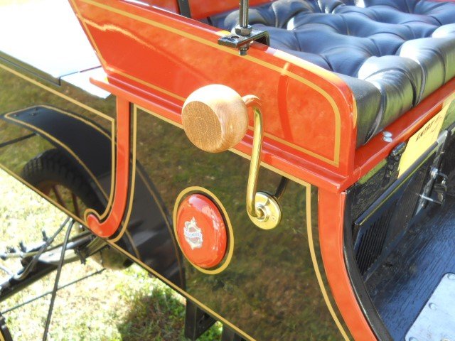

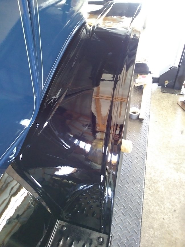

Due to what I perceive to be a victim of "adult A.D.D." and the accompanying short attention span, I only skimmed a
few replies. So FWIW, here's two pics of what I painted on my former '12 touring (splash apron and a fender), I used PPG Concept DCC9300, with the appropriate hardener and reducer and a small can of something to give it that "wet look", which half the time you don't really need! This paint is not cheap, but really goes and flows well! But of course prep is paramount as I've learned the hard way. I sprayed these parts (also some not pictured) using merely a Preval glass bottle/aerosol unit, typically found at any local parts store for around $8. Thinning to the right
consistency is critical, trial and error will show you.

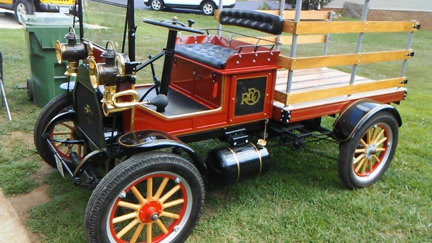

Get a gallon of black acrylic enamel, fast reducer (thinner), and a pint of spot hardener( sets up quickly). Get your car ready. On a still morning roll it outside on a clean tarp. After 10 minutes or so tack it and shoot it. Most dirt in a paint job comes off the car. Clean it, tape it carefully, and if you ain't in the Gobi Desert or the Everglades your paint job will be surprisingly clean. Any runs or bugs can be water sanded and polished after 2 weeks cure time if you used hardener. I sprayed acrylic enamel for many years professionally and prefer it over anything else. These 3 replica cars are wood bodied, lacquer primer and acrylic enamel with hardener shot out in my yard on the grass. The black Model A Ford trunk is wood. Best of Luck!

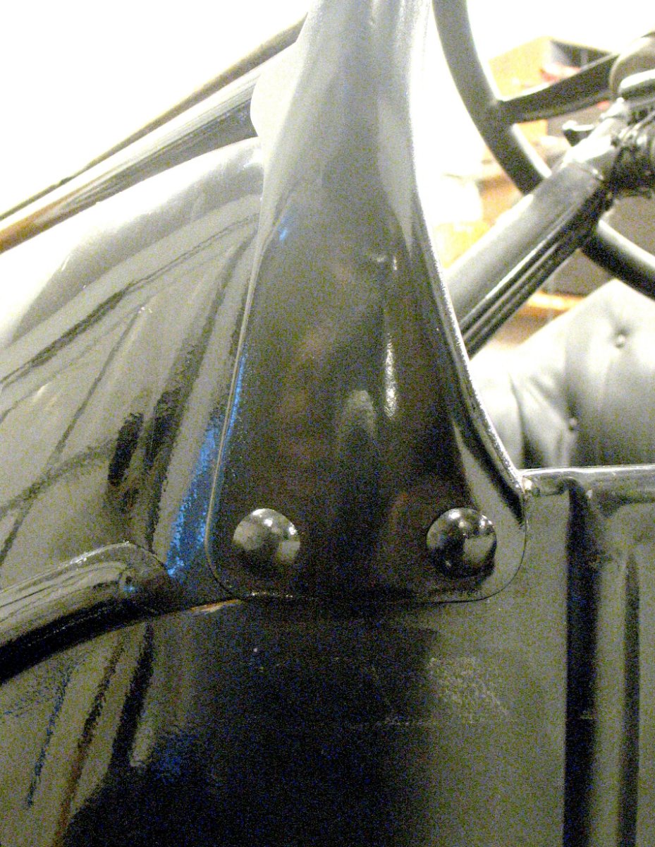

Re: Best Black Paint For Painting a T?

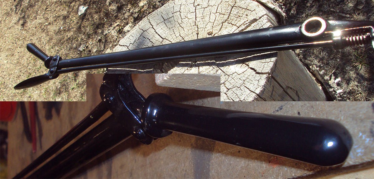

Not to flog a dead horse but here is a brake handle brush painted with VanSickle. If we are talking about old enamels, Dulux was the best but disappeared 20 years ago. Rust-Oleum is good also. Whatever you use and like is your favorite. If you don't mind the slow dry try this. It is my favorite now. I like Centari but is has become obsolete too as most paints do over the years.

1925 mostly original coupe.
- Posts: 3743
- Last Name: Wrenn
Tinman...last I knew there was no more acrylic enamel to be had, which is why I ended up switching to PPG Concept. I loved the good old enamel, but I have to say I like this Concept urethane stuff a lot better! Just sayin'
