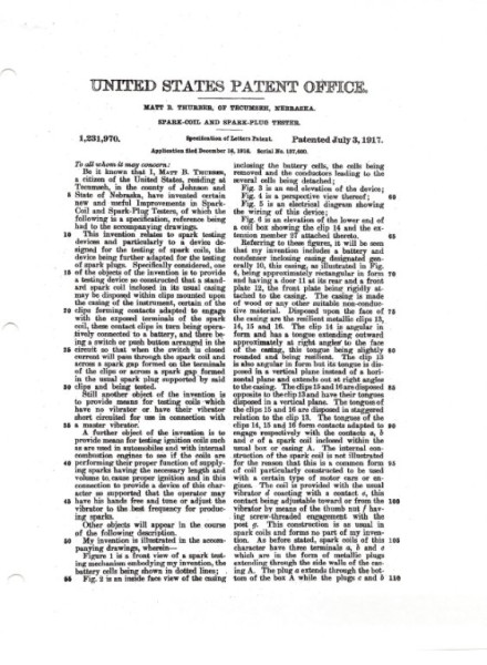

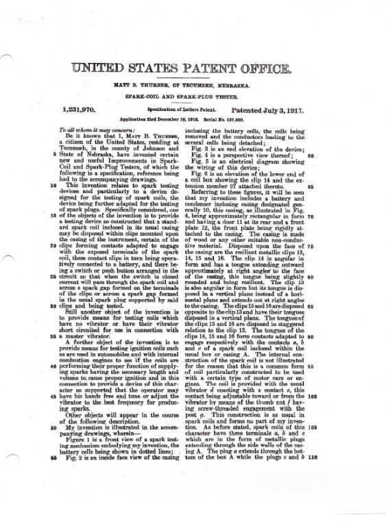

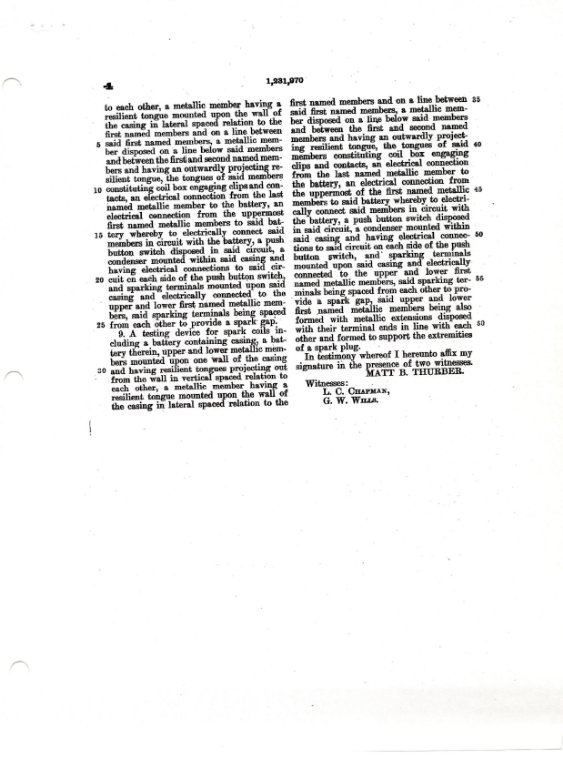

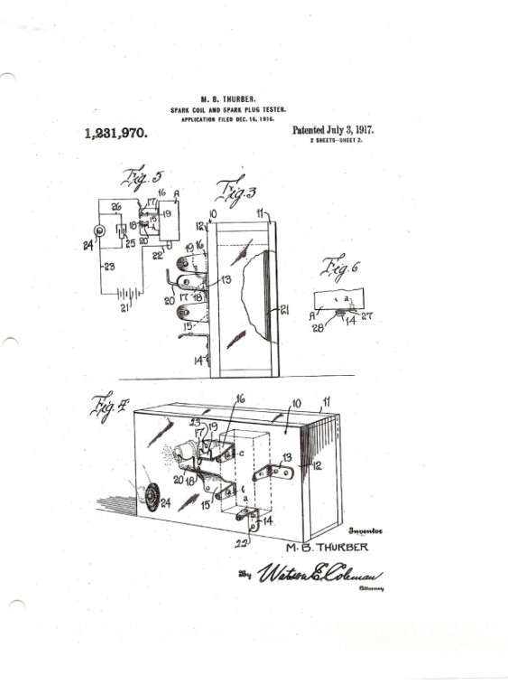

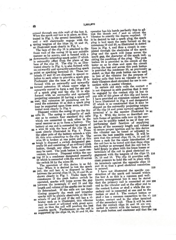

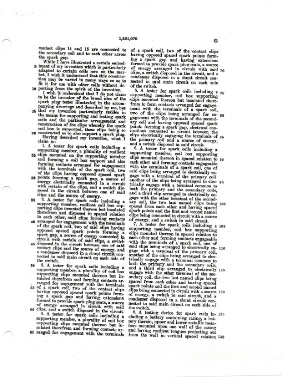

I have attached a patent design of a 1917 spark coil and spark(ing) plug tester, per a google patent search. Patent number 1231970. There is a wiring design with the patent papers. enjoy.

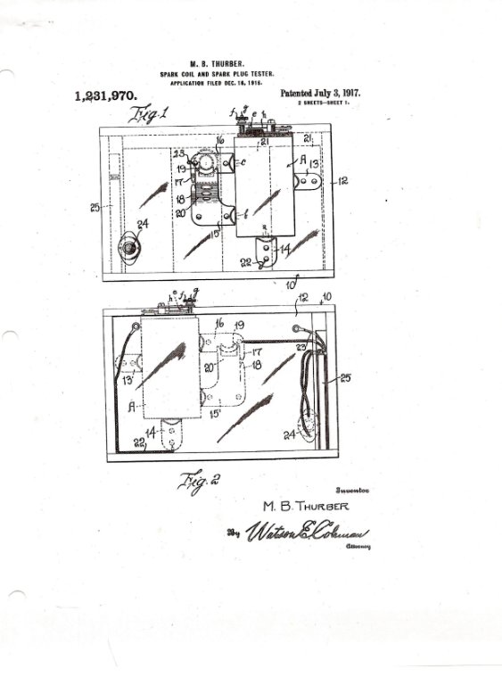

(part 2) - I have attached a patent design of a 1917 spark coil and spark(ing) plug tester, per a google patent search. Patent number 1231970. There is a wiring design with the patent papers. enjoy.

I don't see a meter in there. (Kind of tough to see actually). So isn't this just a fancy buzz box?

This design uses two meters: the infinitely variable Mk1 eyeball light detector and the aural sensor meters (eyes and ears) to see and 'judge' that the spark being made is fat and happy.
Even with a meter showing the amps, adjustment in the old buzz box approach still needs these meters to be used as well.

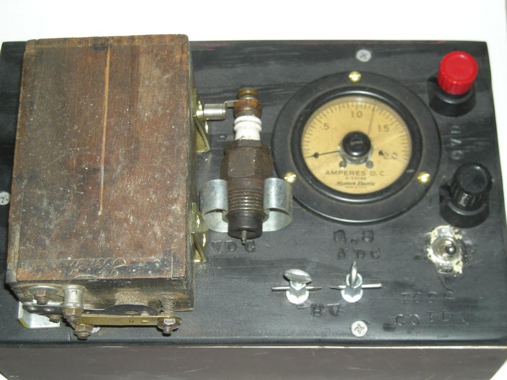

Allow me please, to bore you. Attached is a buzz box adjustment and coil tester using DC voltages. The analogue meter is maxed out at 2 Amp. The meter should be good enough to get the proper setting. The meter is at the input side of the coil. Now that the message has been delivered, please place knives where appropriate.

As has been observed in the past multiple times on this forum, this type coil tester has no provision to see the time and space relationship of the coil spark output. That feature is critical to Model T Ford coil point operation.

Like any buzz box adjusted coil, the coil will allow the car to start and maybe even run fairly well, but not optimally.

Quite right, it is far from the 'ideal' solution, but if can be made to work 'near enough' with practise, even if not actually 'optimal'.As has been observed in the past multiple times on this forum, this type coil tester has no provision to see the time and space relationship of the coil spark output. That feature is critical to Model T Ford coil point operation.
Ron Patterson
The hand cranked tester would be the next level up then the HCCT for the top.

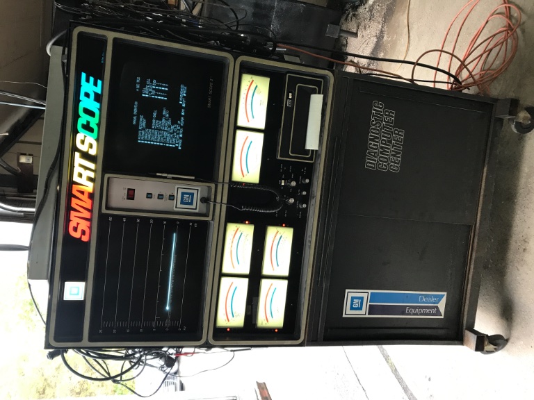

I don’t understand all the controversy. Just plug in your code reader at the OBDII port underneath the steering column on your Model T and it will tell you if the coils are working properly.

If you do that, the Proprietary Software Police (PSP) will break down your door at 3 AM and take your coils and timer and kidnap your dog!

Re: Adjusting buzzer coils
Free scope I got--- if the coils don't wack it out--- the coils made my snap on vantage cry, locked it up crying, is ok once I took battery out, rebooted it. The Allen smart scope has many functions, so far I got all the scope functions working that I have tried.
It has divisions using the width of the screen for 5 milliseconds, just have to get the car running to drive it to the scope.
Right now I am using engine without head and valves as " hand crank coil tester", I can keep up 80 rpm for about 30 seconds.
One of my coils makes 3 sparks, they all jump a .060 gap and seem equal in intensity---- what is the strategy to cure that?

Back in the day, the vast majority of Model T owners could not afford the special equipment needed to adjust spark coils. That is why they owned the cheapest automobile on the market. In 1970 when I bought my 1926 Model T coupe for my life savings of $600.00, I was a poor 16 year old student who was very new to Model T’s and was unaware that such equipment even existed, so, I adjusted my coils by ear like the old-timers did, until each buzz was uniform, steady and loud. In 1972 when I was concluding my 2 year restoration and I started my T for the first time, it ran like a sewing machine. Fifty years later, I don’t think my T has ever run as well as it did that first time, even with an extensive, professional overhaul and professionally adjusted coils which I had done 40 years later in 2010, when I could afford it. Jim Patrick

Interesting how the Model T ignition system is being brought into the future.
So the introduction of an oscilloscope is being discussed. Don't have an oscilloscope may be adapting (with the proper hardware) your computer may be the answer?
https://listoffreeware.com/best-free-os ... e-windows/
I am not suggesting that you use your computer or smart phone in this manner.

I am in the process of building a coil tester. It will not tell you if you have a double spark or some of the things an Ecct tester will but you can find out if you have a usable coil and will not empty your billfold.
Several years ago in Tinkering Tips one was pictured using a 6 volt battery. Ted Aschman said it would work better using a good electric train transformer as they put out AC current. Mine uses a small wooden box to hold the coil with original brass contacts, bolts and ceramic insulators. I made a grounded metal spark gap unit and had a model t amp meter wired in.
The first 2 coils I tested did nothing. The third one buzzed and put out a weak spark and the amp meter moved slightly. This set up should tell me if the capacitors are good or if the coils only need an adjustment.
Since then a 0 to 30 AC voltmeter and a 0 to 5 AC amp meter have been purchased. Right now I have about $12 involved as everything else were things that were in my parts and now I want to redo it on a different board and mount the new meters. I would like to redesign it so the unit will be in a wood box to keep it from dust and damage.
I liked the picture of the unit with a metal broom holder ho
