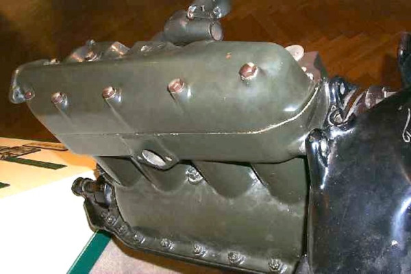

Where can I get "Moleskin'" color paint for the engine?

Try Snyder's. The insert picture if from their website as to the paint color when applied.

I took the photo of the moleskin painted engine to the Sherman Williams store. They said scanning a photo will not work. It has to be a quarter size actual sample of the paint.
Has anyone actually painted an engine with moleskin recently? If so, how/where did they get get it?

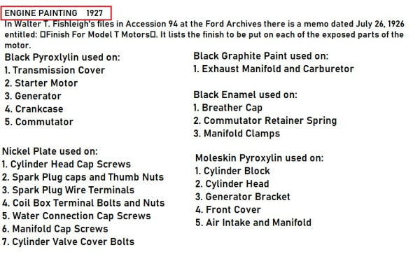

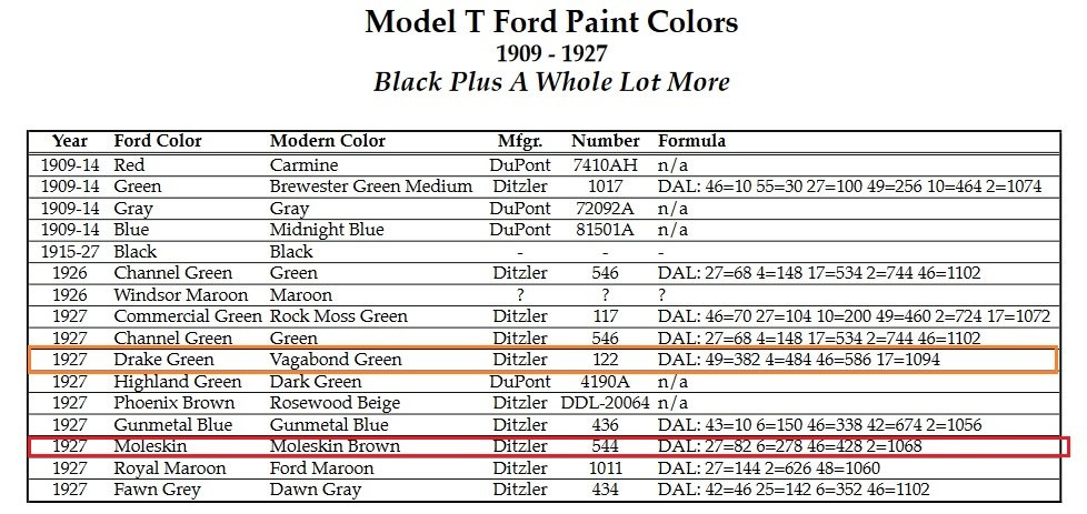

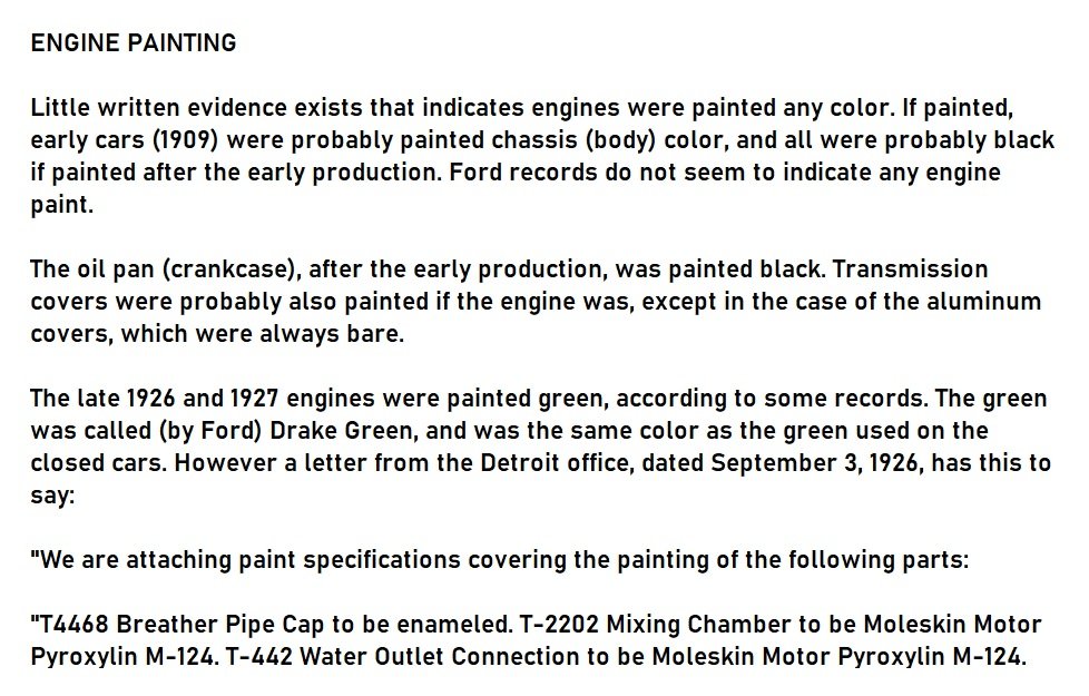

Interesting findings
This indicates that 1926 engines ere painted Drake Green and some parts were paint Moleskin
http://mtfca.com/encyclo/E.htm#eng5 Then this says for 1927 a mix of colors to dress up the engine.
http://mtfca.com/encyclo/P-R.htm#paint3 --
Might have SW try these to see what the colors are
Don't be concerned with the name "Moleskin Brown"
from http://www.texastparts.com/mm5/manuals/ ... Colors.pdf

I would submit that the color Moleskin used on late T engines is a significantly different color than Moleskin Brown. Moleskin Brown is a Model A body color, it is a dark brown with a green undertone. Not close to the color of the engine pictured by Jelf.

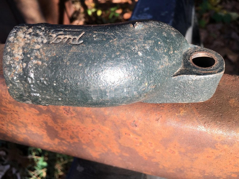

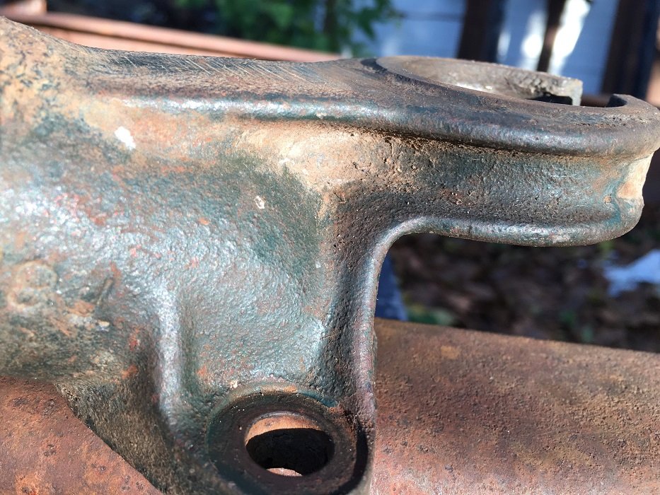

Looking through my stash of water inlet and outlet connections, I found two that had green paint on them. I cannot guarantee these have not been re-painted at some time in the past, however I doubt many engines in use in the day got freshened up with new paint. And if it was part of a restoration project, why aren’t they still on the car? Just some thoughts… Anyway, here are the pictures of what I found.

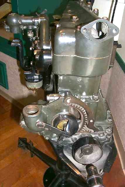

I am working on a '27 Tudor and have been contemplating the same thing. Using the photos of the display engine at the Henry Ford as my reference I have been trying to come up with a match. Of course computer screen images are not always completely accurate representations but that is all we have to work with. I have displayed that picture on multiple screens and they seem to be pretty close to each other. What I have found is that Rustoleum Moss Green, satin is a pretty close match. That is what I am going to go with on my engine. If anything it might be just slightly lighter in shade. That is hard to determine as there are differing shades in the photo due to differing lighting conditions on various parts of the engine.
An area midway between lightest and darkest would probably come closest to the actual thing.

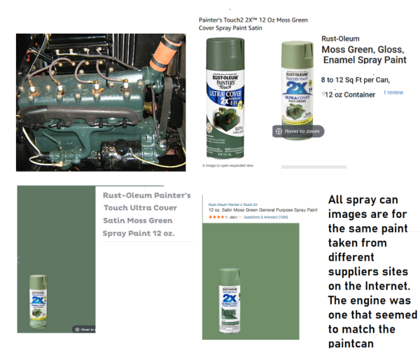

Color variations start with the initial lighting upon which the photographs were taken. Then the one that was selected to best match the CAP on the top of the can. Then the digital image is made available to all suppliers to include in their sales ad, which is eventually displayed on computer screens who's color settings, back light etc vary. I have copied several images with my software (Paint) that all looked different initally. Having said that, wonder how this image is rendered on your screen.

Steve: That's what I was going for was an average or median of the lightest to darkest of the colors in the picture.
Frank: I understand what you are saying and I ran into that a lot in searching online. I picked up a can of the Rustoleum Moss Green in satin finish like you show in your post. I sprayed a small panel so that I had an example of the actual paint color. It is very close to the median color in the photo of the engine at the Henry Ford. I am going to call it good on my attempt to get close to that color.
