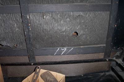

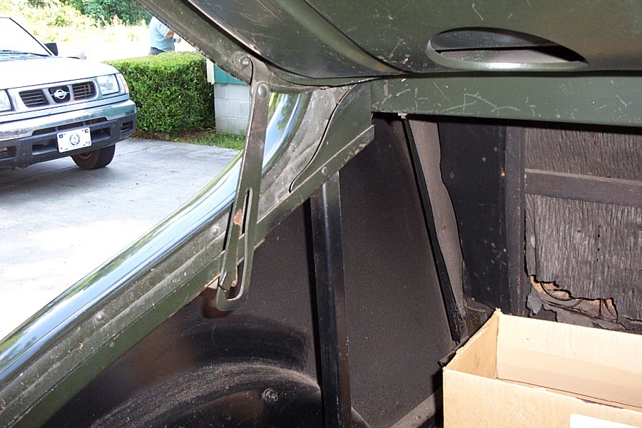

Very original green late 26 Coupe, underside black, and turtle deck area and metal work black, original backing on seat back is black heavy paper. Chalk marks original. Under side of deck lid body color, body color overspray on sides of turtle deck.
Chaulk mark in trunk.jpg (46.88 KiB) Viewed 1286 times
