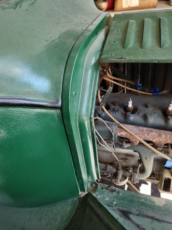

I am trying to determine the year of my new project. This touring car has a 21 3/4inch hood with six louvers per side. There is a cowl so the hood does not reach the wood firewall. There is a battery box below the rear floorboard and I am sure this is a replacement engine/trans as there is a generator and starter motor. There is no ammeter. The black box mounts to the firewall and the key attaches to it. Radiator is brass and there is an acetylene generator but all running lights are painted. The radiator is probably not original.
Any ideas as to year of build?

Single valve door. I agree with Steve except early '22 through '25 engine and trans. The serial # would narrow that down.

Post by Steve Jelf » Mon Feb 28, 2022 3:49 pm
Ah, yes. One picture shows the hole in the center.

Yes the single valve door makes it 22 - 25 engine. Looks to me it has the later high head.
Did you get a title with the car? What does it say.
It does look like to me that it’s a 15-16 because of the hood former. Without seeing the rest of the car it may or may not have some later parts on it. Some parts would work and interchange but might be a little newer.
I wouldn’t worry about changing out parts to be more authentic but get it running and driving first than consider changing parts if you want to.
Lots of Model T’s have later parts on them and the engine being a little newer than the body type was done fairly often. A starter was’t used until 1919 so this driver wanted a starter instead of having to hand crank it. Could be that’s why it has a starter engine.

Here are the photos from the link. Pictures 1 and 3 show the firewall to made out of OSB (Oriented Strand Board).
