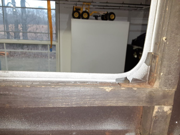

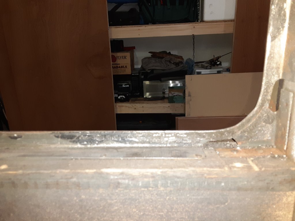

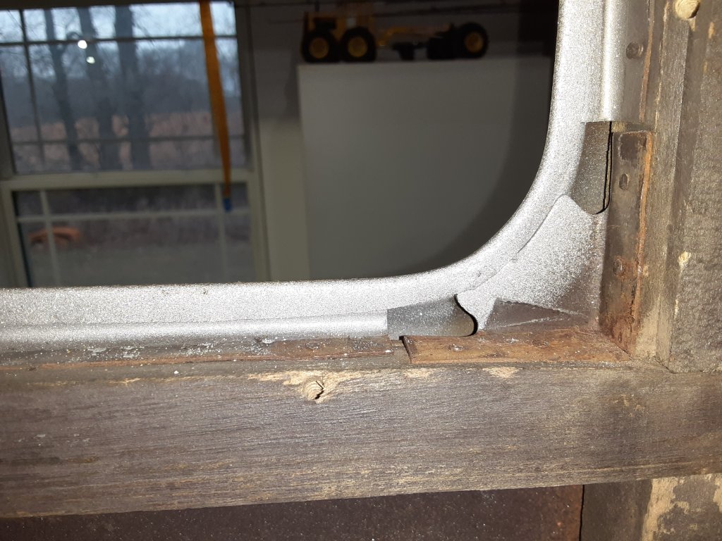

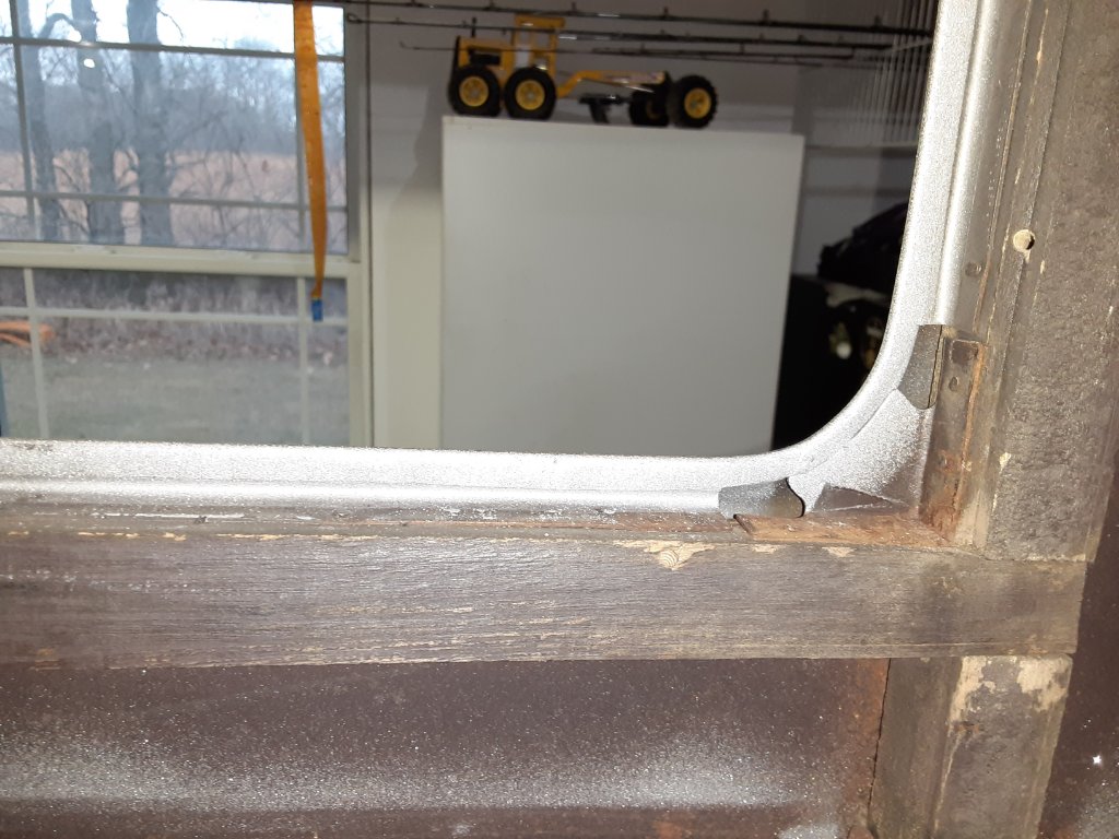

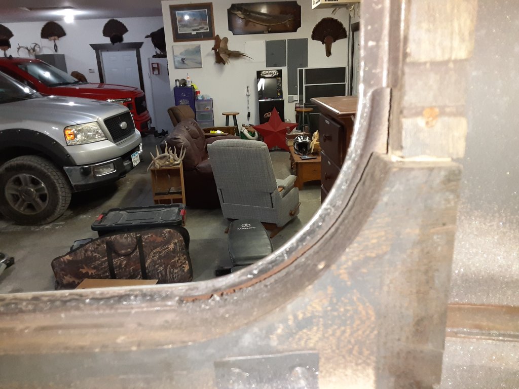

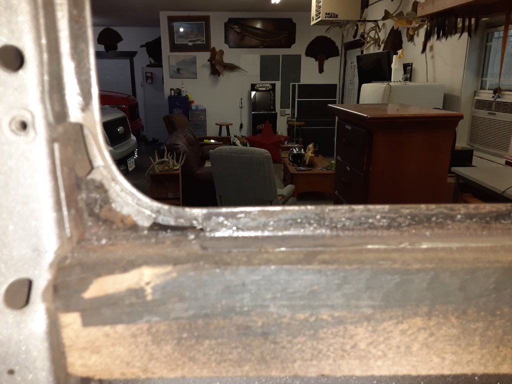

Should the inside perimeter around the quarter and rear windows be painted on my 1927 coupe? The locations are shown in the attached photos.
Use a prime coat or a prime and top coat?

You'll never regret painting it, even if unnecessary. But, if there's the slightest chance those surfaces may be visible after it's all done, you'll kick yourself for not painting them when you had the chance. Plus, the paint will seal them from the weather and possibly prevent future rusting.
I would also paint the interior wood and metal surfaces with Rust-o-leum flat black to seal & protect as well.

I would paint any thing and every thing that way you seal the wood and metals from water.

Joe, Thanks. I will do it! Photos will come.
