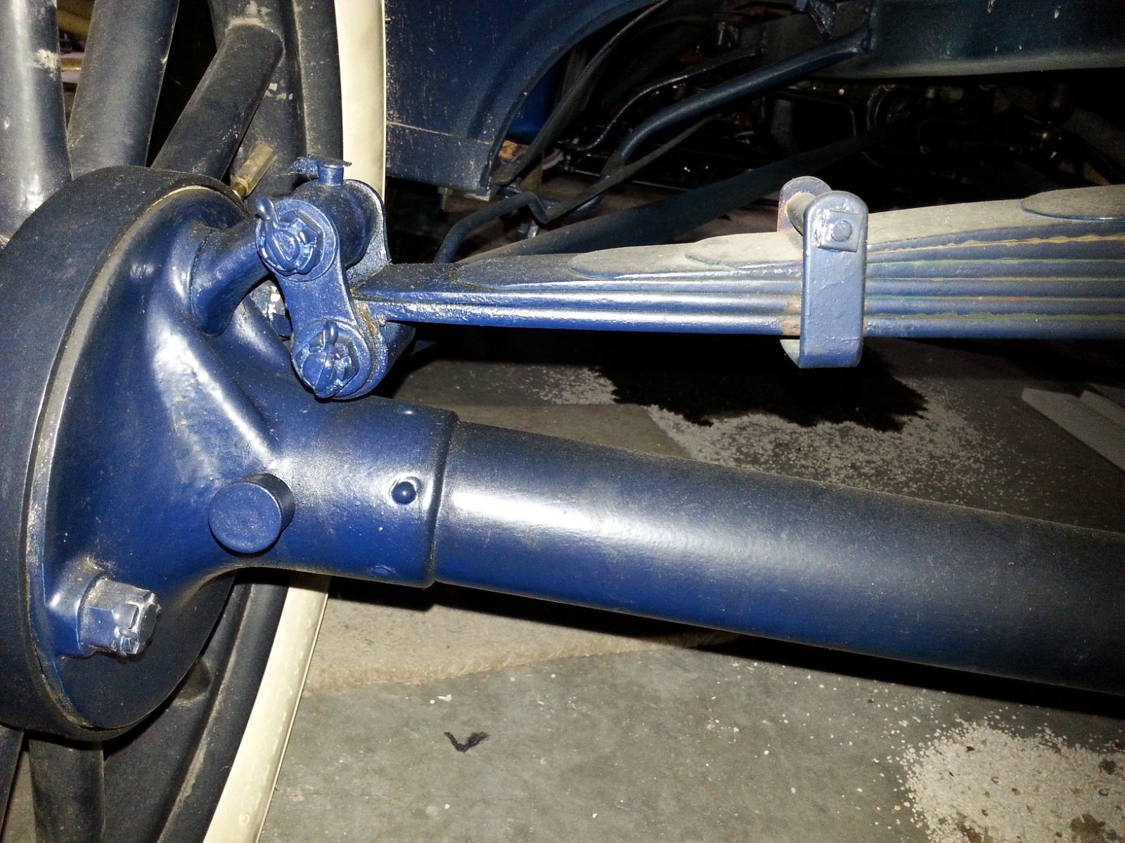

nsbrassnut
- Posts: 149
- Joined: Sun Jan 06, 2019 5:30 pm
- First Name: Jeff
- Last Name: Lee
- Location: Nova Scotia
Re: ***1914-1925 Brake Assembly***
Hi All
Here is a picture of one installed.
Part 3848 is upside down.
Still a great drawing.
- Posts: 7273
Guys, in the first drawing Martyyn has the perch looking like it is up side down, only because the curve heads inwards and then arches upward. In his last drawing he has changed the perch to reflect that the curve starts upward and then arches inward, as in fact it does. This is shown in the later photo with the two early perches.
I admire his ability in making these drawings, and respect his willingness to get them absolutely correct.
nsbrassnut
- Posts: 149
- First Name: Jeff
- Last Name: Lee
Hi Allan
I see the correction in the second drawing now. I was focusing on the original.
Projecting curves in isometrics can sometimes lead to interesting views.
I also appreciate the drawings. They help to show how the parts go together. Something that Ford didn't get around to for the Ts.
