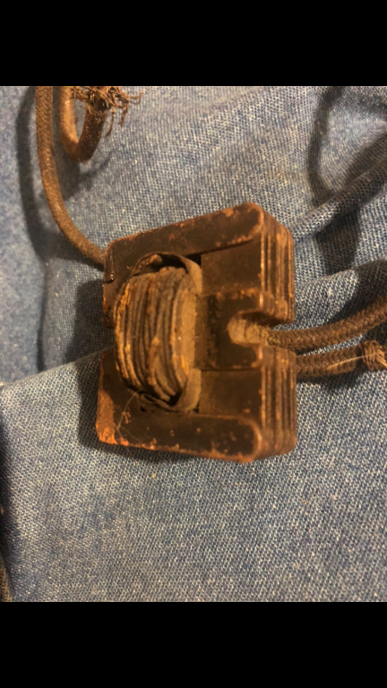

Ford built and sold a magneto voltage reducer for dimming the headlights on 1915 to 1918 model Ts without a generator and electric starter. they are still found for sale at reasonable prices on e-bay and here on the forum. You can also take a choke coil out of a old radio power supply. or convert a model T coil to a choke transformer and hook it up in series with the magneto and headlights. as the engine rpm increases the frequency of the magneto output along with the voltage increases and the choke coil limits the voltage passing through the choke at the higher engine speeds thus limiting/regulating the voltage to the magneto headlights at high rpms reducing the possibility of burning them out.

Seems like He rewound the coil to get the desired voltage reduction at max rpm. I saw the article some time back but don't remember where.

Re: Answer No. 85 on Magneto lights
Isn’t this Ford’s answer to the problem of burning out bulbs? Two wires go to the combination horn button/light switch (bright and dim). They go to separate windings in this dimmer coil then the one wire goes to the wired in series headlights.
