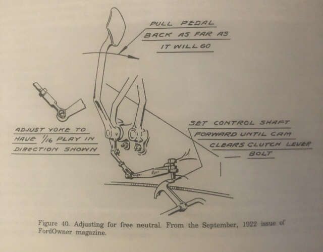

Re: I have to jack up the rear to start it
Be sure the linkage and cam bolt under the left pedal are adjusted properly for the best possible neutral. Switching to a different oil and jacking up a rear wheel are common sometimes in colder weather but the adjustments are critical. Also depends on whether you have the original clutch discs or one of the aftermarket set ups….
