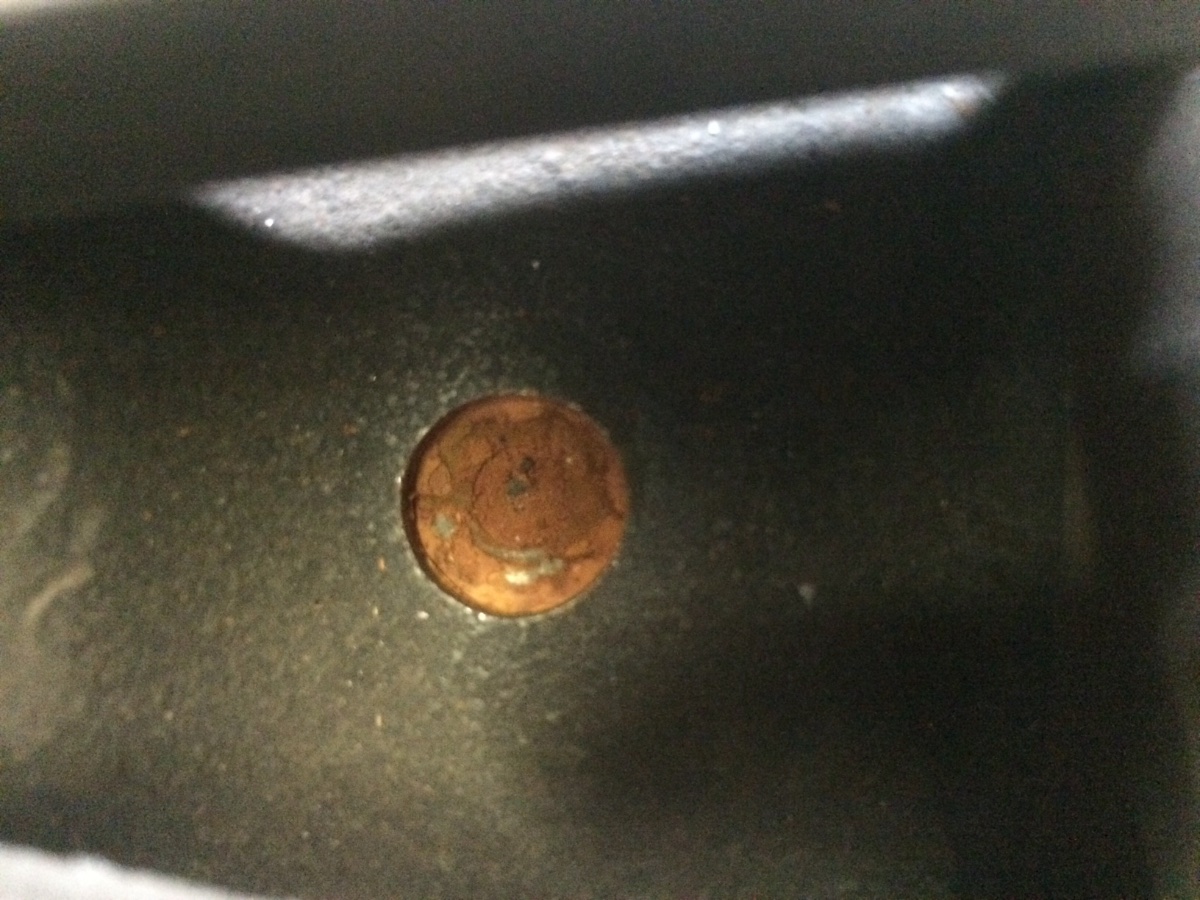

I will post some pictures of one I had done recently.

[image][/image]
I see this one was pretty good. Only required a bit of help on the magnet side

In regards to drums, it looks like I’ve been lucky (which I will take any day)!! Maybe Ford Canada drums were made better. Certainly no guarantee of that!!

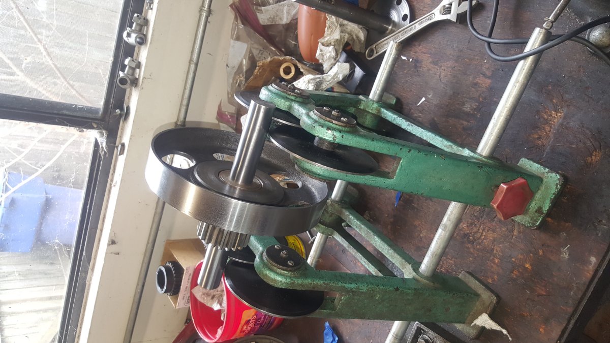

I am balancing transmission drums today and tomorrow. I have a static balancer, the type with rwo sets of wheels on two triangular stands and two mandrels I made. The low speed drum was 11 grams out, the slow speed 12 grams. Getting is perfect is a neverending battle, but the two are better than 2 grams out so far. I'll probably try to get it closer tomorrow, but it seems once you get one heavy side balanced, another pops up in a different place. I'll get it as close as I can without going bonkers.
- Posts: 5549
Re: Balancing transmission drums in VA
The above looks like a new drum which I am thinking might be a different story then original drums. I would think removing any material from an original drum might be dicey, after all they are already 93+ years old. New drums would be nice, but for some of us, that isn't in the cards.
Now I am not saying not to, but to think about it first.

Hi Scott, This was a 1926 engine for my father. The balance is pretty good, but could have been better. Fourth main only ran out .0015 and aligned perfectly with the pan. Just saying that the drums appear to be the culprit and I wouldn't take a chance again.

The drum pictured above is an original drum which has been trued and polished. I've never had a problem balancing original drums. Re the low speed and reverse drums I did today, it was a matter of enlarging the holes. The brake drum/diving plate assembly is different of course, but I don't anticipate a problem.

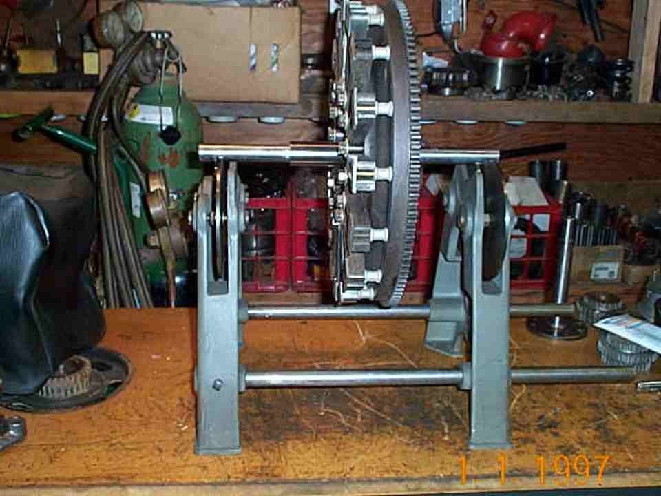

Interesting to get all the info on dynamic balance. I balance all parts on knife edges. As a test of our work, I sent out two flywheels to have spin balanced after static balancing here. One with magnets, one without. They came back with two additional 1/4” holes drilled about 1/4” deep. This is an amount of weight removed completely insignificant in the rpm range the model t flywheel will ever see, in my estimation. Opinions will vary. We balance transmission drums on the same equipment. While the weights involved and correction radius are not large, consider there are three of them and they do not always come up in the same orientation to each other every time the clutch is engaged. In the event all the heavy spots come up together, it could be noticeable. Such an engine will balance differently after every stop sign.

For the speed range the cars I work on I use the knife edge for the flywheels. I have found the cast type need more work done then the later (1926-27 ish) fully turned type.
Richard thanks for the correction on the drum in the photo.

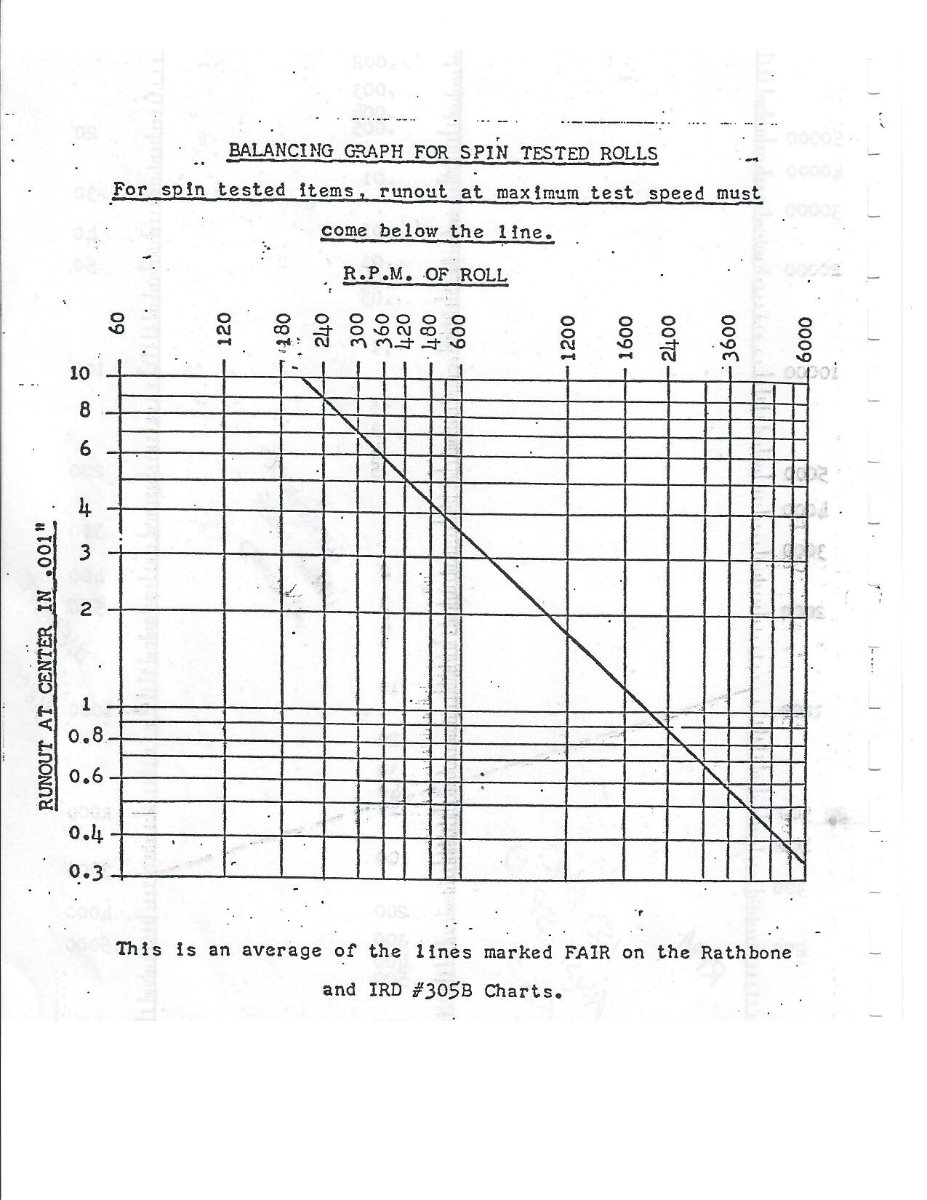

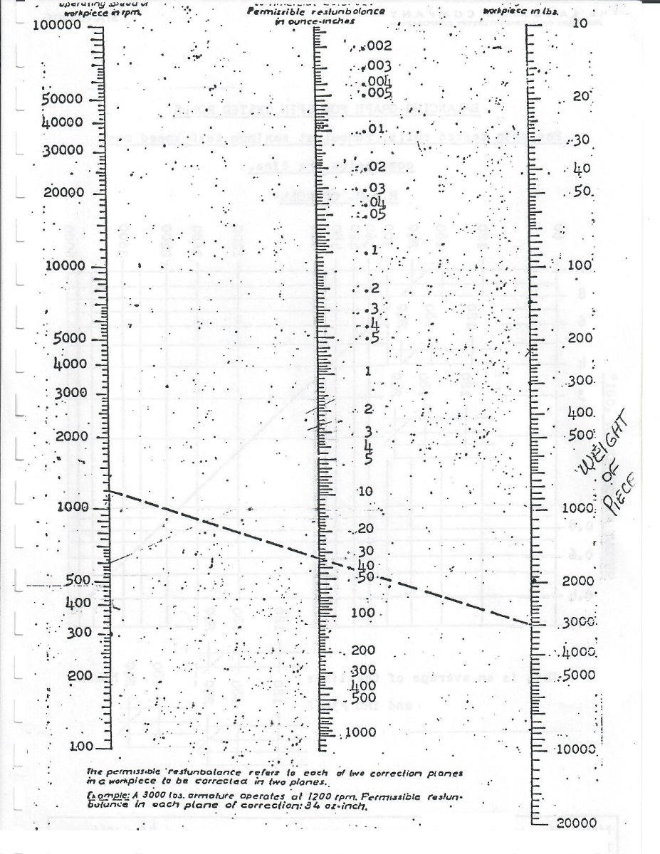

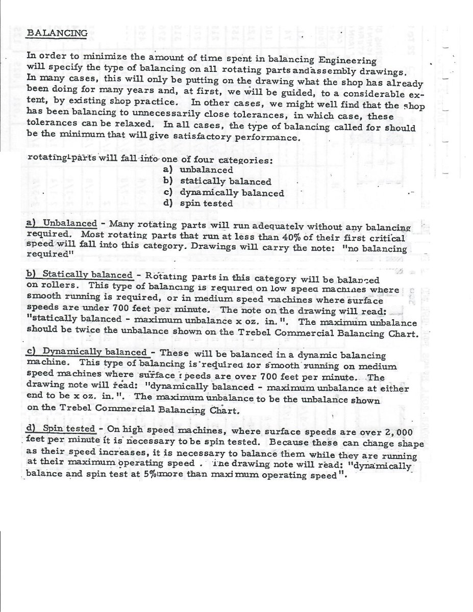

One of my other hobbies is industrial anthropology through the years. When we look back on something...I like to put on the mindset of the 'then' and try to think things through.
What most do not realize is that often time in that era it was not individual mental power, but collaborative notes reduced to consensus 'black books'. (How many of you 70+ guys in engineering remeber the white hairs of your youth having this 'book' that was usually under lock and key?)
I collect these books whenever possible as a few always escape the farm and I'm amazed at some of the instruction sets found from time to time.
Just for kicks because Dan mentioned computer aided decisions...I was going to post a 'nomogram' of how balancing worked in those good old days when the most sophisticated calculator was a slide-rule....then decided to post the section for an old line manufacturing company view towards 'balance'
Not to take anything away from previous posters...I'm in favor of spin balancing of all if you have access to it 'cheap'....also obsessive compulsive to static balancing anything else-just because

I use the Sunstrand balancer like Richard posted above - flywheels I balance - drums not so much unless the customer expresses interest and $'s !
