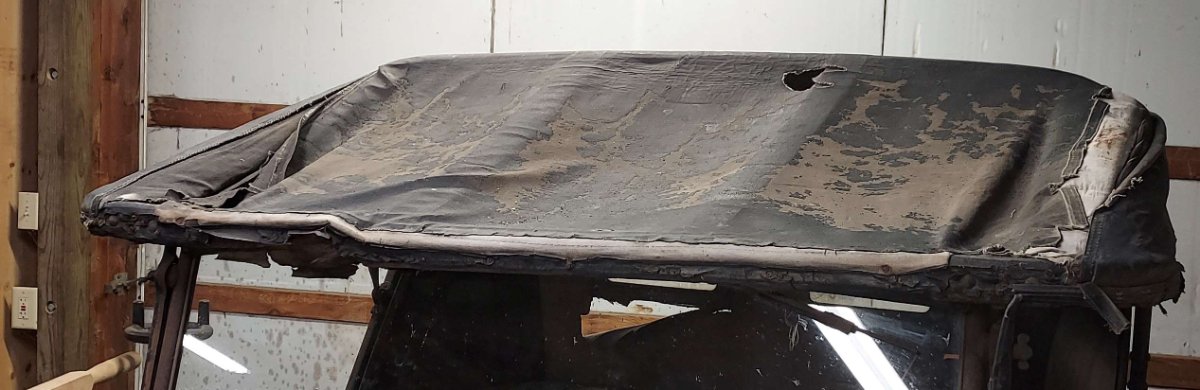

Are the top bows on a 1924 touring supposed to be flat or have a slight upward bow in the middle? The old ones are arched and the new ones purchased are flat. Just wondered which is correct?

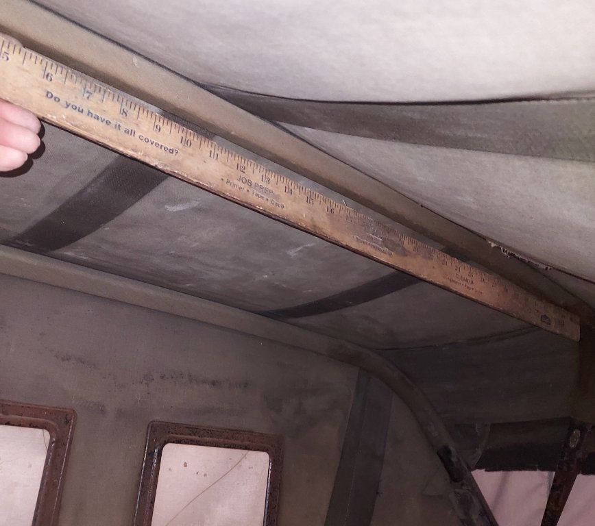

I thought it was flat, but checking my original 1924 runabout top, it has a slight curve.

That’s about the same as my old ones but the new ones are as flat as can be!

I would suggest throwing away the new flat ones and either reuse the old bows if sound, or make new ones that are correct. Many reproduction model T parts available today are made by reverse engineering or a best guess, and so some end up being just plain wrong. I have gone to the Benson Ford Research Center in Dearborn Michigan and made copies of the Ford factory drawings to make new wood for my 26 coupe. Sometimes a best guess isn't good enough. You have to ask yourself if 3/4" or so bow is necessary before you go to the time and expense of replacing the top on your car.
I have thought some beautifully restored cars had tops that didnt look quite right, almost a sunken appearance, and I must admit that until now I never really could put my finger on it. Now I know it is because the reproduction bows are flat.
