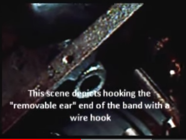

This appears to be an old video and pictures are dark, but the bands are pulled through to the pedal side where the ear is attached
https://www.youtube.com/watch?v=CwVydOu-QJQ --
The quick change bands were designed so the bands could be removed replaced through the transmission cover. So doesn't it make sense that the removable ear side be on the pedal side to clear the various pedal supports using the "band tool". No comments on the band tool please.

Re: Quick Change Bands
The video got me to scratch my head. Its a right hand drive T.
Still the removable ears are installed on the correct left side.
