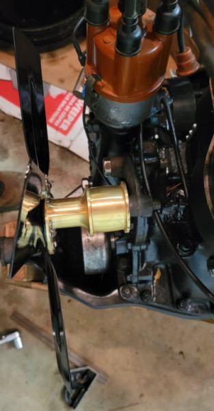

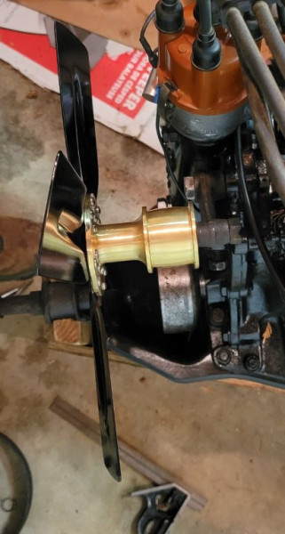

My wife's speedster has a '26 block with a Frontenac overhead, a A Bosch front plate distributor, a water pump, and Livingston V radiator. It has a '20-'25 aluminum hub fan with blades that have been cut down to fit behind the radiator.
I want to eliminate the water pump and the fan that throw grease all over the front of the engine.
I bought Lang's ball bearing bra$$ hub fan and installed the proper bracket, but the early fan pulley does not line up with the '20-'27 crankshaft pulley. The late crankshaft pulley protrudes farther out from the block: than the early crankshaft pulley: If I mount the fan bracket backwards, the pulleys look like they will line up:
So, I'm looking for some input:
1) Shall I put it together with the fan bracket backwards? It will require special length belt, and the fan adjuster will not fit properly...
2) Shall I a put a spacer between the fan bracket and block? This will require fabricating a longer fan bracket bolt, a special length belt and the fan adjuster will not fit property...
3) Shall I replace the late crankshaft pulley with the early type? This will put the back of the fan very close to the bell crank mechanism for the spark advance and retard...
4) Or something that I have not considered?

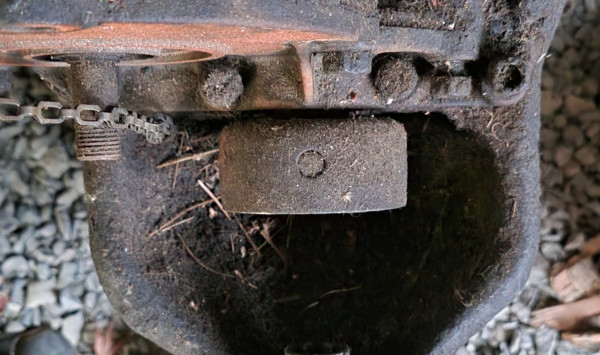

Keith, unless my eyes are deceiving me, you have another problem. Your second photo shows the fan pulley is also out of line in that it is not oriented on a parallel axis to the crankshaft. This indicates that the fan arm is bent. To get the belt tracking correctly, any setup needs to have the fan shaft and crankshaft in parallel.

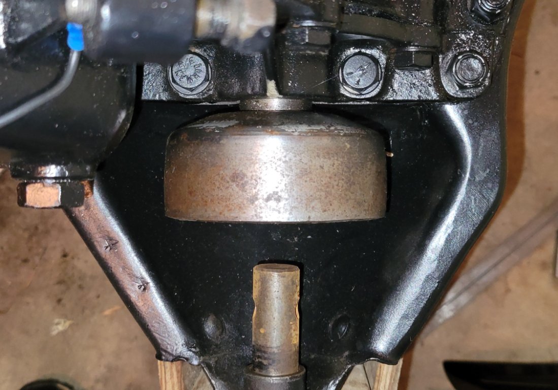

Then I looked at the fifth photo, and fan pulley does not look so out of line. Perhaps the angle of the second photo threw me off.
