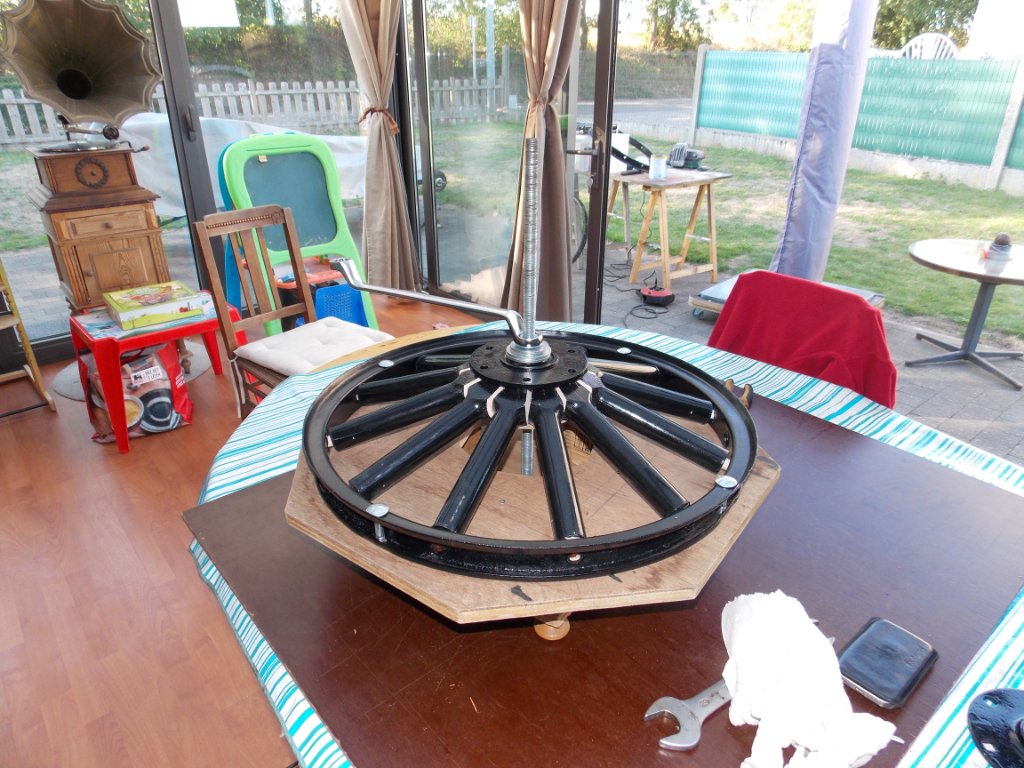

Post by AndreFordT » Mon Jan 31, 2022 5:28 am

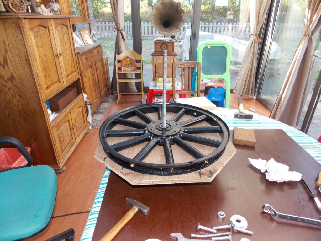

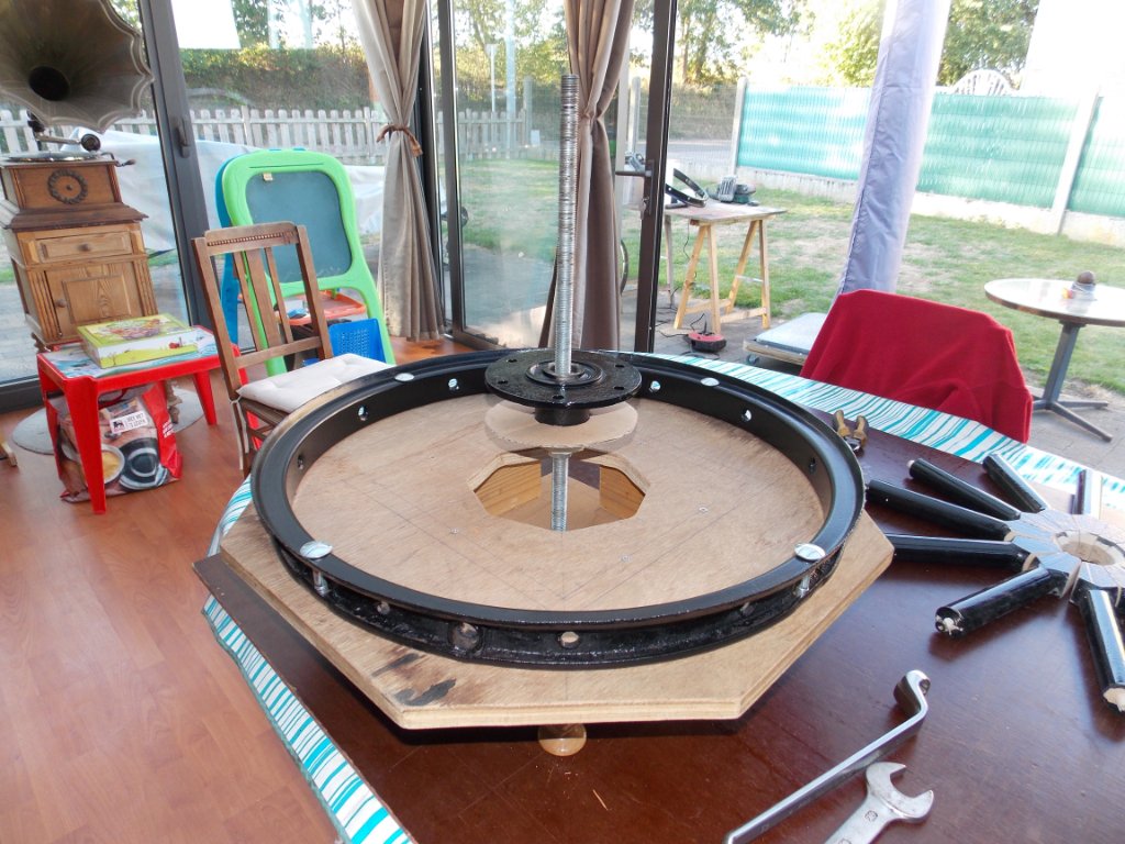

George,
I changed the concept a little by adding a flat table on top of it. During the wheel assembly I press till the spokes are flat with the table.
Good luck
Andre

I like andres suggestion of having a flat board under the wheel. Has anyone else tried this method?

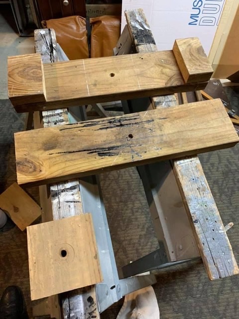

Post by Ned L » Wed Feb 02, 2022 11:42 pm

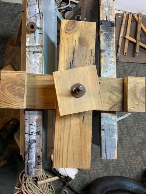

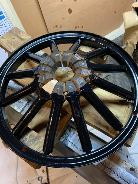

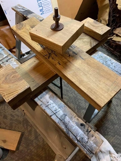

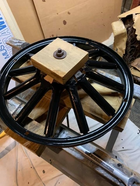

I needed to press only one wheel back together after changing out a bad spoke and came up with a very simple design that worked just fine for me.
The pictures are out of sequence, but I think the idea comes across.
