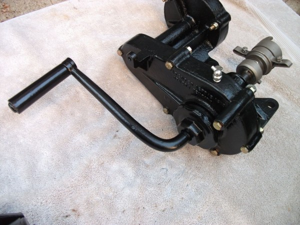

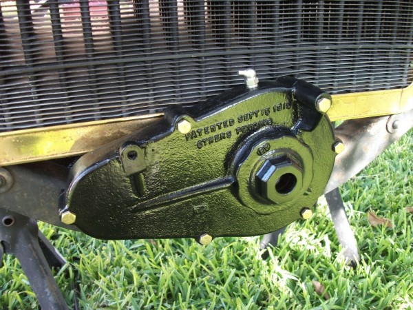

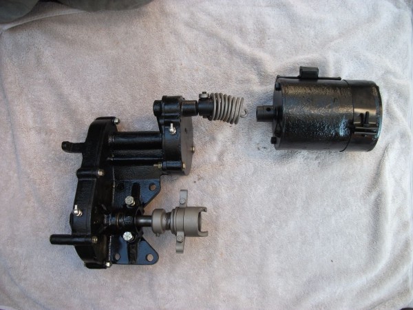

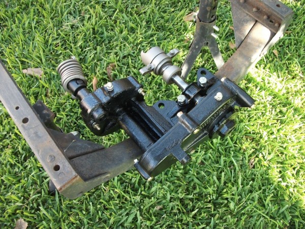

These are some pictures of the accessory starter setup. The starter motor mounts to the frame rail and the engine pan. The manual crank handle can be removed when not being used. The patent date (Sept 15, 1915) can be seen on the housing in front of the radiator.
Hope these help.
Hope these help.

As Lyndon tried, I too gave it the old college try and also came up blank.
I have some serious doubts for a number of other reasons specifically Vincent Bendix was right in the middle of flooding the patent office with everything related to a 'bendix spring' return or a centrifugal release gear starting within the prior year and at the time patents had to be totally secret in development up to and including priority date (filing date) and no one even knew what part was patented until actual issue date and then only knew if they subscribed to a clip service who read the Gazette of issued patents from cover to cover each issue before clipping.
For what it is worth, it apparently took most of Vincent Bendix patent applications years to issue which is a signal that they were passed back and forth to the patent examiner, rejection or clarification request one after the other, with perhaps Bendix also dragging his feet. This was common in the era as once 'filed' you were free to commercialize the idea under pending federal protection...yet the actual patent life meter did not start running until the actual issue date.
Your example has a cast in Patented date yet no maker mark. Your photo also shows 'other patents pending'.
Lyndon already commented that no issue date lines up with the date quoted and even searching for that week yields no results related to such a mechanism.
I think you perhaps have a red herring, a deliberate red herring, perhaps put forth by Vincent Bendix himself as common practice was to place 'patent pending' on a device from the day the patent was filed even if disclosing manufacturer name. No way for competition to check the accuracy, they had to wait often years to find what the heck might actually be patented, yet fully at law be liable for royalties due backwards when the patent finally did issue and they got caught following making a reverse engineering derivative of what they 'saw'. So that part could be true..Vincent Bendix had more than a couple of applications at the patent office at the time. The date? Possibly a bit gray as to legality, yet at the same time would have a wannabe copycat forced to pay a lawyer good money to chase a Gazette posting that never existed in the first place.
It was a time people litigated for different reasons than today. Folks like Vincent Bendix felt they were the Prince of the technology with all rights and privileges of dollars to follow. As a small aside, Bendix went on to spend years, even decades, chasing folks he thought infringed on his 'ideas' that became his patents...he usually won threatening deep pockets litigation...and since he had extreme lengths of time usually between filed and issued dates for his own patents...the actual bill due for loss in a suit would be worth more than the book value of the company found infringing. Vincent built a whole corporation by consolidating company's who he would litigate against for lost rights, present the bill for catch up fees, and agree to take over the stock of the company as payment in full. Genius, eh? Some might say Capitalism gone amok but that all was the frame of mind at the time.
- Posts: 5172
Re: Patent Search Help
That's one nifty accessory starter !!!

Your starter unit was made by A.B.C. Starter Co. in Detroit. It should include a belt driven generator, but if you do not have it, that would be easy to fabricate. I hope these scans will help.
1922 Coupe , 1926 Touring
