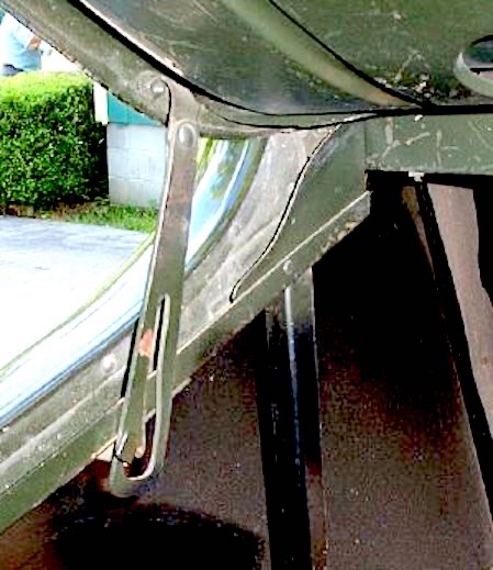

Post by DanTreace » Wed Feb 02, 2022 2:07 pm
Took this photo of another's '27 Coupe, close up of that deck support. May help your construction.
