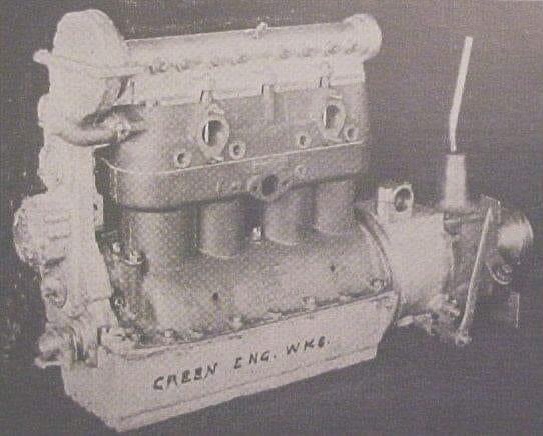

Shane Lach
Posts: 246
First Name: Shane
Last Name: Lach
Location: Milford, NH
Re: Fronty S-R and Green Engineering Equipped Racing Engines
Post by Shane Lach » Wed Feb 02, 2022 6:42 pm
Unfortunately this is all I have. Tim Moore May shed some light on this.
David Greenlees
Posts: 173
Joined: Wed Feb 02, 2022 1:18 pm
First Name: David
Last Name: Greenlees
* REQUIRED* Type and Year of Model Ts owned: 1915 Model T racing car, 1924 Model T Depot Hack with original York #803 body.
Location: Brattleboro, VT
Post by David Greenlees » Wed Feb 02, 2022 7:29 pm
Shane Lach, Thanks for posting that photo, I'm always delighted to see any Green Engineering photos and hope others will post anything they have on the subject.
The engine we have is an L-head racing engine which is sleeved down to 4-7/16" like what is see in this ad copy and has an identical light weight 1-3/4" racing valve with larger stiffer springs. I recently saw one of these flathead engines in a Green "Super Ford" racing car illustration.
Green also offered an identical head with a larger combustion chamber for use on a standard Ford engine. I'll post more photos tomorrow.

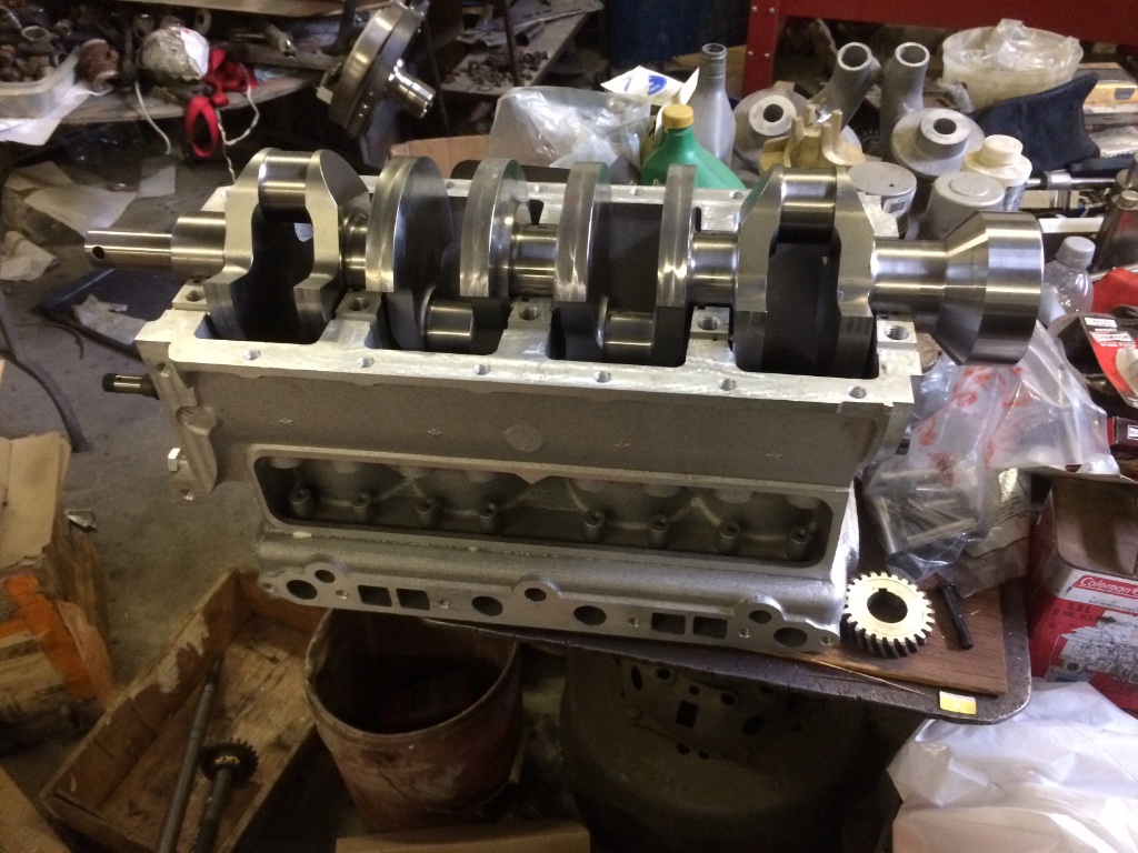

Post by David Greenlees » Thu Feb 03, 2022 4:53 pm
This view of the right side of the block shows the rectangular openings to the intake posts which match up with the rectangular intake manifolds in the photo below.
The rest of these photos show the complex added Green cooling system: The outside of the sleeves are shaped somewhat like the outside of an old wooden spool of thread with "flat rims" top and bottom. In between top-to-bottom, extra added water flows in from the holes in the bottom of the outer cylinder wall and cools of most of the length of the sleeve just like modern cylinder walls are, for even cooling without distorted cylinder walls when up to temp and running. This leads to a better piston ring seal and less scuffing of the cylinders and piston and the result is added power.
This may only add a a few extra HP but it all adds up and can be the difference between winning and losing a race. "Pop" Green was a brilliant engineer and it shows in the designs he came up with and his shop built and sold to racers.
There are cutouts near the top of the sleeves thru the original cylinder wall to let the added sleeve cooling water back into the water jackets. This one is at the back of the block and there are similar holes in the other three cylinders. Look down into the water jacket to see it.
View of the sleeves and the bored out ports for the large 1-3/4" valves. Note the narrow 1/16" wide racing valve seats.
Four holes for extra cooling water are visible at the bottom of the cylinders. There are also two large inspection holes tapped for inspection plugs. The three holes halfway up the crankcase wall are for a fitting that introduces pressurized oil from the oil pump to the center and rear main bearings. One more identical hole in the front of the crankcase wall supplies oil to the front main bearing.
And finally, this is one of the holes for the extra added cooling water, and the gap between the original cylinder wall and the sleeve is visible.
Has anyone seen this same set of pattern of holes for the oil and water feeds on the left side of the block on a Green engine before?

Post by David Greenlees » Fri Feb 04, 2022 7:10 pm
The block and the main bearings and caps are now cleaned up and here's a view of the bottom end.
The manganese bronze bearing caps and the thin period babbitt is in good condition with no cracks, is bonded well with the caps and useable as is.
View of the cam - intake lobe on the left, exhaust on the right, note the different nose profiles; the lift on both is .312"
The valves are lightweight racing pieces and the 1-3/4" head is only 1/8" thick. The left-hand spring is original NOS Ford, one of the racing springs on the right. Retainers are lightweight 1/16" thick stamped steel.
Last edited by David Greenlees on Fri Feb 04, 2022 10:59 pm, edited 3 times in total.

I am surprised at the lack of “counterweights “ on the crankshaft. It wouldn’t take a lot of machining to accomplish.

Cleaned up and inspected the deck, valve ports, and the cylinder bores today and both are in good condition and restorable. This overhead shot really gives a graphic view of the valve to bore size relationship which appears to be one of the reasons why Green got 70 or 100 HP w/a supercharger out of these small 122 CI flathead engine at 6,000 RPM because it could breathe so well.
Green attributed the lighter weight of the smaller piston and lightweight Ford rods or his Aluminite rods as being a part of the package that allowed it to rev up to 6,000 rpm; he also stated that the lower reciprocating weight of both lead to longer bearing life. Green's head itself weighed less than half of the weight of the complicated OHV and SOHC and DOHC heads on the market and being 30 to 50 or more pounds lighter than other Ford race cars was a definite advantage on the track.
Green and Arthur Chevrolet were both were fans of using the very strong and light Ford rods, which the later stated would not break under the stress of racing. That and using a very thin layer of babbitt added to bearing life which was important in the days of poured bearings. The set of bored out rods in this engine have been babbitted and bored to 1.375 (1-3/8") and balanced.
Read an interesting article about the the amazing Kay Fleischmann Special AAA 122 CI Ford-powered racing car @ https://theoldmotor.com/?p=99626. It has a Green Supercharger and more information and photos of them can be found there.
One thing I don't have for this engine is the ultra high compression squish patten Green Power-Plus racing head above. It's unlikely I'll find one since anything made by Green is very rare, so maybe modified and milled high compression repro alloy flathead will have to be used? The photo below contains the standard Green Power-Plus head. I also have a Fronty S-R engine as well as a spare head, and one of the S-R heads with high compressions pistons is an option, as well as a Rajo BBR racing head, so there are also other ways to go here.

Found an article in the Motor Age December 12, 1918, issue showing the shape of an earlier Green Ford head combustion chamber design.
And a better photo of the bottom end.
