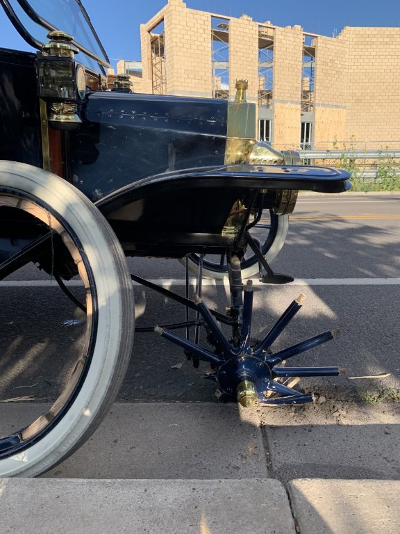

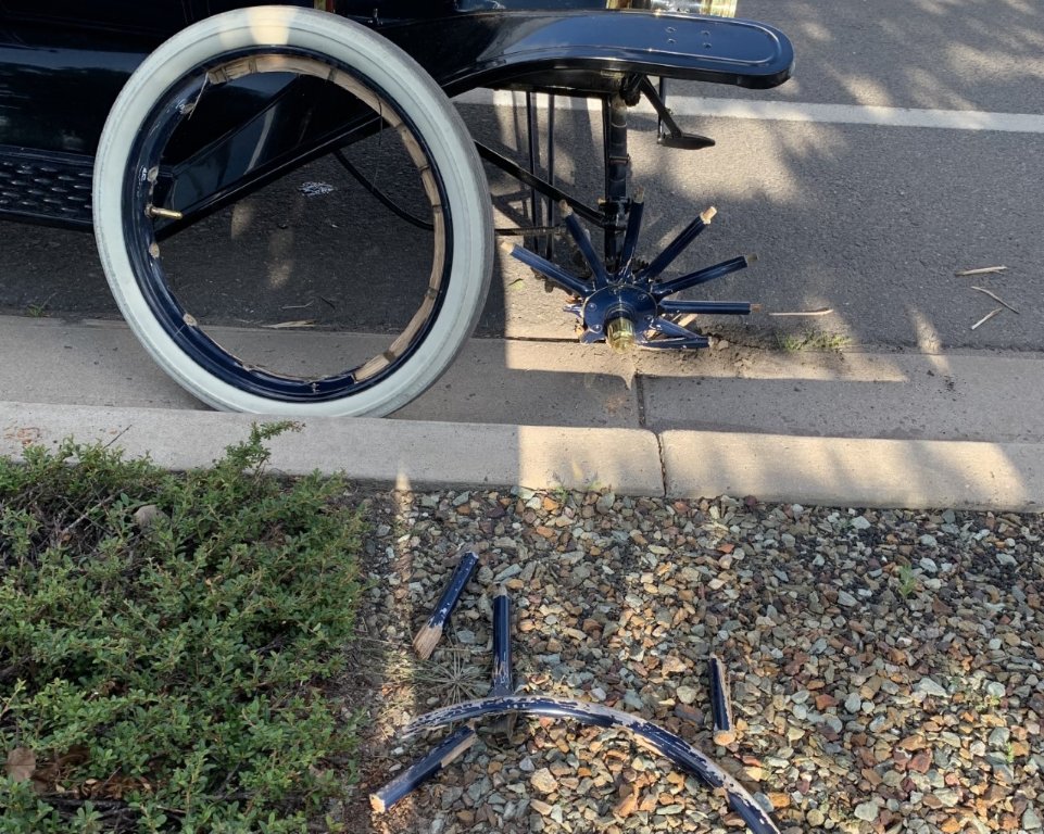

Ben, Please have your wood felloe wheels rebuilt. Here are a couple of photos of what happened to an original wheel that had a loose felloe. The restorer (not me) screwed the felloe to the rim along with the rivets. The wood was original and looked good, but was filled with wood filler to make the wheel smooth. Upon making a slow left turn, the wheel exploded. After taking all of the wood from every wheel, I observed that the previous owner had made the wheels look good, but had not made them safe. The four wheels on this car have been sent to Noah Stutzman for rewooding. I urge you to have your wheels redone by a reputable wheelwright. I highly recommend Stutzman's Wheel Shop in Baltic, OH. Your safety is worth MUCH more than the cost of four rewooded wheels!!! I hope this helps. Russ Furstnow

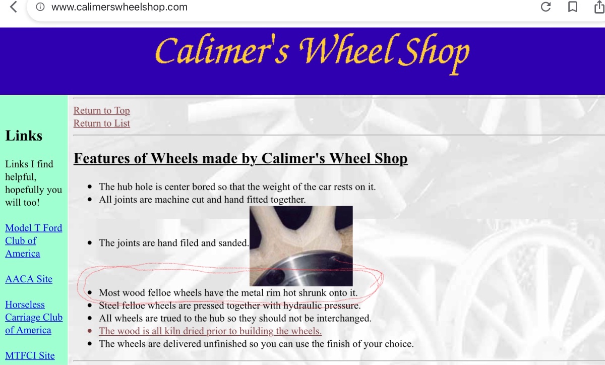

That rim is heated and shrunk onto the felloe
That is the better method, shrink the rim to the felloe, then rivet for added security. Having Calimer’s do a set of 30 x 3 fronts for me now, pickup in Luray.
Am confident with my experience of inspecting a T wood wheel for safety, but aren’t confident , since no experience , of repairing a wood T wheel.
That where the skilled 35 years in making wood T wheels business makes me confident of what I, wife, and friends are riding on.
