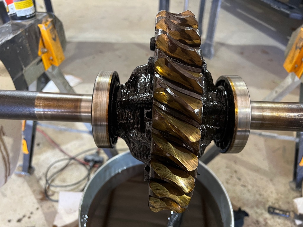

So my project to address leaking axle seals may have morphed into a bigger project. I removed the rear end from my 1924 TT to address the inner oil seals which I knew were bad. I had patched things together last year by replacing the inner and out bearing seals but knew that I was getting differential oil down the axle housing to the bearings. I got the rear end apart and following the MFTCA Ruxtell/Rear End booklet started inspecting various components. First I found that the right side axle is worn down to 1.610 and the book says maximum wear from original is 1.620. Then I noted a small spall in the worm gear. Wear is not bad and the ring gear does not appear to have any abnormal wear patterns from the spall even thought it is in the middle of the gear and on the forward thrust surface. For you TT experts, any thought on a source for a replacement axle and whether the worm spall is a major concern? I would love to upgrade to high speed gears but have not found any available in recent times.

I would recommend replacing that worm, but then again if its all you have I would probably use it ad 'close my ears' to noises. The crown wheel looks past its best date as well.
There was a chap in Texas I think who was making new high speed crown wheels and worms. Sorry i don't recall the details but someone here may be bale to help.
Those axles will always leak. You could try to find a modern neoprene seal with a smaller inside diameter. It may be possible, but the better solution is to change the axles.
The issue is that the bearings have most likely worn through the hardened outside of the axle, so wear is only going to get worse.
Or perhaps a request here on the forum my unearth some gears and axles - I am sure our members have more than 1 stored away. I would be happy to help you but freight from New Zealand would probably be enough buy you a whole new TT ...

Thanks for all of the replies. I think I have found a good worm gear. No joy yet on the axle so may just put back together and make sure its well greased. Through researching on this forum, I got connected with Tom at Model A Works and he has a set of properly sized felts coming for the inside seals and the driveshaft. I know they won’t perfectly seal it up but they will be a lot better than what I found when I got her open ie essentially disintegrated. Here she is last summer at the Texas State Railroad.
