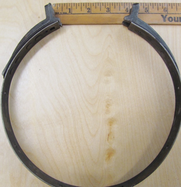

Good plan to make or use a mandrel to shape those bands. Many times they can be twisted out of shape and most times the ears are too far apart from over-bending to get into or out through inspection cover opening .
When you get final straightness, then check to be sure the band ears are approx. 4" apart.
IMG_9798 (2).jpg (92.27 KiB) Viewed 3375 times
Typical stretched apart bands.
drum mandrel for bands.jpg (109.36 KiB) Viewed 3375 times
Mandrel fitted band, shaped carefully with small mallet blows to get round shape, pulling ears tightly around the drum and tapping to get lug ears spacing correct.

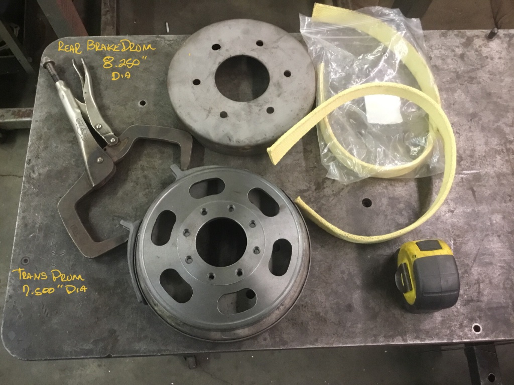

This is how I repair the steel transmission drum bands
All that’s needed is rear brake drum. Two can be used, stacked on top of each other, when working on the wide brake drum but I don’t find the need often.
C clamp locking type vise grip and some heat. Place the band around the brake drum and use the vise grip to pull the band tight. Not a lot of pressure is required. Starting at one of the ears heat the band to a dull red with a torch and work to the other ear.
Easy to do. Try it you may like it.
