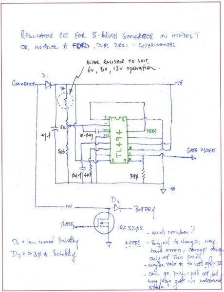

This post is intended as a gentle enquiry around voltage regulators for Model T and Model A Ford generators. It is not about 'cutouts' which are another thing altogether.
As most will know the generators in these machines are a three-brush current-set device. They will tend to charge a battery at a constant current regardless of voltage (ie. you can use a 6V or 12V battery with no appreciable difference to charge rate).
This is problematic for most modern batteries, they do not like to be over charged, it will shorten their life. Equally they don't like being under-charged and flattened. It's difficult with the constant-current generators to strike a happy medium, in particular if you use the vehicle with lights at odd times; a low current output might be fine for daytime driving and minimal starter use, but add in headlamps and more regular starting with short trips and the battery could quickly become 'flat'. If you compensate by having a high charge current set it, and don't use the lights for a while and/or go on a longer trip you could 'cook' the aforesaid battery.
These issues are addressed by using a voltage regulator. This ensures that the battery is charged to a particular voltage, and the current input to the battery is reduced to a minimal level once that voltage is attained. Most cars use a regulator.
Without wanting to complicate things regulators come in two basic forms. Most are a simple series regulator that, essentially, disconnects the generator output when sufficient charge/voltage is attained. Unfortunately the T & A generator is further unique in that it cannot be successfully run without a load - it will destroy itself over time - which means a series regulator cannot be used. Thus the regulator that should be used for a T or A generator is a shunt regulator, one that will provide a load (ie. a short) whenever the correct voltage is attained.
That's the system theory out of the way, now to the nub of the issue.
As I understand it 'Fun Projects' used to produce a regulator suitable for a Model T or Model A. However 'Fun Projects' were sold and from various posts I've seen they no longer produce these regulators, and there's been no reasonable alternative (please correct me if I'm wrong!)?
Despite this the occasional post, sometimes including a circuit, around producing a regulator design has met with some admonishment. The issue, as I take it, is that people have spent some time and money in producing a product, and if someone was to offer a 'free' design then others might take that and commercialise it, leading to a reduced income for the earlier manufacturers.
As a result of this, and as a personal matter of courtesy, I'd not furthered things with regard to an open-source voltage regulator (or indeed my electronic ignition system), however in latter months I've had several enquiries and have been persuaded to put the issue up here for comment.
Electronically it's not a particularly difficult thing to design a suitable shunt regulator, however it would require someone to lay that out to a PCB (Matt?), which could then be produced, preferably with components fitted, by the various houses that do such things - or even made at home. At this point I suggest the component cost per completed board would be likely to be less than $20; the design would be open-source and discussed here in public, as would hopefully the PCB layout.
So, I'm absolutely not wanting to start any wars, please, but firstly I'm wondering if there's an appetite for an inexpensive voltage regulator board that could be fitted into an existing cutout tin, or some other container? Secondly, what do people think about alternate (particularly 'free') designs for such things? Is it ok to do this, or is it morally reprehensible?

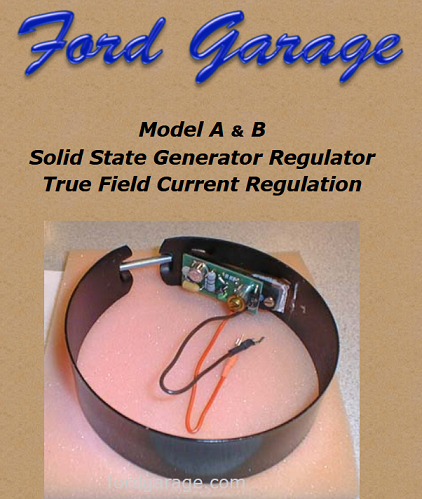

In the Model A world alternate voltage regulators are available. In addition to using Fun Projects I have Tom Wesenberg’s internal regulators installed on two Model As. Tom offers three 6 volt designs which feature field regulation versus the Fun Projects shunt design. Two of the boards he sells are for the 3 and 5 brush Powerhouse generators. The Wesenberg design bolts to the brush plate and is undetectable. Tom recommends an original mechanical cutout be used but he also provides a shunt that can be cut in order to use a diode cutout.
If we are to consider a new voltage regulator for our Ts, internal field regulation may be another opportunity.

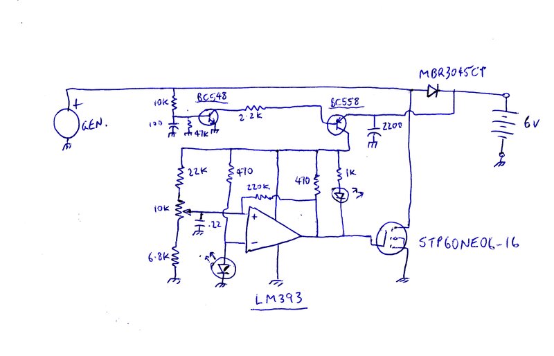

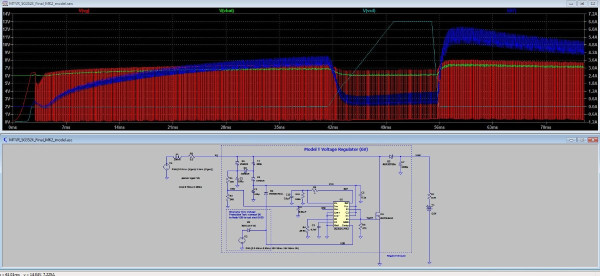

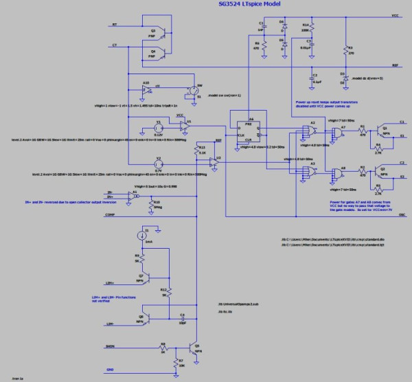

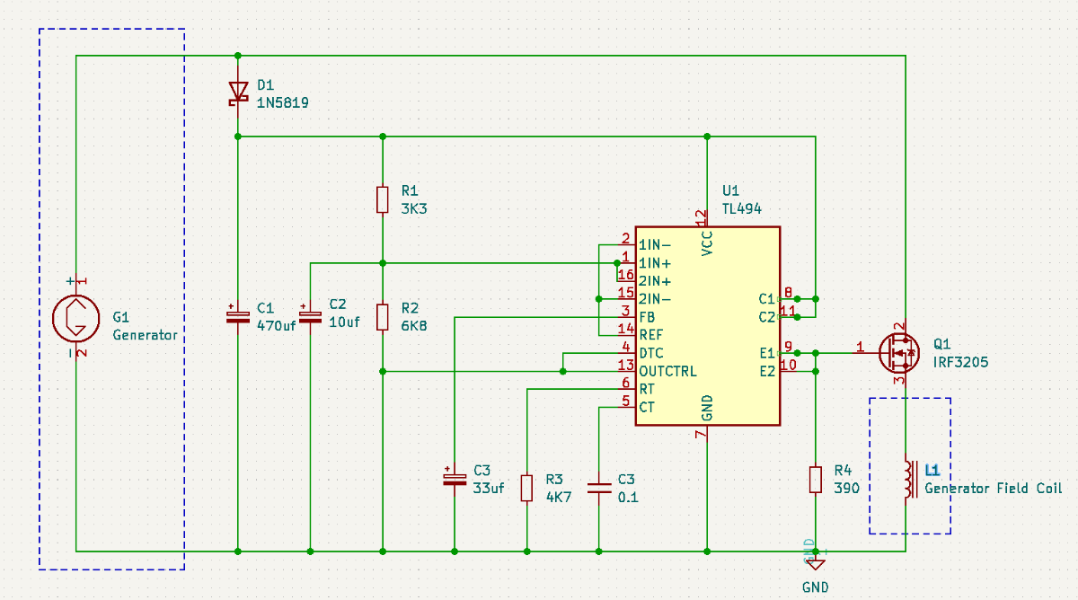

Ah great minds think alike. The lack of parts either through obsolecsence or supply chain issues have decreased availability and increased the demand for the Model T voltage regulator so it seems its time for alternate designs to be considered. I too have begun working on another version. The conscept is very simple as Luke eludes but the devil is in the details. I started with John H's design and created a spice model for the SG3524:
Then created a simple simulation model to better understand and optimize performance:
All works as expected. An error voltage is applied, VSD, to simulate high generator output and the circuit responds as desired, grounding the generator with increasing duty cycle to prevent over sharging the battery.
The next step was to devise a closed loop model of the generator voltage regulator control system using behavioral sources that function similar the actual Model T generator and therein begin the challanges. The accuracy of the generator model is key to determining how well the overall voltage regulator model reflects reality. It is a control loop so the gain, feedback, dampining and stability are all important parameters that must be properly designed and verified over all operating conditions or the voltage regulator circuit can begin to oscillate and function in undesirable ways. I came to the conclusion that a Model T generator test stand would be necessary to actually characterize the true behavior of the generator and its interaction with the voltage regulator. I attempted to purchase a generator test stand but they are sparce so started to build my own complete with variable speed, constant torque DC motor so the Model T generator and voltage regulator can be accurately characterized at any engine speed. Wating for my rebuilt Model T generator to arrive to complete the test stand and begin characterization. My goal was to create a robust design capable of fitting within the original Model T cutout housing but do not plan on making a finished product and all the tooling and work that goes into it. Not sure how useful that approach would be, there are electromechanical skills necessary to complete the cutout conversion from original form to connect, mount and house the modern voltage regulator within the stock cutout housing. Another aproach would be provide an assembled PC board with screw terminals for easy connection to the generator input, battery output and ground wires that would simplify the interconnect and leave it to the owner to figure out how to house and where to mount the voltage regulator. That approach would be sure to upset the purists but at least it would be an option. For now, I am just interested in figuring out a solid robust design that performs well, is efficient, stable and reliable.

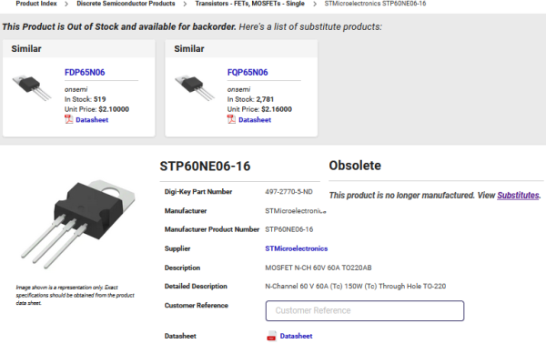

I toyed with this, using zener diodes of very specific value.
A supply chain issue quickly surfaced.

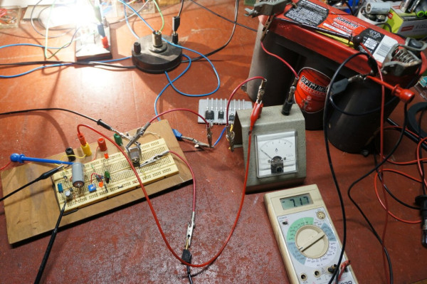

Mike, as always great technical input, thanks. We're lucky to have a generator test stand here as another forum member built one a while ago - he doesn't know it yet but I'd hoped to utilise that for some testing

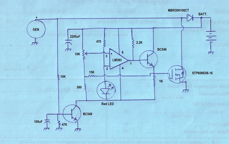

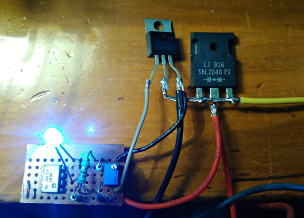

John, thanks for putting up your design. I do like its simplicity and easy-to-get components, and it's easily adjustable which I see as useful.

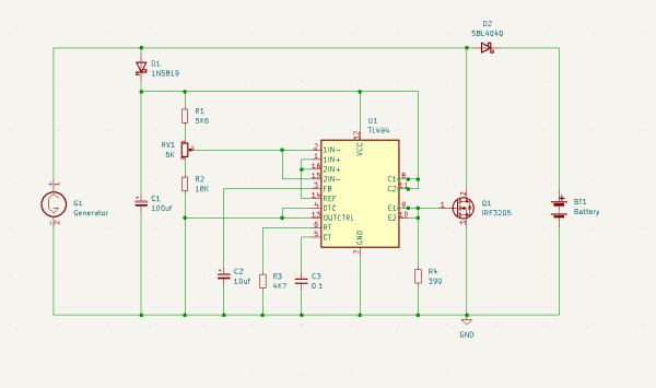

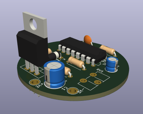

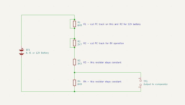

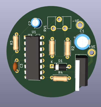

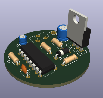

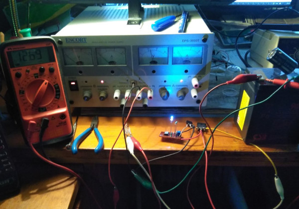

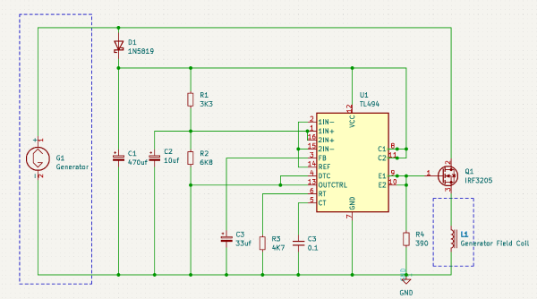

Now, just to follow on from Mike and John's designs, and to add further to the mix; the design I initially had in mind uses a TL494 (https://www.onsemi.com/pdf/datasheet/tl494-d.pdf), which would have to be one of the most common such IC's in the world, so there shouldn't be sourcing issues. Many computer PSU's have them (and often a useful schottky diode), which could mean a good source of 'trial' components for testing, and circuit design detail is plentiful.
So, it looks as if there's a few possible designs from the electrical perspective, and some testing that's gone on. Mike raises a good question around how such a thing should be produced, and mechanically fitted/housed - what comments do people have on that I wonder?

- Posts: 6581
Re: A $20 (or less!) DIY regulator, and other issues
Found this..... FOR POSITIVE GROUND NIT FOR MODEL T
http://www.fordgarage.com/pages/generator.htm <-more useful design information in the link towards the bottom
This is James Peterson's solid state voltage and current regulator for use with an original generator, in combination with a solid state power diode cutout. I also like the Ford/New Holland 6 Volt 9N/8N Tractor Battery.
This is the 'true' voltage regulator.. It works on 6V positive ground systems.
It provides true solid state output voltage and current regulation by means of sensing battery voltage and output current load, and by continuously varying the field strength (via input field current directly) to maintain the correct level of generator voltage and current output. It 'electronically replaces' the original movable third brush function on original generators and retains all the original generator appearance.

Pat, I wonder if you have one of these Delco regulators, or could get one?
To the best of my knowledge they won't be easy to obtain here in NZ, so it's likely to be more straightforward for you to trial there. If it were to work well do you know if the supply is plentiful?
For my part I've obtained some comparators, and already have a TL494 from an old PC PSU so I'm going to do some initial testing with them. There's no reason why we couldn't have two different regulator designs so if the Delco idea works that'll suit those that want to regulate the field easily, and perhaps whatever design we come up here with will do for those who aren't keen to get inside their generator.
JohnH; I spent some time going over different possibilities with a colleague yesterday, and we both liked the elegance of your design. After some discussion I've now got a LM311 (thanks Robert) to experiment with because I suspect we can do away with the driver transistor and bias resistor, making things even simpler than with the 393. However it's a high gain device that could be affected by the electrically noisy T, so it'll need some thorough testing.
The owner of the gen test set won't be back here until next week sometime, so we can't begin working with that at least 'till then, however I hope to have time to solder something up and test that with a bench PSU and 6V + 12V battery first.

Luke, it should be possible to eliminate the driver transistor as you say - I only thought about this after I pulled apart my breadboard prototype so never got to try it! The website article was later updated with a theoretical speculation on how the simplification might be achieved.Luke wrote: ↑Thu Dec 09, 2021 2:39 pm
Luke,
A great idea to have an open club discussion. I am open to help design a board, but would like that to be more of help someone who is designing a board. From my experience with the FACT PCB I believe that there is more interest in someone building/selling a working part that requires little knowledge. In my opinion we could keep the design open but allow anyone to build and sell with some compensation for their time.
Since we are brain storming, here are some half baked ideas:

Well it might be more like the unit is brought out to the test bed. All the resultant brain activity might require a good serving of pineapple and ice-creamA Whiteman wrote: ↑Fri Dec 10, 2021 3:57 amHmm, a local member may be persuaded to lend his test bed, I will ask him nicely for you![]()
JohnH, thanks, I'm looking at all the components I need right now sitting on the desk in front of me, might have a chance to assemble something over the weekend and see how it goes in practice (sans the BC548's).
Matt, good to hear re the PCB layout. I suspect the buck/boost units you have would suffer from the same issue as Frank's (described shortly). However they are useful devices, I have a handful of them here in different capacities, one is presently running a 24V fridge from a 12V solar system. Otherwise see my comments re a trial I'm going to carry out - if that works ok are you up for testing one yourself?
Frank, thanks for the info but that's essentially a series regulator. The T & A generators require a shunt regulator (ie. short the output to shut them down rather than disconnect it), unfortunately a series regulator - which is much more common - would cause them to fail. A shame 'cos there'd be so many options if it weren't for that.
Anyway, as mentioned above I've got some components to assemble to a modified form of JohnH's circuit, what I suggest is that we have a look at that first and see how it performs on the bench? If it's promising it sounds as if Adrian's genset will be available for further testing, after which we should have a better idea as to whether it's likely to be a viable option.

Some progress to report:
I think it's reasonable to say that most people are happy that we go ahead with this as a community project. The essence of it would be that the design and PCB layout should be open-source and free for people to make or modify as they wish, and that there may be an option for someone to manufacture boards with components on for people to install at their leisure. Such boards could be produced by an individual, by a group of people, and/or by a club.
Off-forum there's been some discussion between Mike K, John H and myself about design, and some other things around how best to get this to a stage where it's useable for as many people as possible. This would include multi-voltage, and potentially -ve and +ve earth ability (or instructions on how to change to -ve earth [easy!]), and ways to make it easy to construct or obtain built-up.
We're still working through that and as things evolve we'll put up some detail here, with regard to the latter 'production' phase Mike has been most helpful and generous, but first we want to discuss this with the MTFCA.
With regard to the design of a shunt regulator (as different from a field regulator) Mike has simulated John H's original design in SPICE and we've been working through various things as a result. I've built up a test unit (photo's to follow) and I think John is also going to do the same. This will be an iterative process, it's not going to work perfectly first time (it hasn't already - I've had smoke
), and we may even end up with something completely different to how it's started out, but such is the nature of electronic design.
As a community project input is welcomed from all, and certainly if you're handy with a soldering iron etc it'd be great if you felt like testing things along the way
In terms of the fundamentals; there has been clear interest in a field-regulator. This has advantages and disadvantages, as has been discussed to some extent, and then there's the shunt regulator with its inherent good and 'bad' points. It would be difficult, I think, to run two projects simultaneously, already I've found myself responding to people thinking about one regulator when in fact the discussion should have been about the other. To that end Mike, John and I are going to concentrate on one regulator type at this point, and for various reasons that will be a shunt regulator. Mostly this is because it would be a very easy unit for people to install and wouldn't require any removal and/or dismantling of the generator, this would also, hopefully, mean it less likely to end with smoke being let out of something.
This doesn't preclude discussion or construction etc of a field regulator. Who knows, we may even end up there as a single project, but at this stage we'd like to start the prototyping at least with a shunt regulator.
So, from our discussions, here's a non-exhaustive list of things that we think would be good to set out. Please comment as you see fit!:
What do you think?
- Pursue a shunt regulator because it requires no modifications to the generator or car wiring
- Make it selectable for 6V, 8V, 10V or 12V applications
- Design for 10A maximum charge rate. This would decrease as the battery charges up to 'float' voltage
- Consider designing for -ve and +ve ground, but maybe just -ve ground if it becomes too difficult to do easily/economically
- End goal to be able to produce a PC board that, when fully assembled, would fit within a standard cutout housing
What do you think?

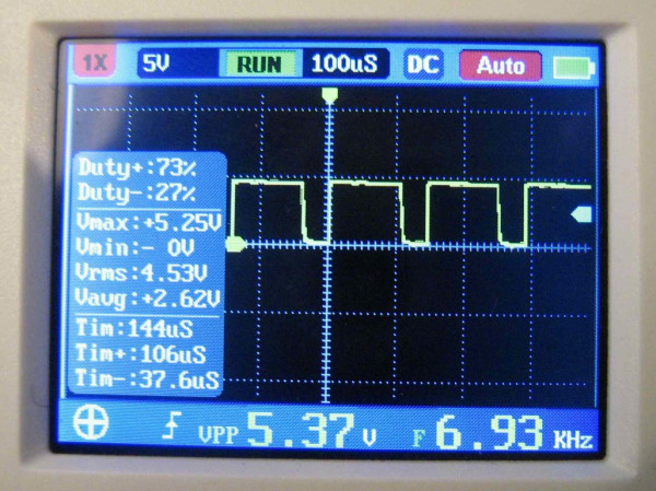

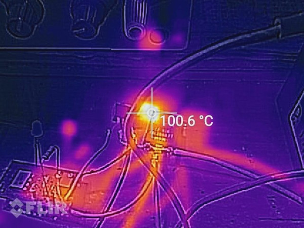

Luke
Topic author - Posts: 617
- First Name: Luke
- Last Name: P
- Location: New Zealand
Some photos of a prototype regulator I built up last night.
For this unit I've used 12V, mostly because I have a conveniently sized 12V SLA to use as the test battery. It should work on a 6V system just as well.
There are issues, as you'll see things are getting a bit hotter than one might expect, even without heatsinking, and I'm not convinced it's regulating as well as it could, nevertheless it's a start:

The max output for 6V is 16A (100W) and that can easy be needed if you have traditional bulbs in you headlamps (2 x 35W + 4 x 5 W = 90W)

Luke,
I love the progress. I like how this international project is coming together. I like the clean nice simple replacement design that fits in the old regulator housing. My thought is even if we all love this in 2022, in 30 years in might be like a Pinto Model T. It would be easier to use standard parts than find a replacements for a Pinto...
When you have a schematic let me know and I can help put it into the software for building the PCB. If you just are figuring out values for resistors, then I can move forward, we could always change out something like that in the future without changing the board design.
It is really simple to create a team using the software to build the schematic/PCB. (For my reference in the future: https://www.youtube.com/watch?v=aI2frXzm8EU) My thought would be have a small number of people (i.e. John, Luke, Mike and myself) able to edit the files. There are other companies that have similar services, but I have used this company and haven't had a issue. I believe the files generated are standard and could be made by any PCB manufacture.
After some improvement to my circuit which has been referred to previously, I've come up with something a lot better. A couple of things that Mike noticed, and some simplifications I'd had in mind have come to fruition in this version.
It's working well on the bench with a 6V Optima battery. After a bit more testing, I'll be ready to make a prototype for in car trials. The new circuit is here
https://www.cool386.com/regulator/rsz_regulator.jpg
It remains to be seen how well it works with the generator, rather than a simulated generator, and if there's any problems with ignition interference.

Jeff, yes it is switching at the wrong part of the curve, for some reason I'm not getting enough volts on the gate of the 3205. The 311 is higher gain than I'd like but was something available to me without having to wait for 4 weeks (and I wanted to experiment with the output - something not possible to the same extent with the 393), however it could be oscillating, leading to this issue. Unfortunately my 'scope met with a mishap (entirely not of my making
), making it a little harder to trace the issue, but I'm sure we'll get there.

While in theory, the 311 should drive the gate I have found that I often need a dedicated gate driver. And 100% agree on oscillation possibility. I always try to keep this stuff simple and then end up with 27 components I never wanted
I have a spare Tektronix 465 scope but not sure shipping would be worth it.

JohnH
- Posts: 377
- Last Name: Hunter
- Board Member Since: 2002
Allan, something along those lines has been done, but admittedly it's not just a plug in unit to take place of a 2 or 3 pin flasher can https://www.cool386.com/flasher/flasher.htm

Just a quick update for the technical minded following this thread. I've created three videos outlining the development of the unit which I will test on the car later today. They can be seen here https://www.youtube.com/watch?v=lO1u9mmLutk&t=1s
https://www.youtube.com/watch?v=pvCaxiRmzKM
https://www.youtube.com/watch?v=H1PyqnpTBdU
JohnH
- Posts: 377
- Last Name: Hunter
Today was the first test of the prototype in the car, and I'm pleased to report the prototype regulator is working very well so far. There seems to be no problem with ignition interference. Obviously, something that's to be put into production needs a few changes - fitting it into a cutout case being one priority. But, I'm very happy with the comparator method of shunt regulation. Here is the video of it operating https://youtu.be/gg1xN2KBOtg

Such a regulator is fairly tolerant of design changes, but in any event uses extremely common components. I doubt there'd be supply issues for many years to come.
I'm using an IRF3205 (HEXFET) for the current switching, these are reasonably common but there are plenty of others that would do as well. The bipolars are not critical, and the LM393N should be fine.
Having said that bear in mind this is quite early on in the prototyping phase, so the ultimate design could change - particularly given John E wants an output for the Nixie's he has fitted to his dash

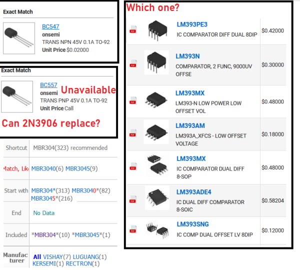

- Posts: 6581
I realize its early, just pointing out that gathering components can be a confusing for us novices. Perhaps another section can be added to the Forum under Photos and Other Topics for such things as this and (Bolt List, Cotter Pins, DIY Tools etc)Luke wrote: ↑Thu Dec 16, 2021 5:40 amFrank,
Having said that bear in mind this is quite early on in the prototyping phase, so the ultimate design could change - particularly given John E wants an output for the Nixie's he has fitted to his dash![]()
Luke.
Also, I was thinking of a display as well so one could set the voltage and a switch to see whats being input and output. NO Knob or on/off. Reason not everyone has equipment to measure what they did
Possible overkill: would an external box be an issue for judging starter cars (not for me). could the box be connected/disconnected have its own cut-out function and still work with an existing functioning cutout, solenoid or diode ?

Hello folks, I have just been told about this thread by a friend but have constructed similar John H design using the LM393 as a proto type and been playing with it on the bench using an SLA battery and power supply current limited it works very well but the MOSFET gets quite hot I think good heat sinking will be needed. Not tried this in the T yet but hope to soon. John
Luke
- First Name: Luke
- Last Name: P
John,
It's not clear which of John's designs you've used, but I don't see any bipolar transistors on your board? This suggests it could be an earlier iteration?
I've been using an LM311, direct out to the switching FET and have at various stages had that FET rather warmer than it should be. There are various possibilities as to why that could occur, but it may well be due to operating in the knee of the VGS curve, meaning somewhat higher RDS(on) than is desirable.
You could check this by looking at the gate voltage during switching with a multimeter, or preferably a 'scope that'd also give you an idea of how well it's switching. If the gate voltage is too low for the FET you're using you could end up with a similar issue to what you describe - or if it's taking off for some reason.
The bipolars that John later added assist with switching the FET, it may be that you could check out his last circuit and update yours to accommodate them (and the caps etc) - it could well address the problem for you. If you do this and it fixes it please let us know; the FET should run fairly cool (that is assuming the unit is operating properly and the FET's rated RDS(on) is low).
Aside from that I've just removed a TL494 from an old PC PSU and intend to trial that as an input to my existing FET/schotty pair. I'd always thought it could make a good inexpensive regulator for the T, so while we're going through this design/trialling process I figured I'd give it a go. Time will tell if it proves to be of any use.
Luke.

John, just to avoid any confusion, the circuit I'm using in the car is this one https://www.cool386.com/ford_regulator/ ... al_cct.jpg
I have probably run the circuit in the car for about an hour now, and so far it's doing everything I hoped.
The earlier circuits and development are described in the rest of the article https://www.cool386.com/ford_regulator/ ... lator.html
None of the earlier circuits are recommended, but are shown merely to illustrate the stages of development.
I haven't had any problem with the MOSFET running hot, (I was using the same size heatsink as you have during development) and it would suggest one of the issues that Luke had mentioned.
We will be very interested to know of the performance of your unit once you sort out the overheating problem.

As we're still going through an early design stage I thought it would be worth trying an IC I've had an eye on for some time. This is the TL494 that's present in many PC power supplies around the world, and is intended to work as a switch mode PWM (pulse width modulation) control chip.
I tend to use old PSU's for various bits 'n pieces, they often have handy heatsinks, nice hookup wire, useful capacitors and high-current Schottky diodes amongst other things. I've been using one of the Schottky's in my regulator testing here, and given there was a 494 on the same board I got the Schottky from I thought I might as well grab that as well and see if it could be persuaded to work as a suitable regulator for the T, similar to how JohnH's circuit works (but with one or two differences - more on that in a later post).
In looking at the data sheet for this IC it seemed to me that one could get a regulator operational with a minimal component count, and that it should produce a suitable (settable frequency) PWM output for feeding the shunt MOSFET. Additionally there are two transistor outputs, each capable of sinking ~500mA, meaning it should be possible to avoid the need for a driver stage.
So, I've taken the recycled IC and derived an operating circuit for it. In testing on the bench here the pulse width is nicely changing as the sense voltage changes within a band set by a capacitor. Below that band the output simply stops, above that the pulse width is around 85%.
While I've been initially trialling this at 12V the IC appeared to operate somewhat below it's rated 7V minimum. While one shouldn't necessarily rely on it this could be useful because it means we may be able to use it as is without any need to raise its supply voltage.
My reasoning here is that with the schottky in cct (let's say 0.3V drop), the generator voltage would be around 7.1-7.2V, assuming a desired (6V) battery float voltage of 6.8V. If we then supplied the regulator from the generator, using another Schottky and capacitor, this might be sufficient for it to run happily. To some extent much below that doesn't matter as we don't need to regulate at that point, and from what I see at this stage it just completely stops below a certain supply voltage anyway.
Obviously this is not an issue for 8V and 12V regulation, and I'll need to do some more investigation, but at this point it looks promising - possibly for all voltages.
Luke.

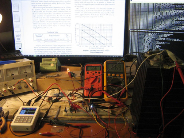

TL494 experimental cct
For those interested in the TL494 I've been working with here are some pics of it in operation, and a rudimentary circuit diagram.
Reasons for trialling this IC include that it is readily obtainable, inexpensive, and it contains everything we need to accurately regulate the generator output - including a voltage reference, PWM control (with included oscillator), two error amps, two output transistors settable for single-ended or push-pull, and it appears to (specifically) lockout on undervoltage.
Where it's at presently is that I've made up a breadboard circuit and have been experimenting with different configurations of it switching the gate input of an IRF3205 in shunt across the output of a bench PSU, via a 50W bulb. At this stage I'm pleased with the way it appears to operate, it regulates well within a 100-150mV range and it's stable in operation. Moreover it neatly drops out completely if the input voltage falls below about 6.2V.
The latter is important for 6V operation because it means we should be able to run it directly from the generator without the need for incorporating any boost. On the downside it means (as I see it) that it's probably not ok to utilise simple push-pull because (without a gate to ground resistor) it leaves the gate in an indeterminate state. As a result I've just paralleled the transistors in an emitter-follower configuration, feeding the IRF3205 with a 390 ohm to ground, so that when the 494 switches off so does the MOSFET.
Once the voltage from the generator (bench supply) rises sufficiently the 494 starts operating again, and if the level rises further to the set voltage it begins to modulate the output transistors nicely, effectively [shunt] regulating the output to the battery.
I need to reiterate that this is an experimental design, I show it here for interest and in case any technical type would like to assist by trialling it themselves, but it's really not ready for prime time yet as there may be significant mistakes or issues yet uncovered! Certainly it needs to be tested on a car before going much further.
The two photos show firstly a trace from the 494 output to the 3205 gate while it's regulating, and secondly the (rather messy) setup on the bench. To the left is the PSU, the breadboard is in the middle (with both JohnH's comparator and this PWM circuit installed), and to the right is a 6V battery made up of a couple of large LifePO4 cells. The meters are showing battery and [regulated] 'generator' voltage.
In another post I'll go over some operational differences between this and JohnH's regulator.
Luke.
Luke.

Luke, the TL494 looks interesting with a reduced component count thanks for posting your experimental concept here. I will breadboard one up and have a play. John
John,
It'd be good to hear how you get on with it.
FYI the above diagram was a slight update to some rough sketching I was doing as I worked on the concept, I've updated it again since then and now have the two comparators in parallel (IOW tie pins 1 and 16, and 2 and 15 together), and pin 3 to ground via a 10uf cap.
The comparator change didn't really alter anything, but changes to how pin three (FB/comp) is utilised does appear to affect stability, particularly around the low voltage threshold of the circuit as a whole - which is why I'd tied it to pin 2 at one stage. At this point I've tentatively come to the conclusion that it doesn't matter all that much, and that somewhere between a 10uf-47uf cap to ground at that point is perhaps preferable.
Luke.
Luke.

- Last Name: P
It's probably time to go over any significant differences between the comparator circuit that JohnH has designed, and the PWM circuit that Mike K and I have come up with (you will see Mike's version using a SG3524 several posts above).
John describes his theory of operation well on his website so there's no need to go over that in detail here, however from an operational perspective there are some things to note. Simplistically this design compares the input voltage from the generator to a standard (let's say 7V), if the voltage is above the standard it switches on the MOSFET, shunting the generator output to zero, if the voltage is below the standard it switches the MOSFET off. The addition of a resistor effectively delays the switching so that in operation what you'll see is the ammeter cycling between charge and no charge, the timing of which may vary somewhat. For various reasons the delay is needed, but the net effect is to ensure the battery isn't overcharged.
Electrically this is fine, in fact there is literature suggesting that pulse charging of batteries is beneficial, however it may be disconcerting to people used to smooth movement of their ammeter pointer.
The PWM (pulse-width-modulation) method also shunts the generator output to ground when the voltage rises to a certain level, but it does so very quickly (more than 1000X a second). As the meter needle can't keep up with switching at this rate (and nor could we see it) the practical outcome is that any movement becomes apparently smooth, particularly as the effective width of the pulse (or percentage on vs off time) infinitely varies as needed.
Again there is no issue electrically. In terms of circuit operation the added complexity of modulating the MOSFET is nicely handled by the IC in use, which also provides a stable reference standard to compare the generator voltage against. The end result of this is that there should be no more main components needed than in John's design, albeit there are more pins on the IC.
Cost-wise (in lots of 10) a LM393 comparator (JohnH) is around 7c each, a TL494 PWM control IC (Luke) is ~10c each, and a SG3524 PWM control IC (Mike) is about 15c, so there's essentially no difference there. Neither is the board design or component requirements between the different designs likely to contribute to cost differential in any meaningful way.
However if you were building a regulator from scratch at home it'd be advantageous to select a design that has minimal components or soldering required. At present as these designs are being developed it's probably a bit early to tell which of them will have the least number of components needed, but it's probably fair to say that for a 6V car the SG3524 will need a voltage doubler to supply it, whereas the LM393 doesn't, and the TL494 may not (yet to be determined on a vehicle). At 12V this issue goes away.
The ability to switch voltages (eg. 6V, 8V and 12V) should be similar between the designs, although in recent testing John has mentioned he's needed to additional components than what might have been originally considered. It's a bit early to tell whether this will ultimately be the case, but the PWM IC's should only require a change to the resistive divider, making them fairly straightforward to set.
There are other more subtle differences between the three designs discussed here, but this should cover the significant practical things that most people would notice. I should say that I write this for educative purposes, it's not intended to recommend any one design over another, although at some point if a PCB is going to be designed we should probably settle on just one.
Please chime in with any comments, especially as I have a feeling I've overlooked something!
Luke.

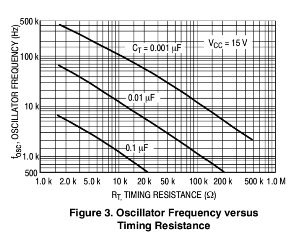

And one more thing - for anyone wanting to try the TL494 design, here's an updated diagram showing how I'm using it on the bench at present:
Note that the resistor divider values (R1/R2) are simply what I had to hand and presently suit a 6V operation, in practice the pot (VR1) could be done away with, thus reducing the component count, however I find it handy at the moment.
The high-current Schottky (D2) is also what I had to hand (removed from an old PC PSU) but should be replaced with something more appropriate if you were buying a new component. Unfortunately I've got no low-current Schottky's (D1) so haven't actually trialled this, but I'd expect a 1N5819 to be fine in this position, and they are a reasonably common device - however, as with almost all the components here it's not critical to use exactly that part.
Likewise C3 and R3, which will set the PWM frequency could be anything you have available, within reason. Ideally I think you should keep the frequency between 1kHZ to 10kHZ if possible, here is the chart from the data sheet showing how to attain this:
Below are some images of a laid out PCB for the TL494 regulator design.
I've put them up here out of interest and to show the concept only. Although it is a 'proper' board and would work the circuit design is still far from complete and there's lots to talk about with regard to fitting etc - let alone which design we should go with in the first instance. Anyway you'll see the idea is to fit the regulator within a board that itself will fit into an existing cutout container. While the MOSFET is shown as sitting up it could be soldered on the other side of the board and folded back to screw to the cutout base as a heatsink. The output Schottky would sit alongside and be connected with a short wire - any comments?
Another thing that would be good to know from you is whether you use 8V in your vehicle? It's unclear how much this is actually used now, and if we didn't need to accommodate that as a 'switchable' option on the board it could simplify things somewhat. It's not that any of the designs can't do it, more about whether we need to...
Luke.
Luke.
- Posts: 5254
I may be one of the few to still run 8V. A good percentage in our chapter do also. Its a way better option than 12V. This has not been an issue. I have been using heavy duty nos units from the 30's & 40's. rated 6-8V.
I think, if you could put a switch in, you would have a "universal" product. One to work 6V, 8V, or 12V.
Would this be cost or space prohibitive?
So far all is working well with the comparator regulator. I've taken it on several short trips and I'm already beginning to take it for granted - it just works as it should.
If anyone wants to watch an ammeter cycle for a few mins while the car is being driven, the video is here https://www.youtube.com/watch?v=IeY3cy69zpQ
Also tested it on a hot (30C) day to see if there's any over temperature problems https://www.youtube.com/watch?v=i_J3RJO5nUA&t=2s
8V and 12V versions have been bench tested with a simulated generator and work well. Two resistors need changing from the 6V design to operate at 8V, and four resistors for 12V, although two of those don't need changing, if a slightly higher standby current is acceptable. The one basic design can be configured for the required voltage using DIP switches, and this will be further investigated once a design has been settled on.
I'm now experimenting with Luke's TL494 circuit with a couple of minor modifications. On the bench it works well also - so next thing is to build up a version for in car testing.
Luke,
Board your layout looks promising as you say the MOSFET and D2 could be mounted on the original can base. I have an assortment of different scrap cutouts one being an original Ford the other 3 I think are reproductions but the lower area inside lip of all (see photo) is around 47.3mm so that would be the diameter board limit. Most have a central screw or rivet holding the original relay in place maybe a suitable standoff here centrally could hold the board. One other Idea is to use SMD IC for the TL494 which will reduce component space on the board. These are just ideas I am putting out there for consideration. Regards John
John,

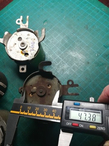

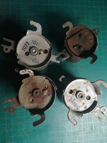

Thanks for posting those photographs. Your experience mirrors mine in that no two seem to be the same, other than the can diameter.
I'd hoped there'd be some common features that'd make mounting a regulator easy, but there doesn't seem to be. I've got three here now (thanks to Chris D for the two I got yesterday) and, as with yours, at least one doesn't have a central hole. So there'll likely be some drilling required whatever we do.
Agree re SMD components, however it'd probably make it more difficult for anyone wanting to make their own regulator at home, or alter component values. No reason why we could produce designs for two different boards mind you.
FYI the concept board I put up has a diameter just on 40mm, so there's a reasonable amount of additional space available if one expanded that a little.
I was amused to read your post 'cos when I measured the cutouts here I did so in mm as well. However I then converted that to fractional inches, wondering what they'd actually been designed to back in the day, and decided it was probably 2". I was puzzled with your measurements 'cos I came up with 1 55/64" (which wouldn't have been a thing, surely?!), but then realised you'd measured the base I.D., mine had been O.D.
BTW, JohnH has been doing some work with the 494 design, from his bench testing if you're building it up it may work a little better changing the 10uf to say 33uf or 47uf, and the 100uf to 470uf - but it's yet to be trialled in practice.
Luke.
Luke.

Somewhat coincidentally, I'm working on this very aspect of the TL494 circuit right now. It seems more critical than the LM393, with regards to the quality of its power supply, and notes in the data do pertain to this. I had hoped to start building up the prototype for in car testing this afternoon, but have hit a stumbling block with the idea of powering it off the generator, so as to eliminate a battery disconnect switch. The decoupling components for spike suppression have affected the stability and regulation. Unlike the LM393, the TL494 draws too much current to leave permanently connected to the battery, so have to find a way around this, or revert to a battery switch.
The LM393 circuit continues to work well in the car, but in terms of a single design which is adaptable between three voltages, it will need more DIP switches or resistor changes than the TL494 circuit.

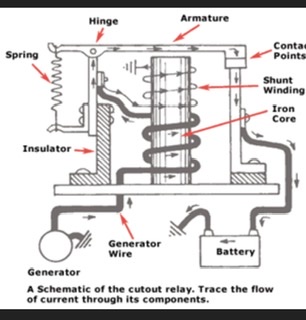

Here's a simpleton's question.
I've never looked inside a cutout.
What was in there and how did it work?
Ah! I have found the answer - from Ron Patterson so it must be correct:
http://www.mtfca.com/discus/messages/82 ... 1533484078

Thanks to those that replied regarding 8V operation, and to Robert for input on Rdiv's.
You'll recall an earlier discussion around how these regulators typically work - comparing the measured voltage against a reference standard, and changing output characteristics accordingly, depending upon whether the measured voltage is above or below the standard.
It's fairly common to use 5V as a reference value, in this case applied to one input pin on a comparator. This means that the target voltage also needs to be measured and divided via a resistor chain down to 5V and applied to another input pin so it (the comparator) can compare the two and determine its output, and ultimately what the regulator needs to do.
Each target voltage (6, 8, 12V) requires a change to the divider so that the chain will output 5V. In order to make this sort of regulator multivoltage it's necessary to find components that work well together, and provide an easy method of changing the voltage for the user.
This could be done in a number of ways such as using a dip switch, just install the necessary resistor(s), utilising a jumper lead etc. However it seems the easiest idea might be to fit all the required resistors on the PCB, and simply cut a track appropriate to the required voltage.
Below is a cct diagram showing what I mean by this, the values shown take into account the voltage drops across the two Schottky diodes (in the TL494 cct) and are designed to have the regulator supply the battery with circa 7.1, 9.1 and 14.1 V. As you'll see it uses common resistor values.
While this is shown for the TL494 cct it will also work happily with John's LM393 circuit if the reference voltage is adjusted appropriately, or alternatively a different set of resistors is used in a similar configuration.
Any comments?
Luke.

TonyB
- Posts: 663
- First Name: Tony
- Last Name: Bowker
- Location: La Mesa, CA
Luke, that’s a good technique which works well. Cheap folks like me will just omit the two resistors but it’s good they are there on the PCB.
When I had the electrical spike problem I use little coil, a small capacitor and a series resistor on each line. When it blew the second time, one of the little coils had gone open circuit. When I spoke to Mike about my problem at Hershey, he smiled and acknowledged the solution was not easy.
This design only has one important line connected to the generator so the solution might be easier than my lighting which had five “antennas” and a power connection. From memory the line that blew was from the brake light switch.
I suspect the existing shunt design could be assembled on a board with holes on a 0.1” grid.

John Housego
- Posts: 30
- Joined: Wed Jan 16, 2019 4:44 pm
- Last Name: Housego
- * REQUIRED* Type and Year of Model Ts owned: 1925 Tourer
- Location: Aylesbury Bucks UK
Luke, your cutting of print would be a good solution however rather than having 2 extra resistors on the board doing nothing I personally would prefer selecting a single value for either 6v, 8v or 12v and just fitting that. Regards John

Thanks John, will bear that in mind.John Housego wrote: ↑Fri Dec 24, 2021 5:57 amLuke, your cutting of print would be a good solution however rather than having 2 extra resistors on the board doing nothing I personally would prefer selecting a single value for either 6v, 8v or 12v and just fitting that. Regards John
The cutting track thing is suggested as something that's easy for the 'average' owner to do, should they get a built-up board, but if you were making your own there's no need to add the extra resistors of course. Anyway we'll see how many responses we get before coming to a conclusion on that.
I think JohnH may have tamed the 494 and will be testing it in his T over the next short while, but in the interim a hot Sydney beach is beckoning...
Luke.

Earlier in this thread some of you indicated an interest in a field regulator.
Below is a possible circuit using the TL494. I do stress the 'possible' as I've not actually trialled it, and cannot (at least on a generator), however it should PW switch current to the field coils, inversely according to generator output voltage. The resistor divider values are set for 6V operation, but could be altered to suit whatever.
I expect that JohnH's comparator circuit should be similarly adaptable, it would be good to hear if anyone tries either out.
Although not shown a normal cutout is still required.
Luke.
Luke.
JohnH
- Posts: 377
- Last Name: Hunter
The TL494 circuit is going to need more development. I built up a prototype which worked well on the bench, but not in the car. The higher switching frequency, combined with the generator inductance could be part of the problem. It is suffering from a low frequency oscillation. Also, some ignition interference is evident. Next thing is to try to simulate the peculiarities of in car operation more closely on the bench. The comparator regulator is still working well, and if anyone wants to build one up I think it's ready for others to try.
