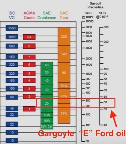

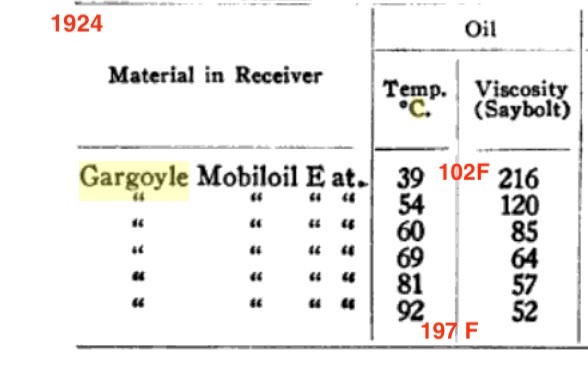

Always fun to discuss oil for T engine (and transmission)
For modern use a 20w would be what Ford owners used back in the day, from looking at mat'l specs from Ford. Viscosity is maybe a good indicator.
All around weather conditions prevail, for me in FL the summer tours are warm, in fact all next week our weather is in the mid-80's! Fun.
So here are some comparisons, 20w is likely the proper in warm weather, but running 30w is satisfactory too.
Now, just need to run over to the WallyMart and get a jug of Gargoyle to be in spec!

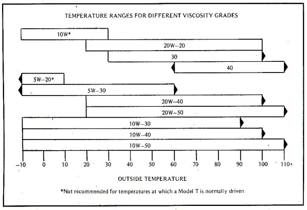

According to Steve Jelf's chart, 10W30 covers the temperatures. In which we usually drive the T. Perhaps 10W40 in very hot weather.
