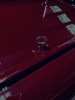

Has anyone ever put a handle on the Deck Lid of their Coup to make it easier to lift .. trying to think of something that wont look out of place on my '25 work in progress.

Yes that’s what I do also. I have a 24 Coupe which I turn the key and lift the lid. It has a wood frame and just a little snug but that’s the way I do it.

My lid locks every time it is closed so I have to use the key to open it anyway so…….
Maybe you could install small gas filled struts inside so that once opened the lid would pop up automatically.
Not my cup of tea but it is your car.

The 1926-27 coupes are the same way but the deck lid is a lot heavier. You have use the deck lock key to pull the deck lid up just enough to get your hand under the lid and then lift it up the rest of the way to set the deck lid stay up bracket. I wonder how many 26-27 coupe owners over the years have been swallowed by their deck lid.

I've considered using a strut like is on a modern SUV that would allow the lid to be held up and would need to be pushed down to close. One strut would do it.
- Posts: 8633
Re: Coup Deck lid Handle ?
If you don't mind modifying the car, the strut idea would be excellent on the later cars. I'd suggest two struts to avoid any strain on the lid and hinges while preventing any tendency of the lid to rattle. A less intrusive option would be to carry one of those suction cup dent pullers. Something along the lines of a spring at each lower corner of the lid could also work.
