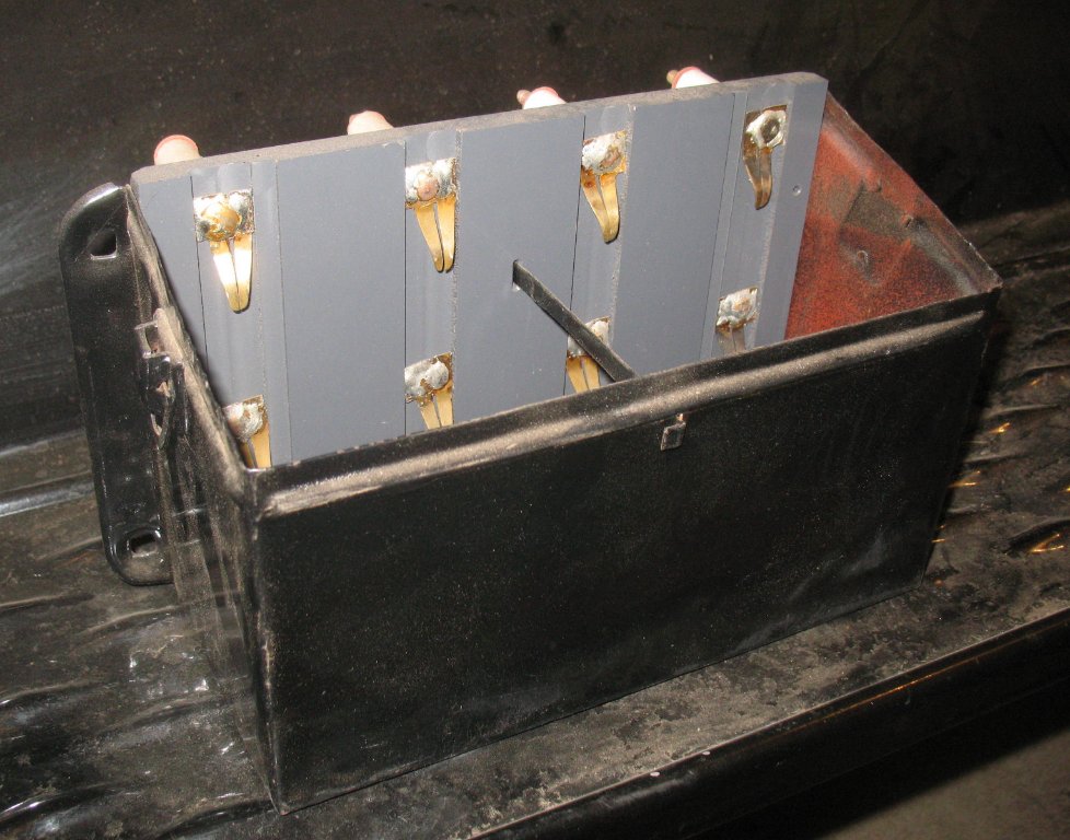

I just wanted to give an update on how I fixed the problem with my friend's 17 that was missing on the back cylinder. This may help someone else in a pinch, I don't know. I had checked the coils, replaced the wires to the timer and the plug wire, took the coil box out and cleaned all the contacts but in spite of everything it still wasn't getting fire on the back cylinder and I just knew that somehow the problem was in the coil box. Last night I finally had a stroke of genius, all I needed was a piece of inner tube and some heat shrink tube. This morning I removed the two contacts from the coil box that correspond with the rear cylinder. I cut inner tube to go between the brass contacts and the back board of the coil box. The bolts were sheathed in shrink tube and then everything was reassembled. The problem is gone. I still don't understand how enough voltage was lost between the coil and the end of the porcelain insulator to cause a misfire but this is a cheap and simple repair that works. Maybe it will help someone.

sounds like you insulated things from carbon tracks. Don't underestimate path of least resistance...under compression, the spark jump at the plug may well be of greater resistance than the carbon track and it sounds like it was.
The final fix is a rebuilt coil box, but your fix should last until the next carbon track somewhere else does you in.
good for you for finding it and even more, for telling the forum of your findings.
- Posts: 7411
Re: Advise needed on ignition problem
The bolts were sheathed in shrink tube...
I gather the coil box still has its old wooden back panel. Especially if it has gotten wet at some time, you can have carbon tracking that grounds a circuit. I expect the shrink tube is insulating the bolt from a carbon track in the wood. This is why I always install John Regan's FP kit in a coil box.
