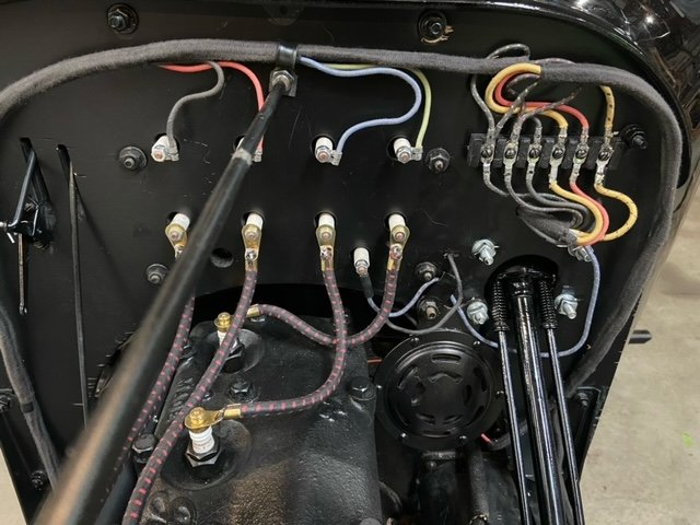

I have to think a bit about the clips as this one has a second harness set that rests aside the standard loom. (Made up a tar covered cloth loom for left/right/tail/brake/4way) with the terminal block on the sill by brake lever) . I’ll prob mount the main standard loom as you did…and only then figure out how to clip or surgeon knot with cord the fake loom to it.
Thanks again for taking the time to share. Here is where I left off.
