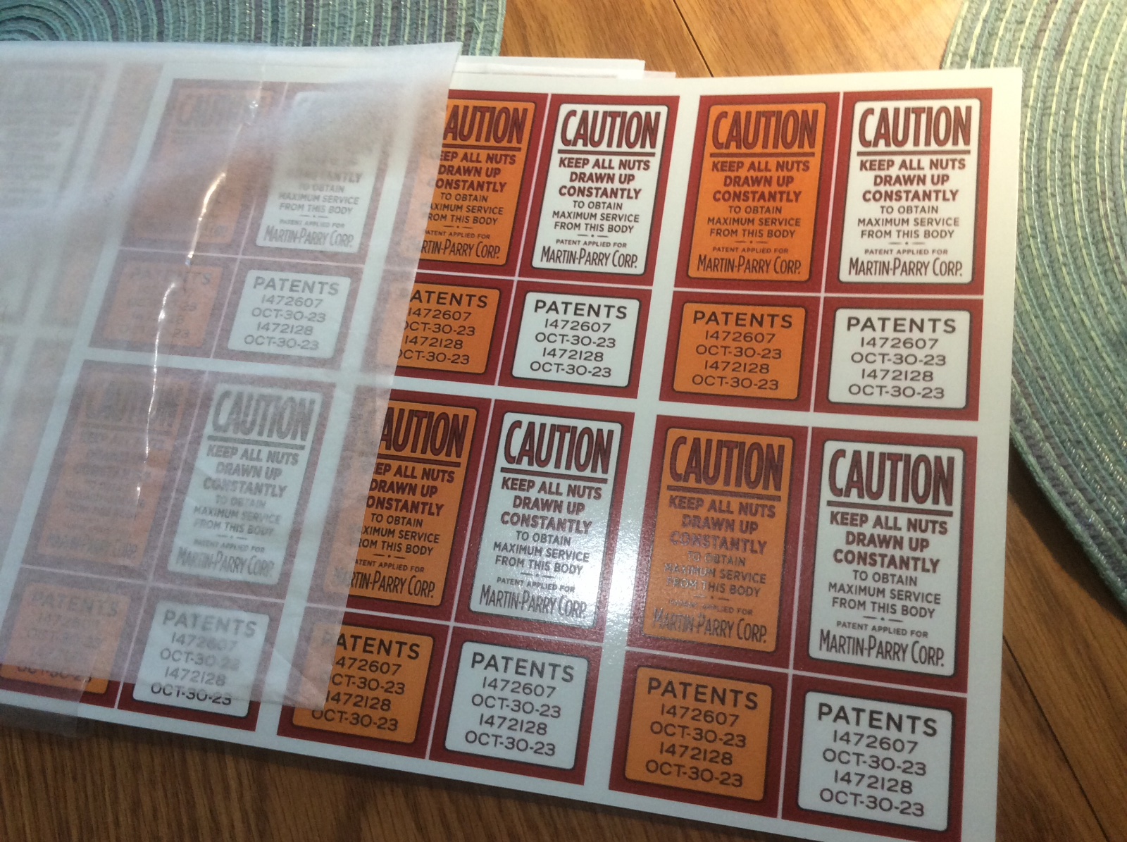

Thanks Bron, I had a small metal piece on the bottom of each sash, so never knew what it was until I saw your window. I will now install a web strap to pull up. Thanks to Steve Lang for sharing pics of the original, I have decals replicated that I would be glad to send you. They were placed on the header board in the cab, and reminded owners to tighten their nuts up every so often !

Yes - on the tighten your nuts notice. My address is
