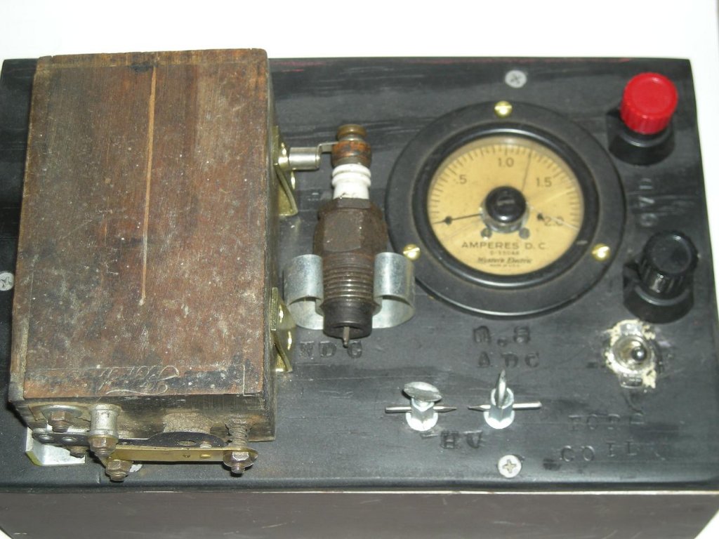

As a teen, I set new points by adjusting tension on the vibrator spring, and looked for a hot spark. The buzz sounds didn't seem important as long as the coil buzzed! So sight is what I used, and a high or low frequency buzz didn't matter.
Back in the day, if the owner read his "Ford Instruction Book' the message is there, "trouble probably lies in the spark coil and the car should be driven (good thing 3 of the coils still worked ;) ) to a Ford dealer who has special equipment for testing and adjusting units...."
Or they could just get this gizmo and have a sparking good time adjusting coils! Think it worked the same way as adj. the tension, as that cylinder is a weight that is calibrated for that measure?
It was only later I got a set of coils that were adjusted on the HCCT. Then found that the '24 would really run, even idle down on 'Mag...... because until then I thought my magneto was putting out poorly, the car would run on mag, after starting on bat, but slowing down to low speeds would want to stall, so I would switch to 'Bat' for those times. All I did was get a set of properly adj. coils and my magneto instantly fixed itself :lol:
