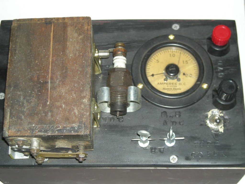

When I first got into Model T's, we adjusted the coils the same way as the first post. We looked for the highest, even pitch of the buzz and tried to match them all. The cars may not have run perfect, but they ran well. I have always been amazed how everyone has been convinced that we now need a $750 HCCT in order to set our coils.

As a teen, I set new points by adjusting tension on the vibrator spring, and looked for a hot spark. The buzz sounds didn't seem important as long as the coil buzzed! So sight is what I used, and a high or low frequency buzz didn't matter.
Back in the day, if the owner read his "Ford Instruction Book' the message is there, "trouble probably lies in the spark coil and the car should be driven (good thing 3 of the coils still worked
) to a Ford dealer who has special equipment for testing and adjusting units...."
Or they could just get this gizmo and have a sparking good time adjusting coils! Think it worked the same way as adj. the tension, as that cylinder is a weight that is calibrated for that measure?
It was only later I got a set of coils that were adjusted on the HCCT. Then found that the '24 would really run, even idle down on 'Mag...... because until then I thought my magneto was putting out poorly, the car would run on mag, after starting on bat, but slowing down to low speeds would want to stall, so I would switch to 'Bat' for those times. All I did was get a set of properly adj. coils and my magneto instantly fixed itself

I have never tried adjusting them that way, but I do use a buzz box and get 1.5 amp on each coil. First I hook up my tester to see if the capacitor holds a charge, then I adjust the point gap and then bend the back of the bridge until I get 1.5 amp with a good spark. I do this first on 6 volt and then connect my box to the magneto of an engine which is running on battery but has a good magneto. When I get 1.5 amp on the magneto and battery, I try the coil in the car and if it runs smoothly on both battery and magneto that coil is good.
I do realize that I might get a very small improvement on the coil tester. But I carry a couple spare coils and a spare timer and a few spark plugs with me and so far have not had to be on a trouble truck on tours. The engine is stock even the cylinder bore has been sleeved to standard. The head has been resurfaced only enough to make the surface flat. My car keeps right up with the others except for some with speed equipment on their engines.
