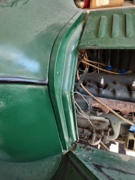

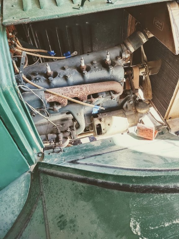

What we can see of it says 15-16 with a 19-25 engine & transmission.

Single valve door. I agree with Steve except early '22 through '25 engine and trans. The serial # would narrow that down.

Ah, yes. One picture shows the hole in the center.

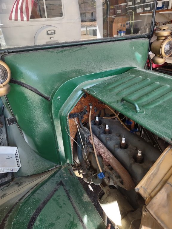

Yes the single valve door makes it 22 - 25 engine. Looks to me it has the later high head.
Did you get a title with the car? What does it say.
It does look like to me that it’s a 15-16 because of the hood former. Without seeing the rest of the car it may or may not have some later parts on it. Some parts would work and interchange but might be a little newer.

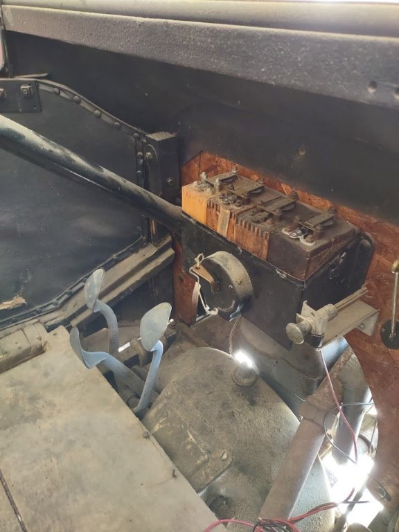

Here are the photos from the link. Pictures 1 and 3 show the firewall to made out of OSB (Oriented Strand Board).
