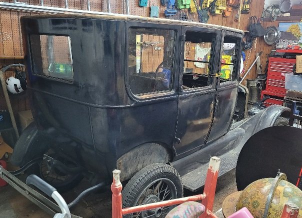

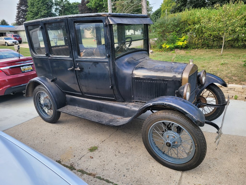

Here are a couple photos.
26 Fordor
26 Fordor
26 engine
26 engine

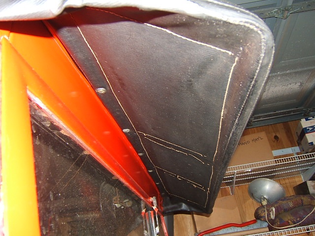

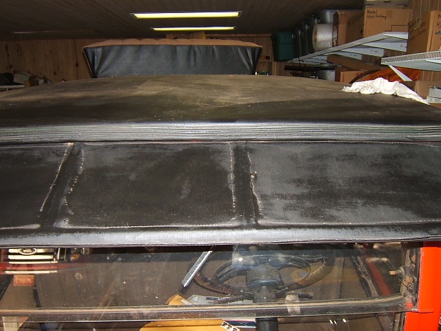

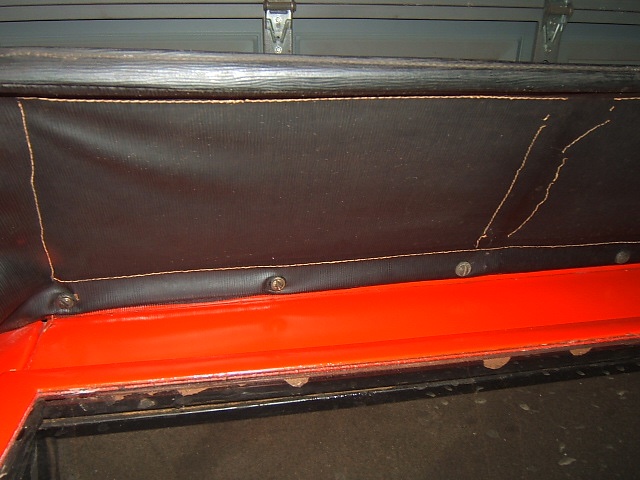

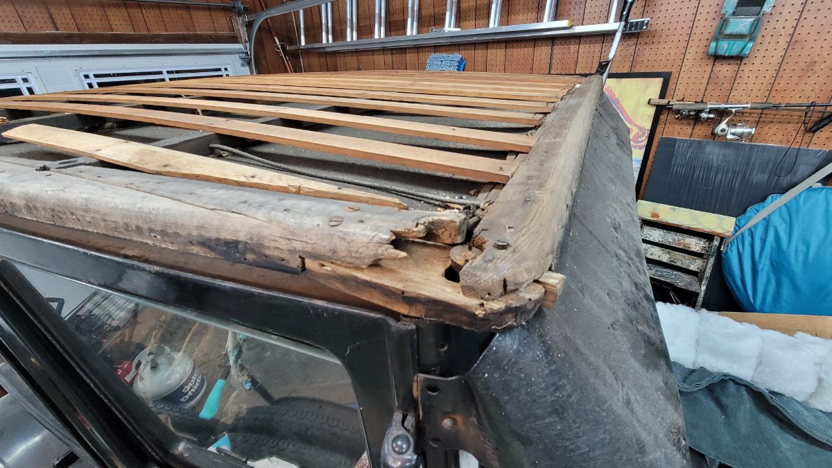

Forum member Don Booth won't be surprised but I was stunned by the extent of the rot evident on the top structure. This photo depicts the first step of the disassembly, removal of the old top covering.
Top deterioration.
Top deterioration.

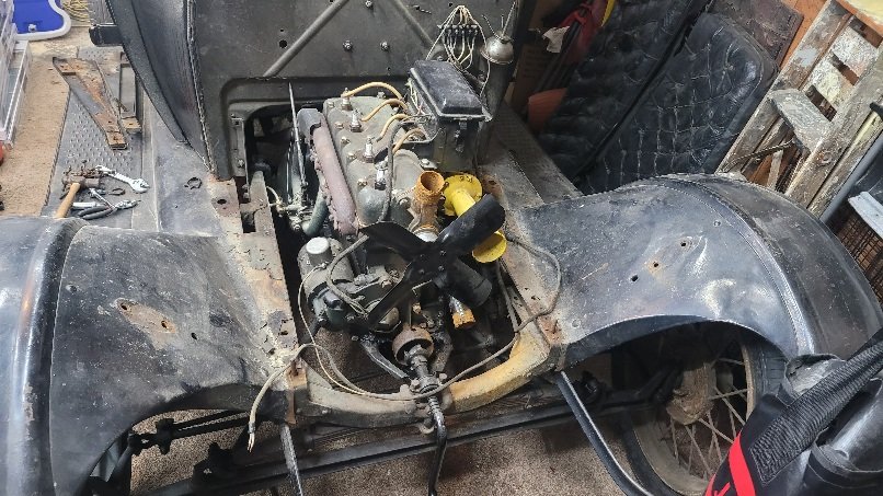

Some people over the years have asked me about the yellow horn. All I can say is dad liked the horn yellow as it matched the yellow of the wood wheels that were on the car for years. If I can find it I have a very old photo of the car as it looked when dad first brought it home. It was sitting on wire wheels that dad incorrectly thought were from a Model A, thus the change back to wires for the car. I'll be posting photos as we go along.

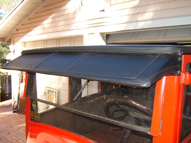

Tonight my tasks were to remove the headlamp assembly and get the visor off. The last time I restored a car I completed a series of seemingly minor jobs that when taken as a whole resulted in a lot of progress fast. That is the goal here. Tomorrow's task will be to remove the rear fenders.
Headlamps and visor gone.

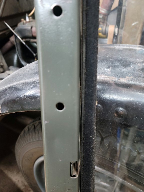

I got nothing done on the Fordor two nights ago but was able to pull one of my daughter's baby teeth, process that took over an hour. Last night I removed the passenger side front door. The top hinge pin was really stubborn but I attribute that to the structural damage of the body thus most of the weight of the door was carried by that hinge alone.
Why that door? First off that was the side easiest to access in the garage and secondly, that window has not worked in at least 50 years so I want to tear into the door to see if I can restore it to functional status.

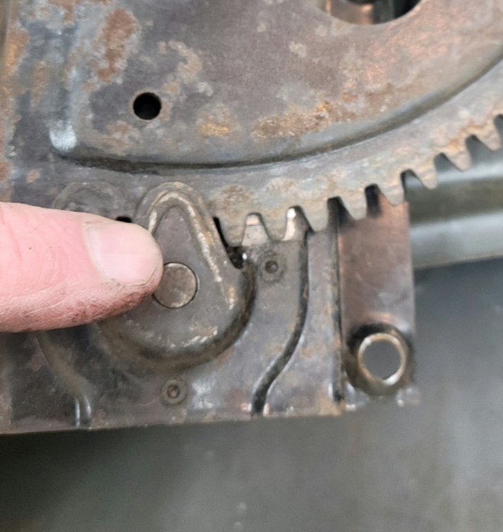

I got the innards of the door apart tonight. After 50 years I figured out what was wrong with the window mechanism. The part of the regulator where my finger is pointing allowed the gear to slip off and the crank no longer worked. A couple firm hits with my ball peen hammer and the mechanism works like new.
On another topic, one can clearly see this was a Budd built body.
Hammer placement
Hammer placement
Budd door
Budd door
Regulator 2
Regulator 2

When regulators "go off the track" as yours has, the cause is often that the car was left outside in inclement winter weather and snow and ice got inside the door and froze. Instead of waiting for warmer weather or moving the car to an above-freezing location, someone strongarms the window handle.

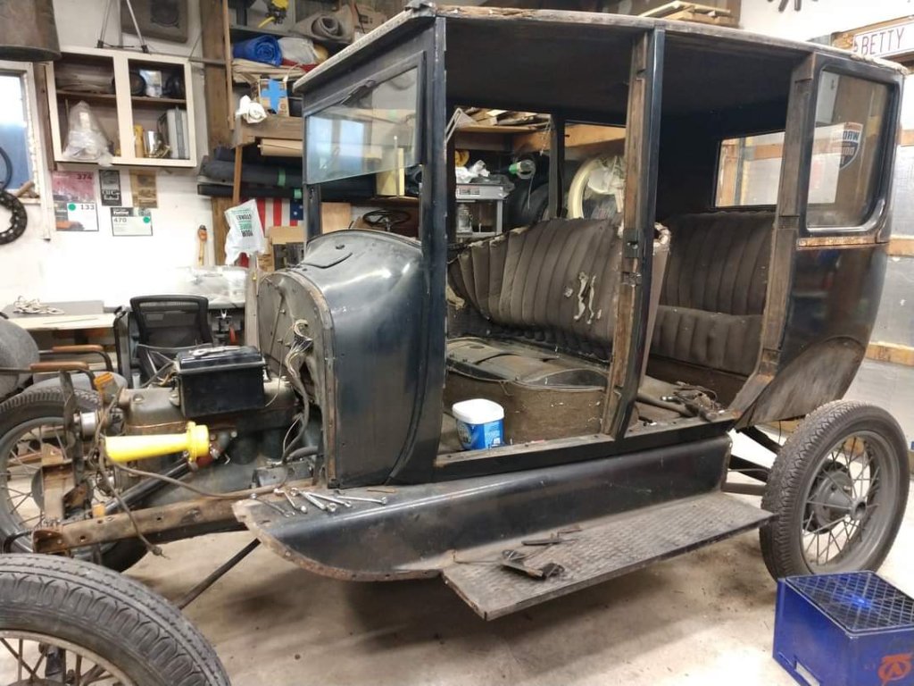

Post by EricMac » Fri Nov 25, 2022 11:19 pm
I finally was able to get my car to Don's place. I got a lot disassembled but he really tore into it.Here is the car today.
26 doors off.
26 doors off.

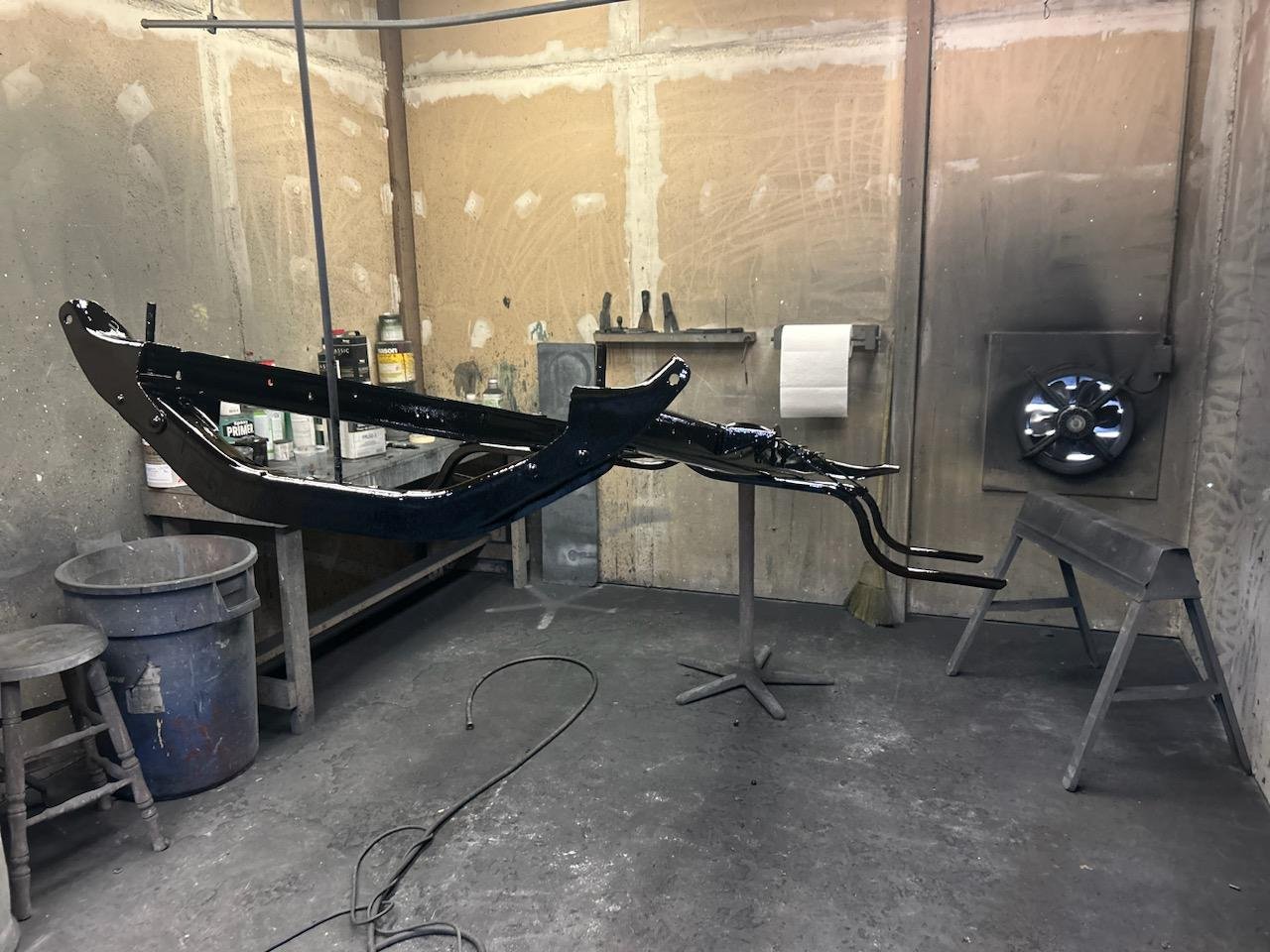

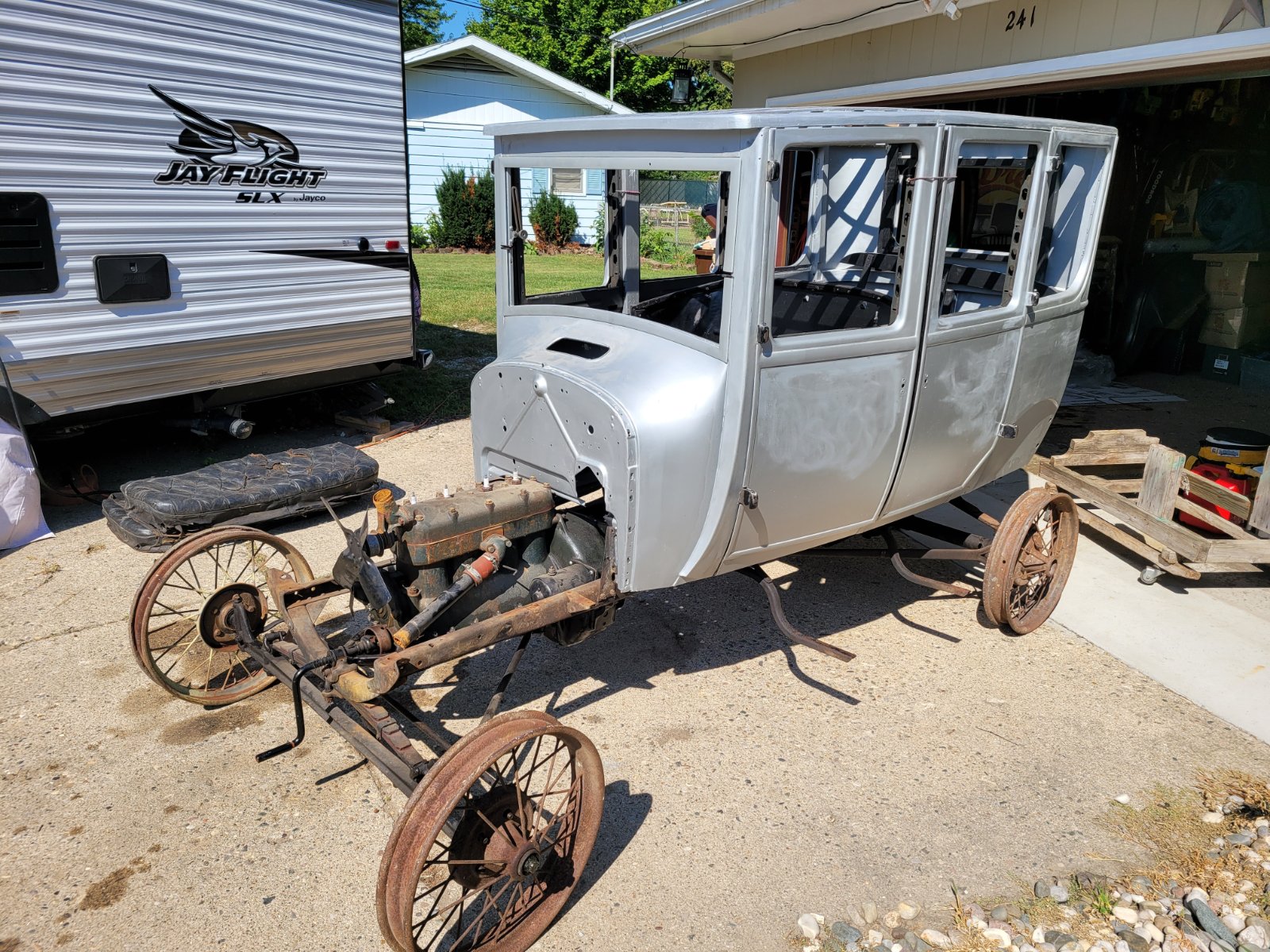

Post by EricMac » Sun Dec 17, 2023 7:30 pm
The project continues. While many of you would be well founded if you thought the project had been abandoned. It has not. Currently it is coming back the other way. Don Booth has completed the woodwork on the body and Mark Eyre painted the frame this week. The car is coming along nicely.
Frame
Frame
Bodywork done
Bodywork done
