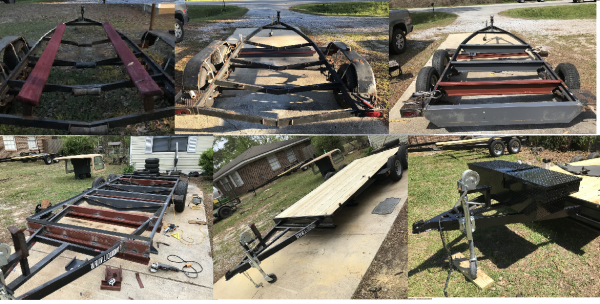

Requirements, Light, single axle, open.
Any ideas?
Im looking at using the frame from an old boat trailer with is 4 inch alumin i-beam. Welding the ibeam to angl but welcome some design ideas, the trailer will use brakes and be towed behind the lincoln.

lots of ideas on YouTube etc https://www.google.com/search?q=boat+tr ... cLWuGTyZAM
This looked simple and retained most of the trailer 's structure.

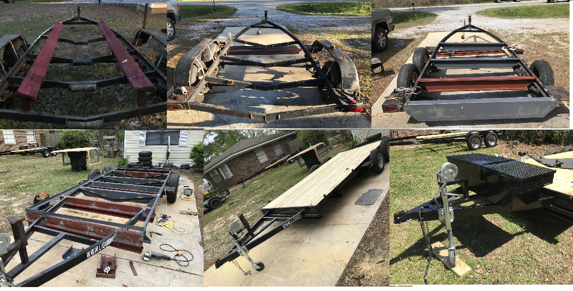

More what I was thinking

As an update I found an old aluminum boat trailer for $50 with a title no less! So some progress has been made.

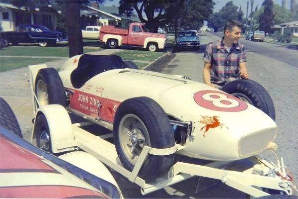

Since you'll only have 1 axle & two wheels, don't try for weight reduction and minimal design there! I have a lightweight trailer, like the one you pictured above, but the axle is from a trailer home and it uses 15", 12 ply rated, 120 psi, heavy equipment hauling tires. I've worn them out, but I've never had "tire trouble", (fingers crossed...).

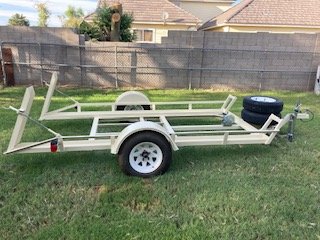

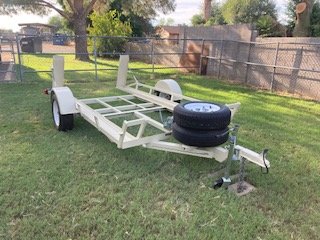

I lucked out and picked this one up from a club member. Has a torsion axle, is low & towes like a dream wich is much better than my 18' two axle dove tail. and its over a 1,000# lighter.
Craig.
