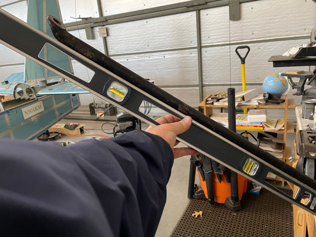

Should I straighten the radius rod now, or wait until I get the axle reinstalled and check caster? Twist in the axle has been corrected. 1924 Touring.

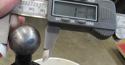

While the wishbone is disconnected, you might want to measure the ball, which should measure 1.25". I recently had a ball come out of the socket on my '26 pickup. The ball was worn to a little less than 1"- to the point that the ball slipped out of the APCO socket. Luckily, I found it before something drastic happened. I installed a new ball and a new FORD type cap.

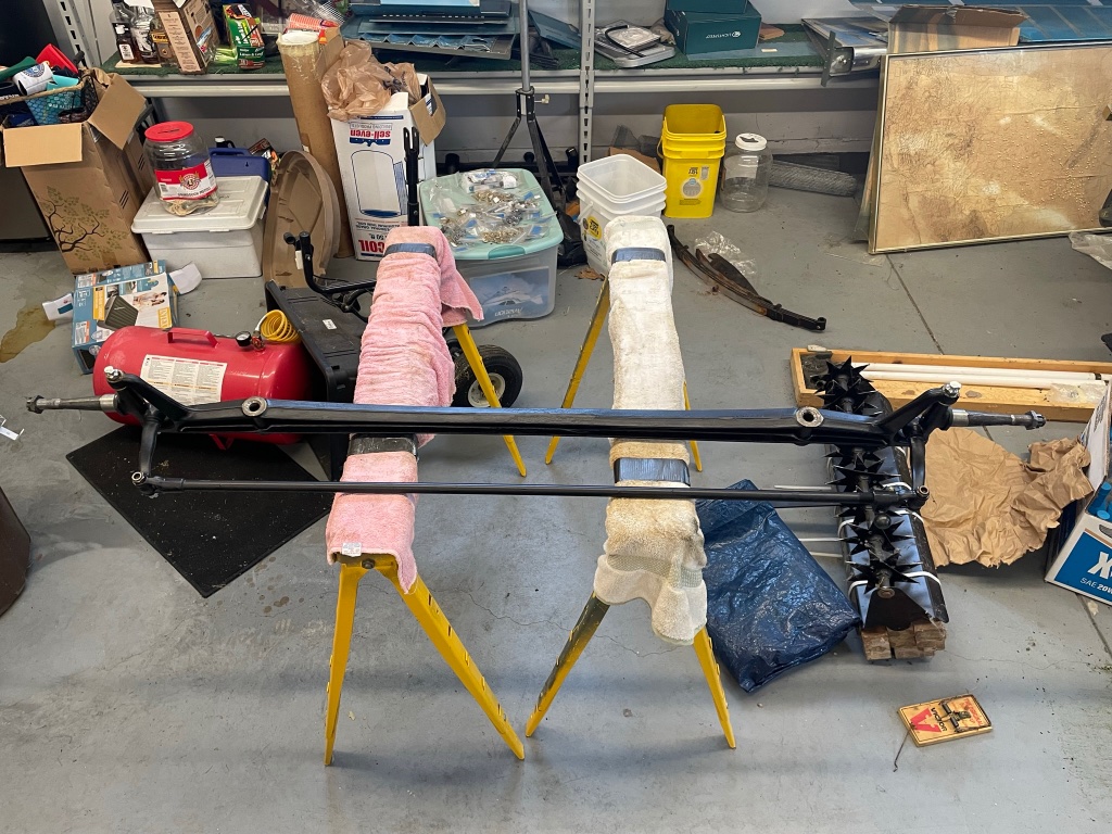

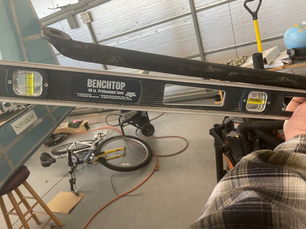

This is a complete axle rebuild. The axle has been straightened and machined for tapered upper spindle bushings. Spindle bolt threads checked good. Spindles have been rebushed (all three on both spindles) and fitted to the axle. New spindle bolts and tie rod bolts have been purchased. Spring main leaf and perches have been rebushed and new forged shackles have been purchased. All the old steel parts have been stripped, cleaned, and repainted. The radius rod is the last item to deal with. It has been laying under the car since I removed it and I’ve just noticed the bend as I was cleaning it up prior to paint. The bend appears to be about 1/2” to 3/4” starting about half way between the ball and the axle end on one side. I don’t have a means to straighten it but the guy who straightened the axle probably does.John kuehn wrote: ↑Sun Mar 06, 2022 8:53 pmYou probably know already but it goes without saying to replace ALL the bushings in the front end assembly. Also look closely at the tie rod yoke and ball. That is a important part that can get overlooked. I know because I did it!
