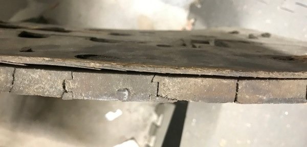

By John F. Regan on Saturday, December 26, 2009 - 01:31 pm:
Wooden fire walls were used through about February of 1923. The first metal firewalls appeared then and were of the "low" type but very soon replaced by the metal "high" type that was typical of 1924 and later. In early 1915 the wood firewall changed thickness from 3/4" to 11/16 but it didn't go away for a number of years and it was a source of constant issues of warping and swelling as Ford changed the method of making it from Horizontal core to Vertical core to laminated core with the veneers running horizontal and then a 3 ply design was used for a time. The final solution was the metal firewall but at first that had issues too with the steering column flopping around due to the lack of stiffness of the new metal dashes. That was solved by the addition of a bracket to tie the column to the dash panel. Then as now when designs change hopefully for the better to solve some issue - there are unforeseen pitfalls that then must be addressed.
This is how they were made, now plywood note a 3/4” sheet is actually 23/32” thick
- Attachments
- original.jpg (29.38 KiB) Viewed 2217 times
