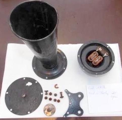

Haven't repaired a magneto horn before, but others have.
Took this photo off the web, and it shows the mag horn with its pieces apart.
That brass bolt perhaps is part of the piece that drives the diaphragm. Maybe the photo helps.
Mag horn apart.jpg (46.09 KiB) Viewed 2551 times

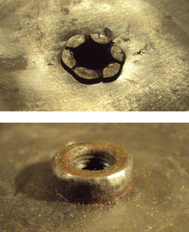

Post by Rich Eagle » Wed Jan 12, 2022 1:23 pm
This is what the my mag horn nut looks like. It crimps into the diaphragm. I don't have the screw and 1/4-28 won't go all the way through. It might be extra fine.

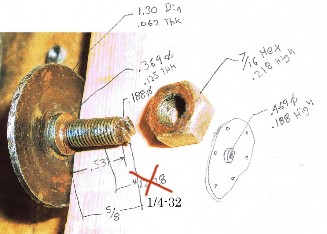

Post by Rich Eagle » Wed Jan 12, 2022 3:50 pm
I found the screw. 1/4-32. I was in error when I measured the thread. The OD was .240 and I mistook it for #12 and got the thread count wrong. I'm confident it is 1/4-32. I will inform Martynn Vowell.

The Vowell Art mag horn diagram shows 1/4-32 x 1 1/4 " long center bolt. app.php/gallery/image/2257
