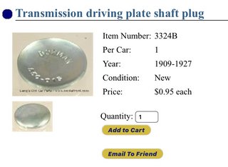

Another thing to check is the "plug" inside the transmission out-put shaft. Its a bit hard to describe, but there should be a "disc type freeze plug" inside the transmission just in front of the U-joint. If its not there, there will be a tremendous amount of engine oil running down the torque tube and ending up in the differential assembly. A lot of folks don't know about the plug, but it IS important!! Just one more thing to look for! Wight Kind Regards, Bill

Thanks for this info Bill, that’s the next think I’ll check. Is it accessible through the transmission cover?67pontiac wrote: ↑Fri Mar 11, 2022 8:37 pmAnother thing to check is the "plug" inside the transmission out-put shaft. Its a bit hard to describe, but there should be a "disc type freeze plug" inside the transmission just in front of the U-joint. If its not there, there will be a tremendous amount of engine oil running down the torque tube and ending up in the differential assembly. A lot of folks don't know about the plug, but it IS important!! Just one more thing to look for! Wight Kind Regards, Bill

I think the only way you can check it is by removing the rear axle. This is not difficult. You just need to raise the car high enough to slide it out and have the frame well supported while you do it.

Thank you David, Norm, and Michael. Since my last post I’ve perused my copy of the MTFCA’s “THE MODEL T FORD TRANSMISSION” and found where the plug goes. I can see why the drive shaft would have to be dropped to check for the presence or absence of the plug. If it’s missing it looks like the transmission would have to come apart to install it.

So if you do find that oil is leaking out through the tail shaft and you don’t have a wallowed out 4th main a simple fix so you don’t have to pull the engine, though that’s probably the best solution. First if it is your forth main being bad, measure the OD of the shaft and contact Gene French and he will machine you a repoured 4th main to replace it for a very low cost. I say that because the simple fix will require you to loosen the rear axle to remove the drive shaft/ universal anyway and while your there you can replace the 4th if needed. The advice on filling the universal with grease is right on target too. That said, the simple solution is to drive an over size rubber plug into the tail shaft deep enough that it doesn’t interfere with the depth the universal needs to go inside the tail shaft. The rubber plug needs to be driven in so that it conforms to the walls of the shaft tightly. I’ve seen this done with a friends motor he rebuilt and forgot to put the metal plug in the tail shaft. That’s been years ago and it stopped the oil flow into the rear axle. It’s still working. Sure beat pulling the engine and taking the tranny out to put the metal plug in. Just a suggestion from a shade tree fix, remember the rubber plug must be oversized and forced in with a big flat rod or punch and a BFH. The rod / punch needs to be large enough that it covers most of the opening but not so big that it can get jammed in the square hole as you drive the plug in but not so small that you could punch through the plug. You can find the rubber plugs at Lowes. Your mileage my vary. Good luck.
