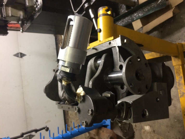

UPDATED: Through an old timer at my engine parts supplier - New England Engine, I've found out which Onan engine used these bearings. They are 1" wide and available in 1.626" std. size and -.010" and -.020" under. As you can see in the photos, three sets of these bearings are used for the rear main and the center and front main use two sets spaced apart and that space is used for the oil groove.
The thrust surfaces on the rear main are machined out of 660 bearing bronze and attached with machine screws.
Photos by Fred Hoss in the Vintage Ford Volume 23 Number 5
